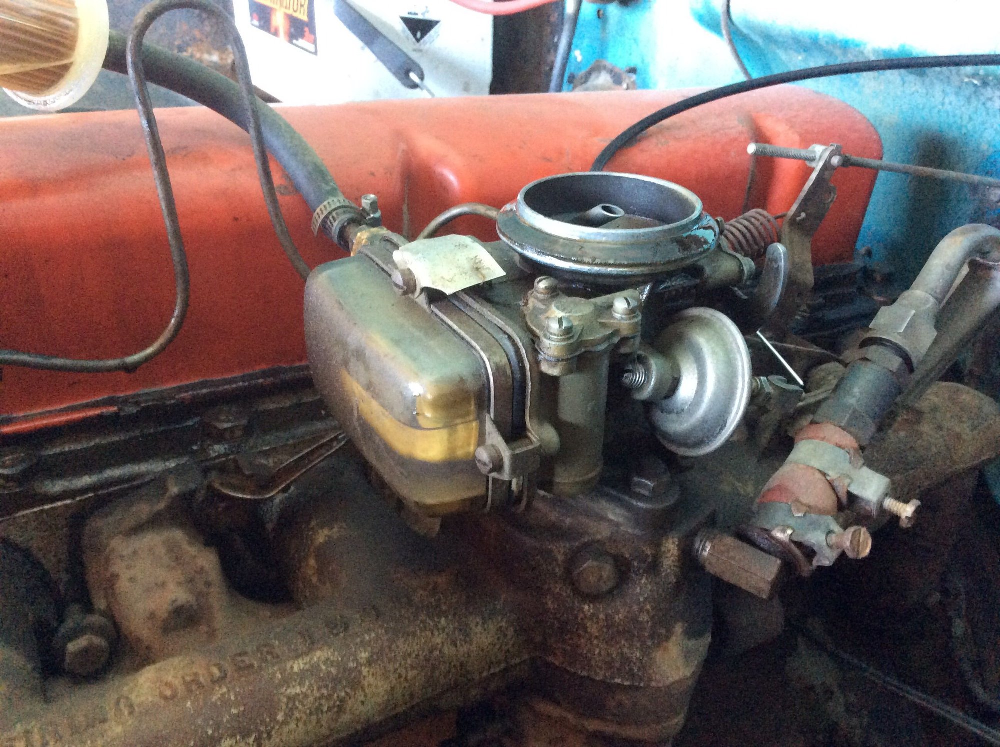

I very much appreciate your input. I'll keep thinking it over . The carberator butterfly valve is seized on the 262, another peice of the puzzle. I'll look into it's differences from my single barrel 223 while I also look into the work involved of putting in a third generation six cylinder (240,300).
My 223 carberator
My 223 carberator

I think your 223 is likely front and rear engine mounts, but could be wrong on that account. If you want to use the same mounting system with a 240/300 then I believe you'd want to find one from a 1965 F100 or F250 4x4 or 1966 F250 4x4 or 65-66 F350. Otherwise if you use a newer 300 or 2WD donor with side mounts then you'd have to convert to an aftermarket cross brace underneath the middle of the engine.
The bellhousings for these things are getting hard to find. I know at least one guy that ended up selling his truck because he couldn't find one of the 240/300 "eared" bellhousings that the rear support uses. He thought he found one for a I-6 but when it arrived it was a FE bellhousing which had the same ears but physically won't bolt up correctly to the I-6 engine.
Frustrated, he threw in the towel on that project altogether.

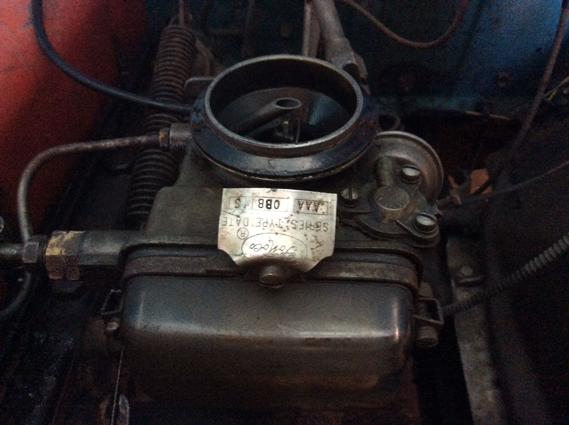

The first issue I think will be swapping carberators. I've to find out the differences between the A & E single barrel carb.

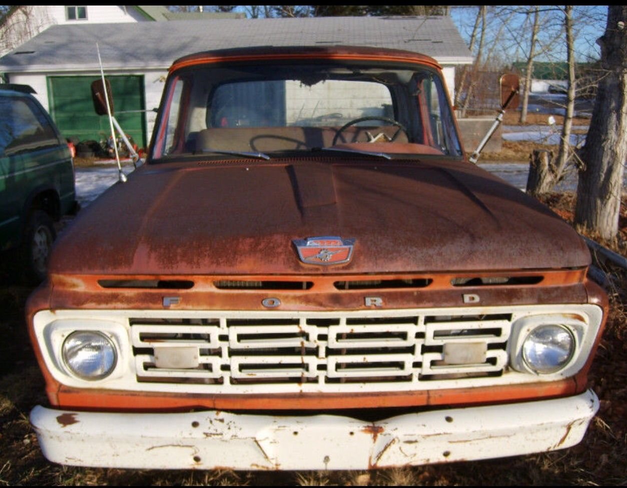

Another question. This is a 1964 grill correct?
This is where the 262 is coming from.

Correct.
C4TZ-8200-A .. Painted Steel Grille / Obsolete
Applications: 1964 F00/750 Standard Cabs.
The 4th digit of the VIN s the engine code: B = 262 1V I-6 / J = 223 1V I-6.
There is no parts catalog that can be downloaded and AFAIK, no one repro's a Mercury Truck Parts Catalog.
The 1957/63 & 1964/72 Ford Truck Parts Catalogs are available on C/D's from hipoparts.com.
