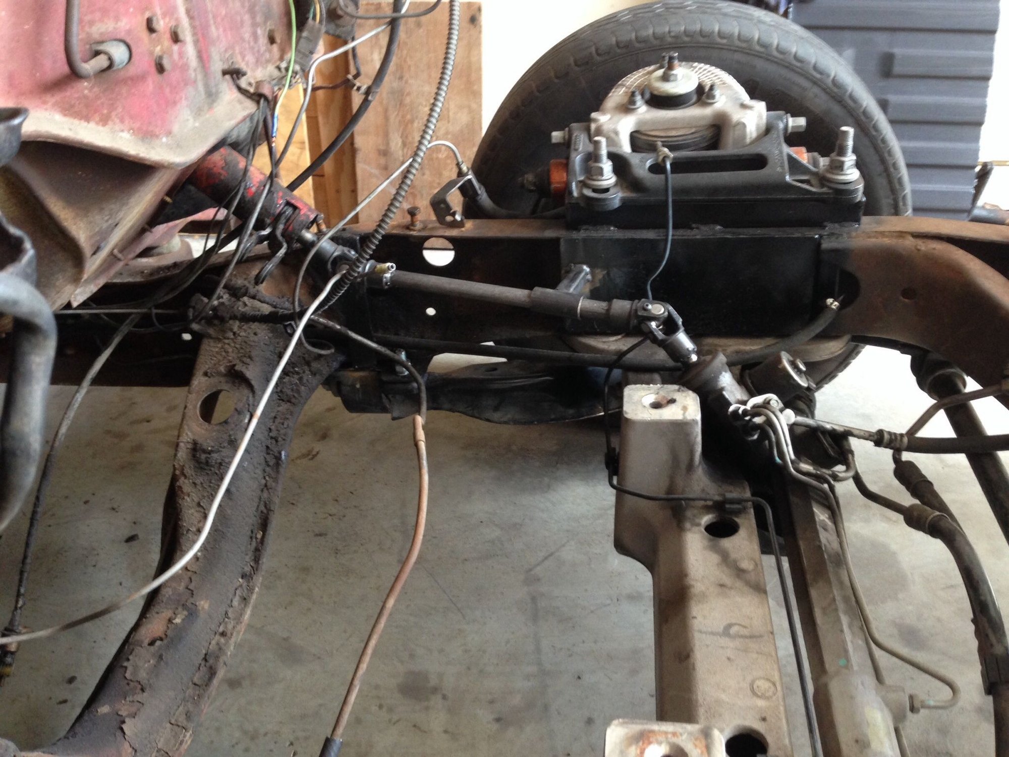

I am wanting to use the original steering column and adapt it to the crown vic steering. I need help with what I need to do to achieve this. Can the steering box be removed and just have the shaft that goes into that be adapted to fit? I need some help!!

yes they sell various u-joints and shafts that will do the job , the steering you have now the steering column shaft goes directly into the gearbox and will have to be cut off so you will need the u-joint that adapts to the shaft by drilling a hole through it and using a grade 8 bolt or have a short section of splined shaft welded to the end of the cut off steer column shaft .

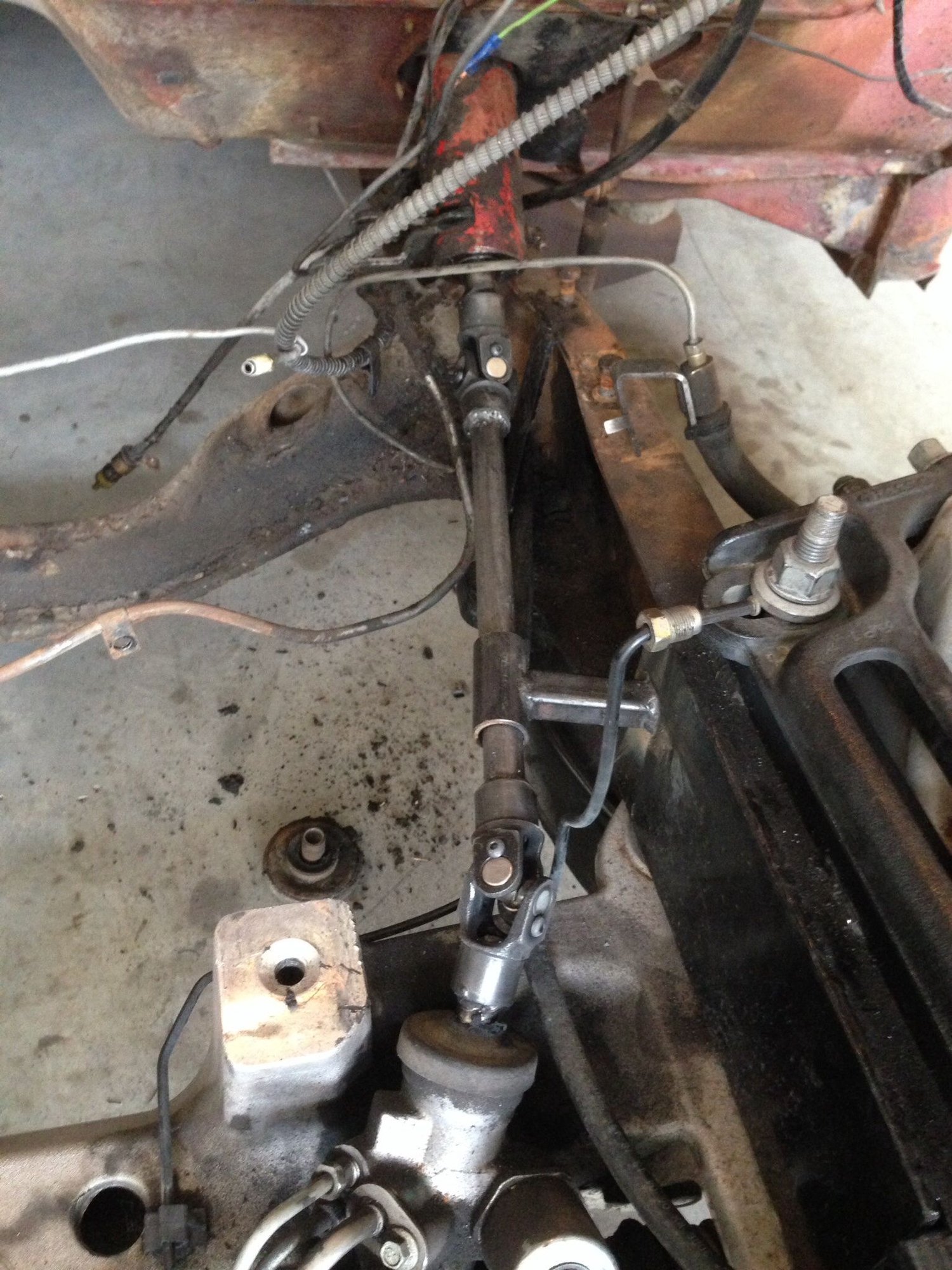

I have done the same with the steering on my 64. I removed the old steering box from the shaft (sawzall) the used a couple 3/4" slip fit u joints and some 3/4" cold rolled bar stock. Welded both joints as I dont plan on removing often. Also made a brace for the horizontal section of the shaft, to minimize deflection. Seems to work well in the garage, but have not had the truck on the road yet.

Do you guys have any pictures of your setup?

Lower u joint is at a pretty steep angle, but still turns smooth. Wish the CV rack could be pivoted on the x member.

Thank you thank you thank you!!! That is exactly what I've been looking for.
