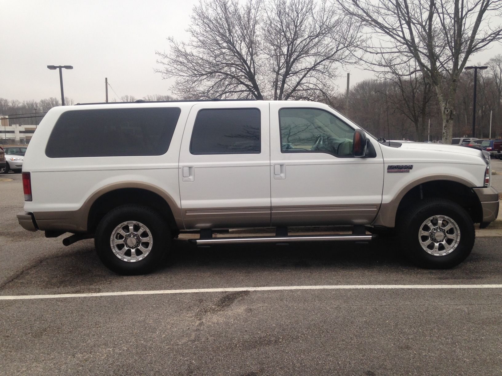

Front X codes done
I really like how the Ex looks with the B Codes on in the back. I recently completed the X codes, track arm, and some new front sway bar pieces up front. I gained a few inches, almost exactly as the front spring chart lists out. I'm about 1.5" higher in front. Trying to get into the auto craft shop on base this Friday to do the rear B codes with the mod. "Maybe" the front dual Fox setup will be in by then. It was back-ordered when I ordered it.
AT
And here is a slightly different aspect.
