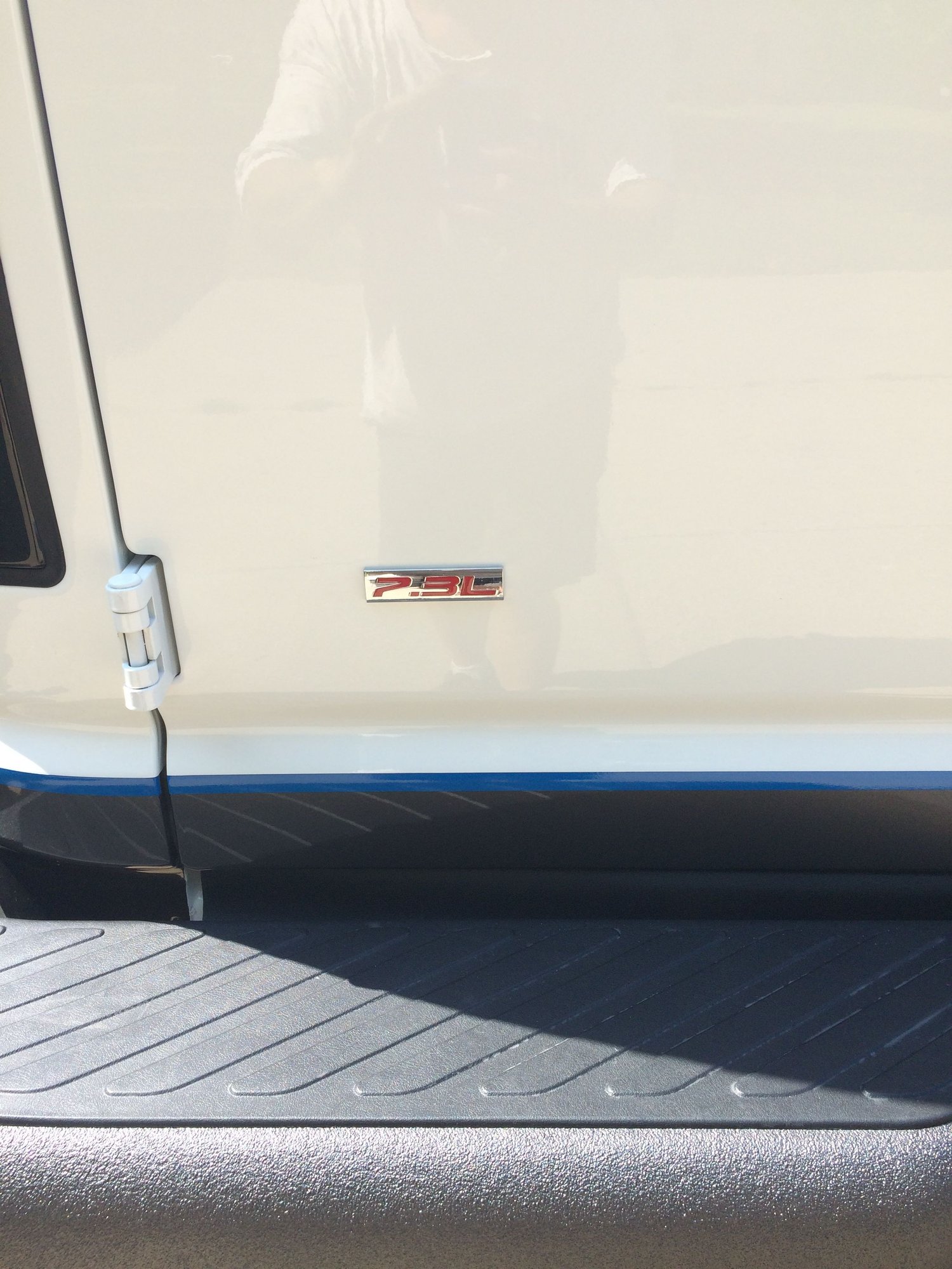

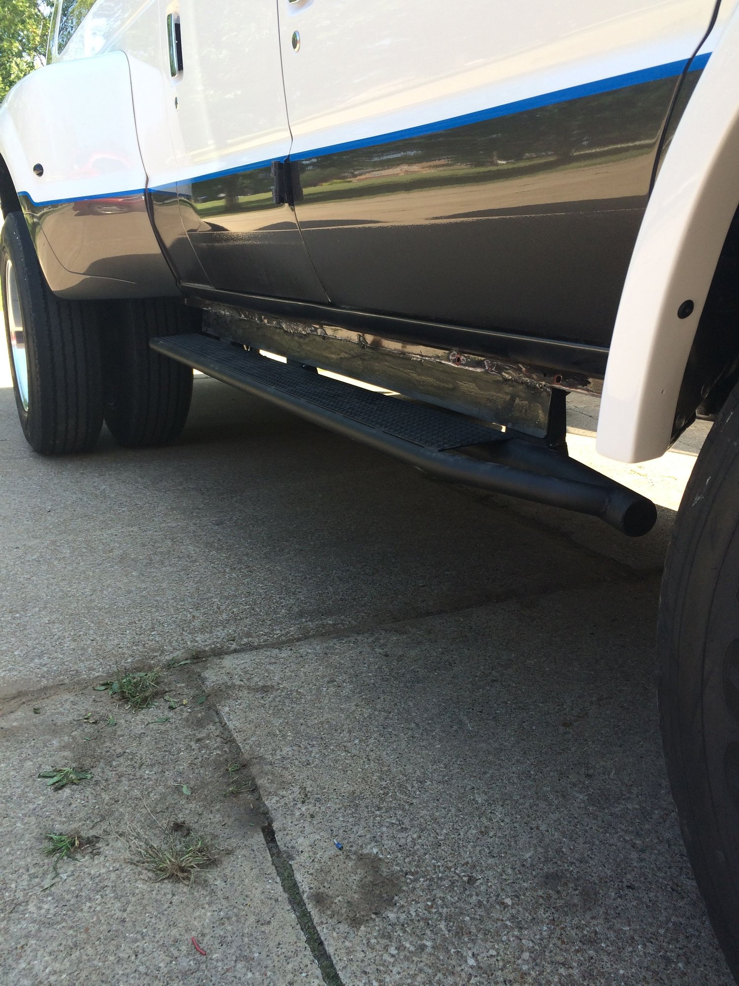

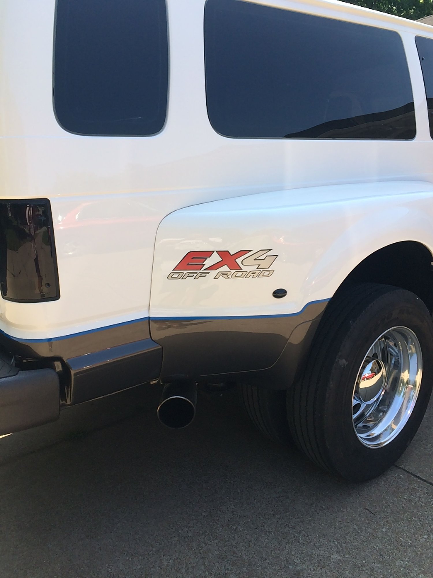

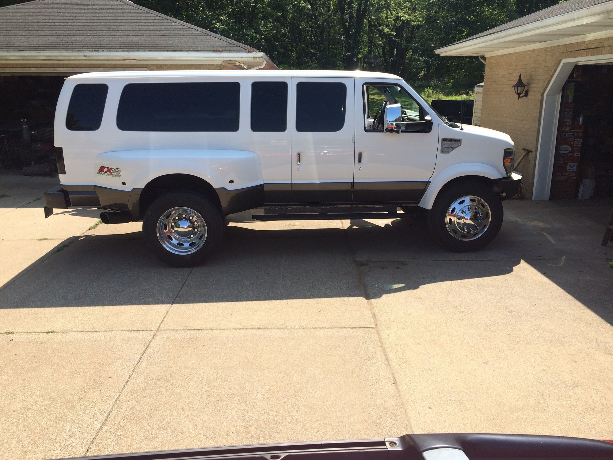

Small update time.
Adding some details.
Fender stickers.
Rear door emblem.
The steps being used. From a Superduty, of course modified to fit.
And the windows have been tinted.
Steve S.
To many to list.

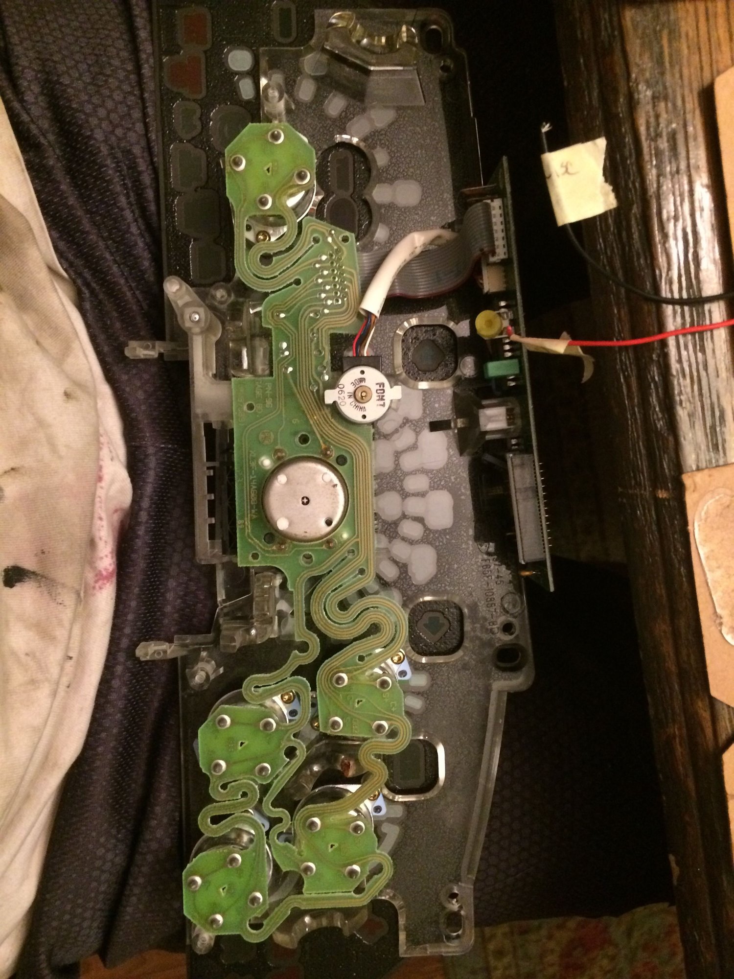

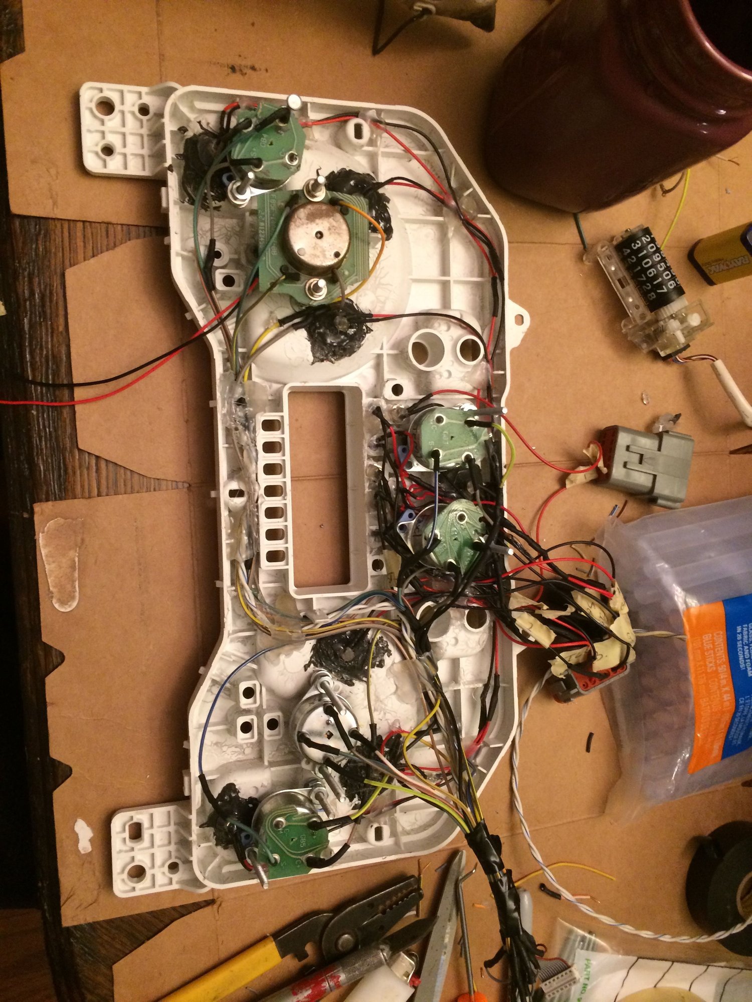

Working on the cluster as of late. I will try to explain what I am doing here.
The info center will not be working. Id love to be able to use it for at least the Odometer, but it uses a completely different architecture. Besides, this van does not have TPMS, Traction control, or just about any of the other stuff that comes up.
This is the original look of the 1999 Van cluster.
This is the look of the 2010 cluster.

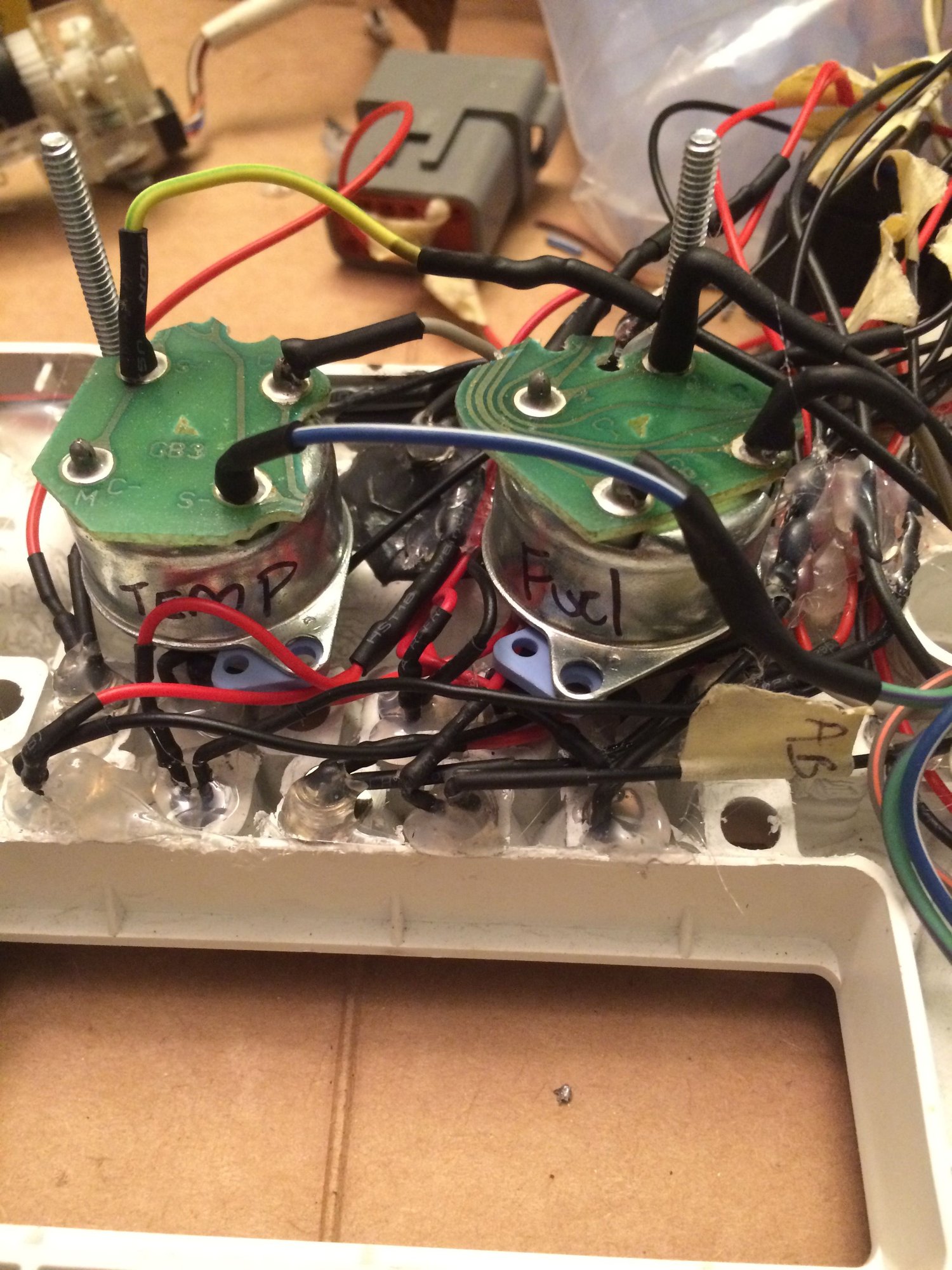

Basically I am using the 2010 cluster shell, wiring in LED bulbs into the cluster and using the gauges and stuff from the 1999 cluster.
This is the inside of the 1999 cluster.
This is the 1999 gauge cluster that is cut apart and starting to integrate it onto the 2010 cluster face.
In theory this will work just fine. Within the next few days, I should be able to say it works for sure. I am adding a couple of new cluster lights in (4x4, and 4 low).
Steve S.
