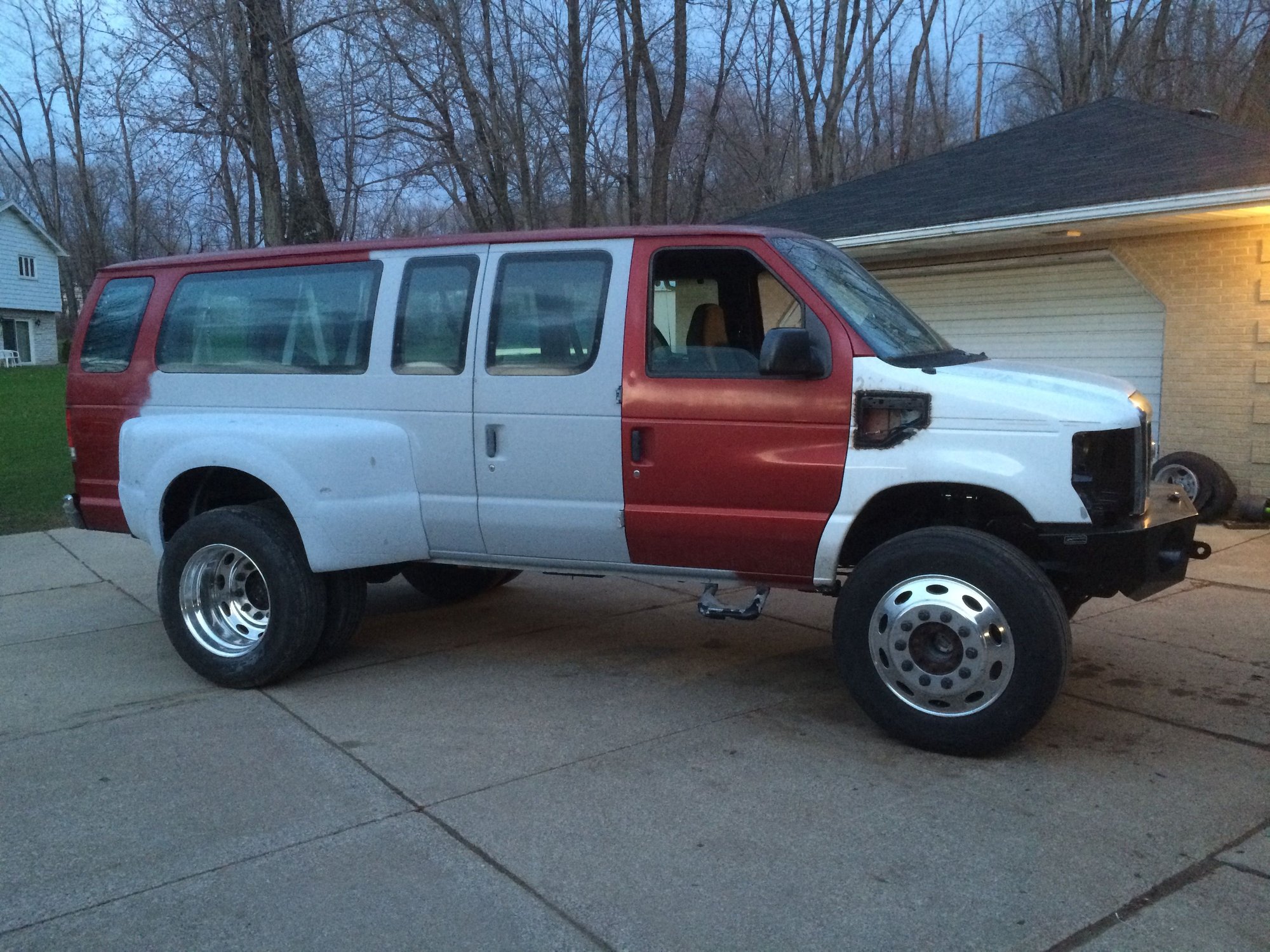

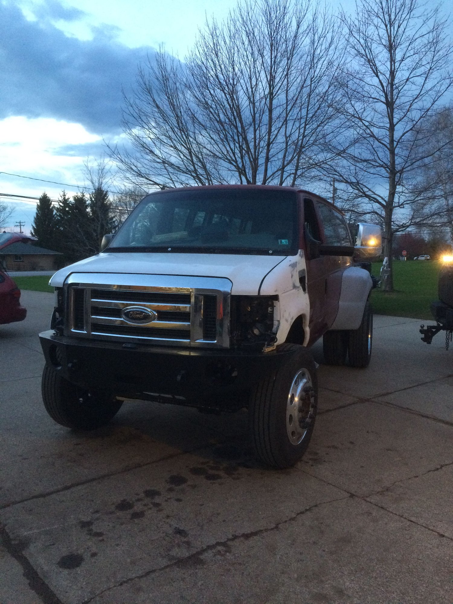

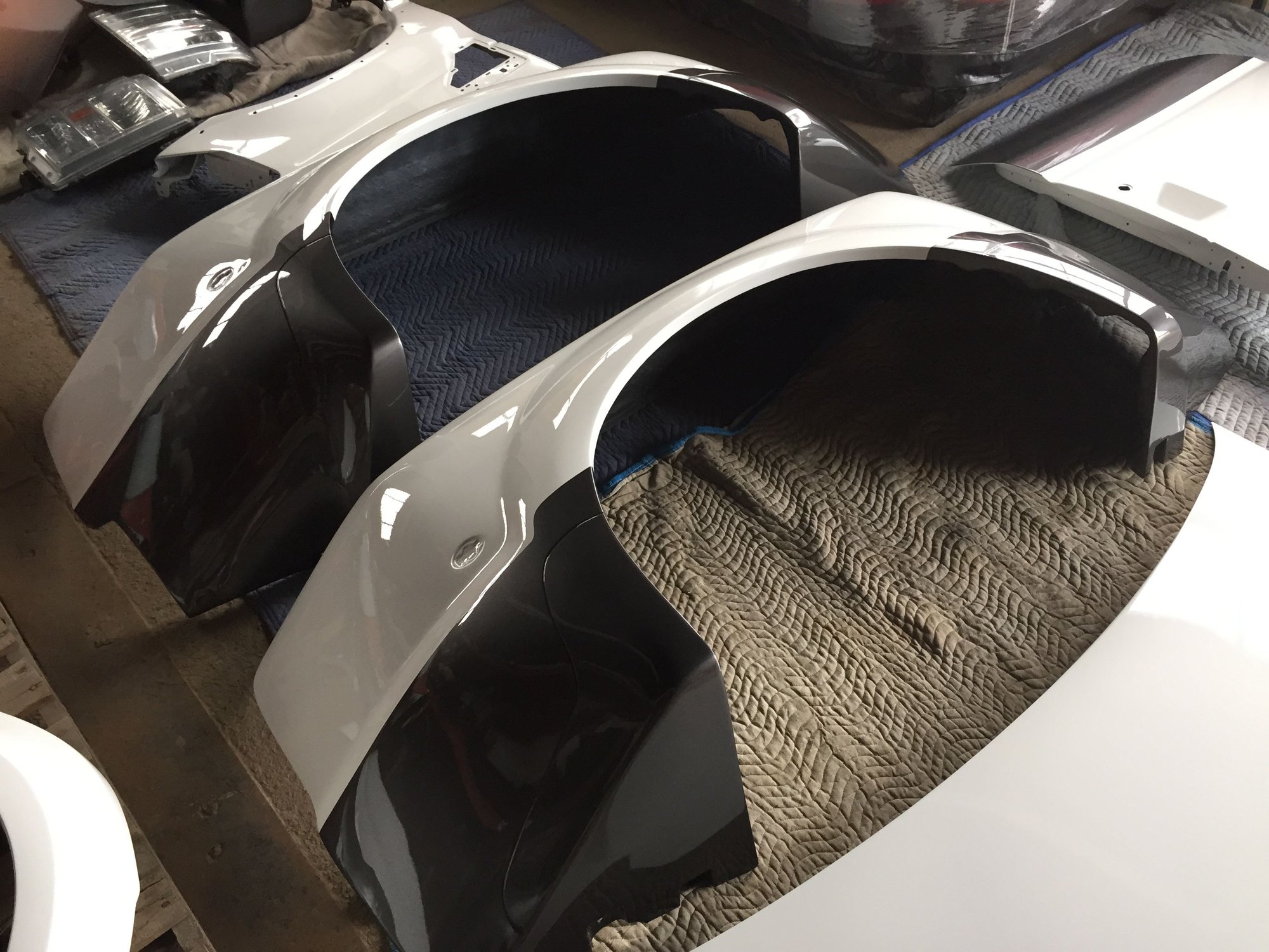

I have had a couple of projects that needed to be slipped in the garage, so the van progress slowed a little. Body work has continued tho, blocking out the rear fenders, and finishing the front fenders. The front bumper showed up yesterday, so that went on.
Its kinda hard to see with the low light.
We also started fitting the new tow mirrors.
And, we took it for a short ride last night. There are a few bugs to work out, but nothing major. It was nice to see it move again.

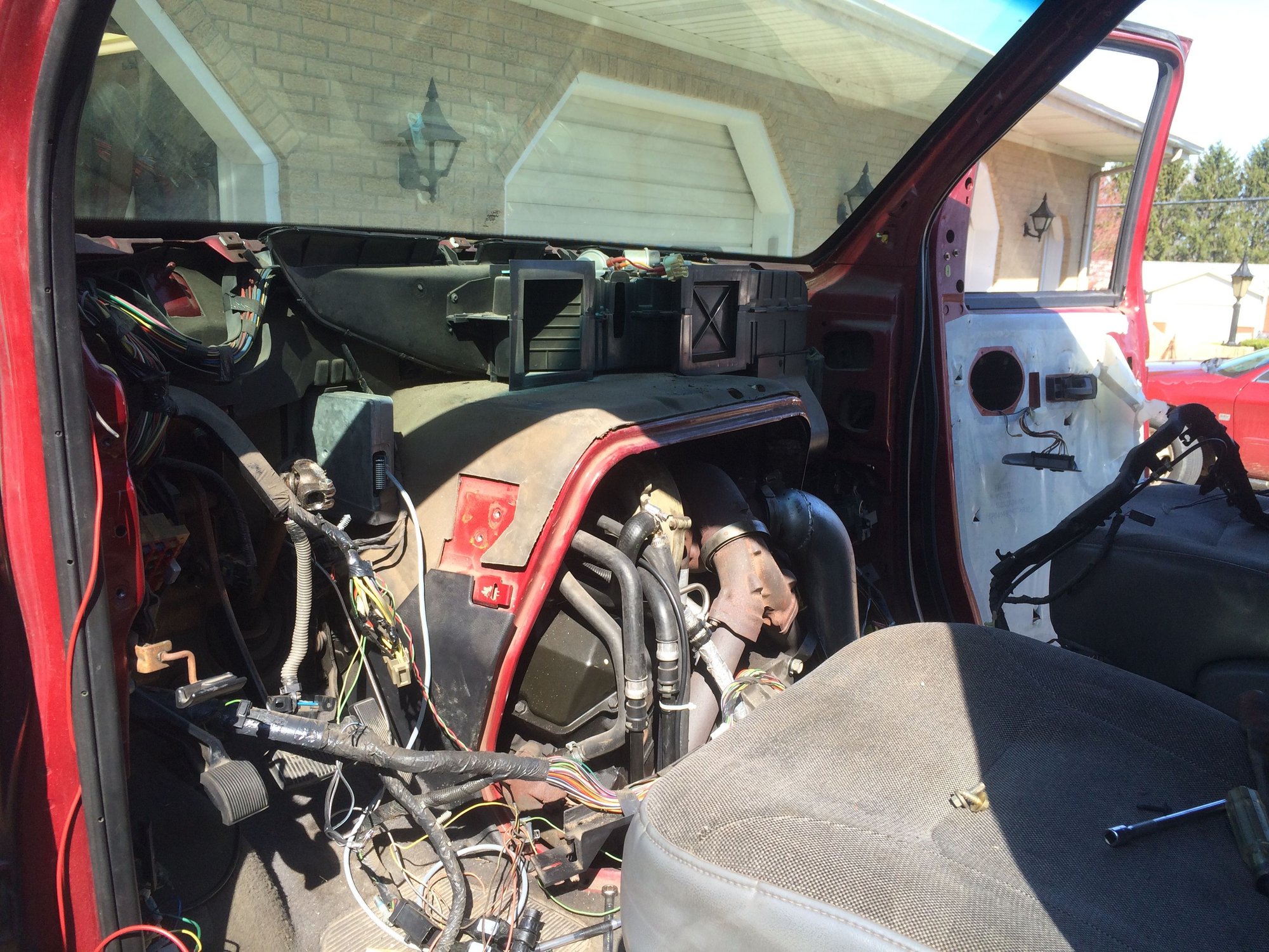

This weekend, the owner and I knocked out one of the last "big" projects. Saturday morning we started with this.
In less than an hour, we had this
In a little over an hour later......

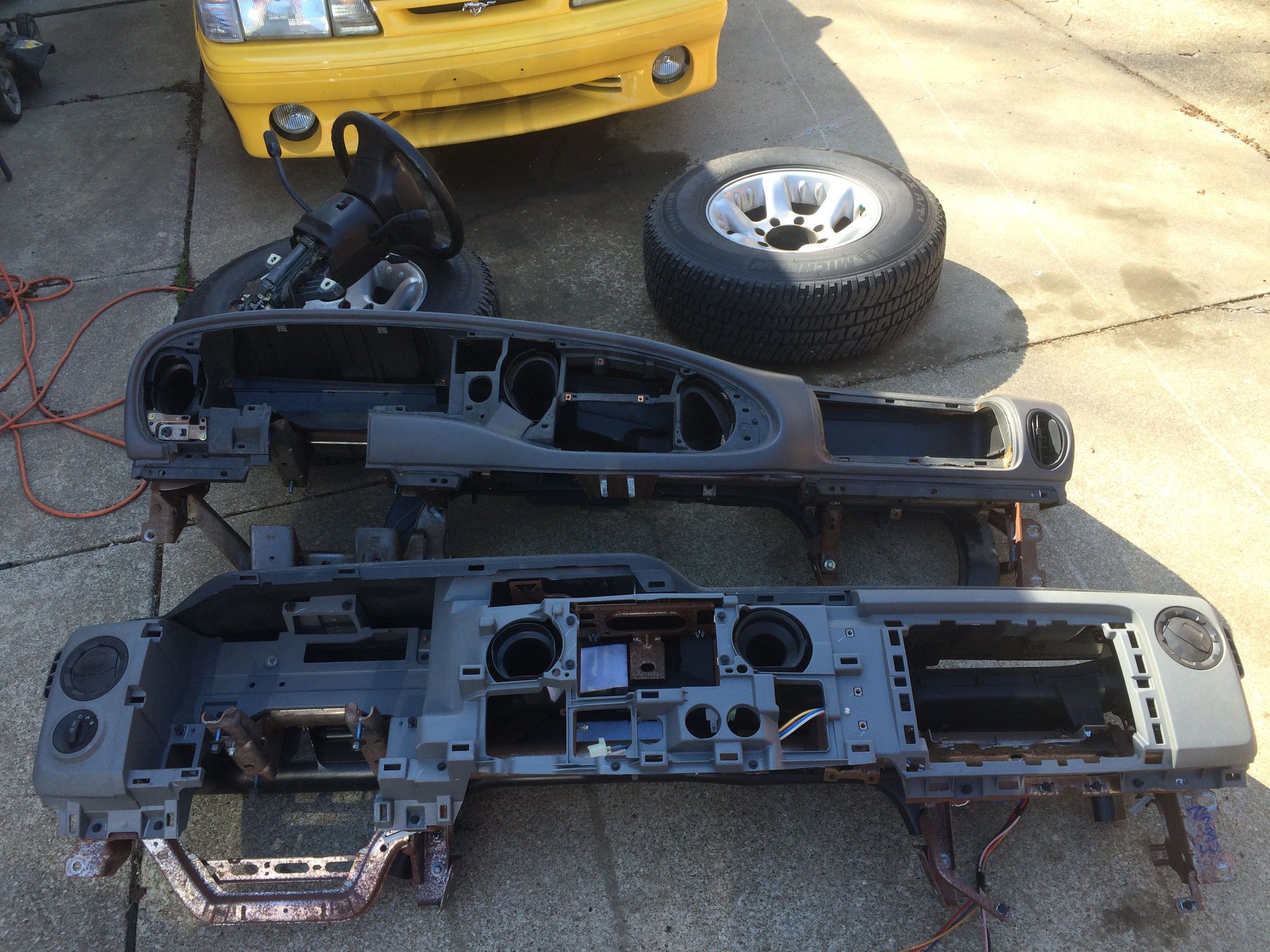

Everything is a physical bolt in. The heater box on the firewall is the same between the 1999 and the 2010 dashes. The heater controls are the same. The passenger air bag plugs in. All bolt holes line up. The 1999 steering column bolts into the dash. It is almost scary how easy this part was.

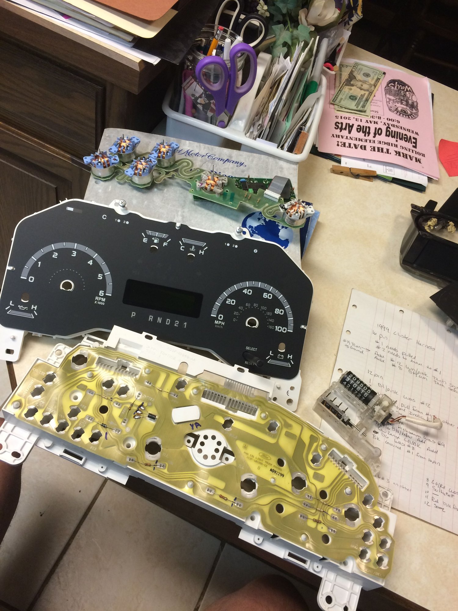

Now on to the "fun" part. The gauge cluster. None of this is bolt in. The 2010 cluster uses the "CAN-BUS" electronics, while the 1999 is still analog. What I plan on doing is cannibalizing the 1999 cluster electronics into the 2010 cluster face. In my mind, this should work, now lets see if in real life it will work.

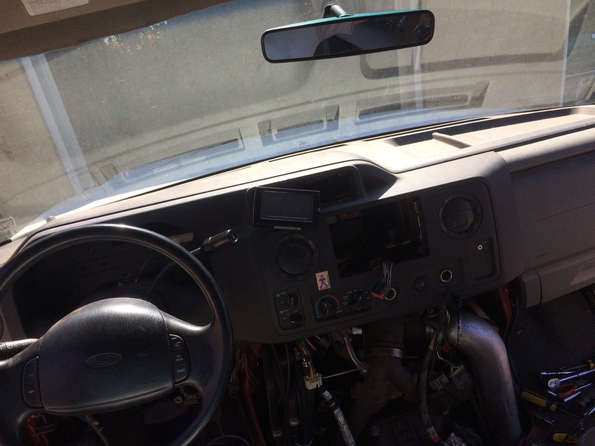

I have mounted up the TS controller and the 4x4 switch.
There will be some switches next to the TS controller.

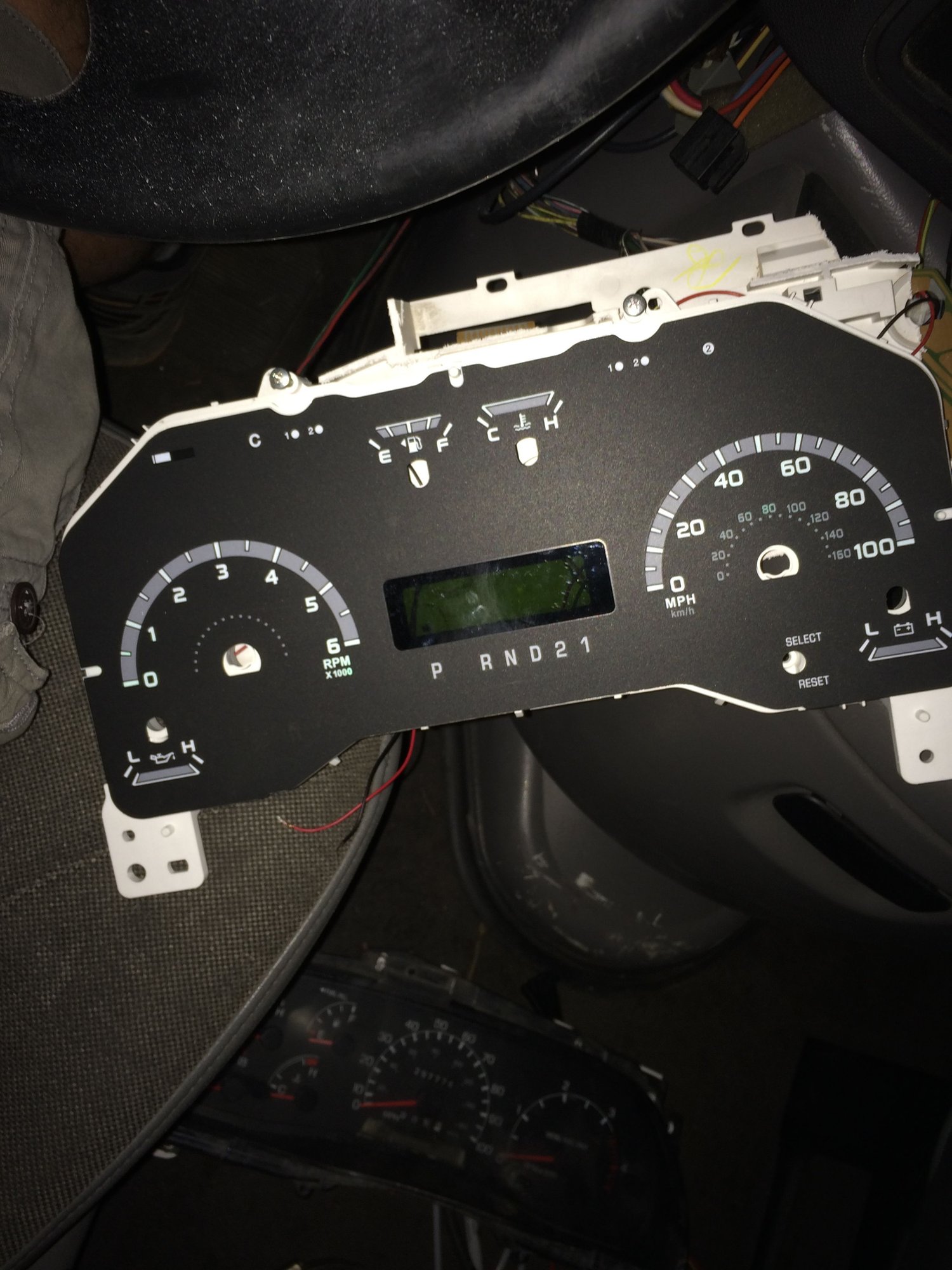

Then there is the fun part. The instrument cluster. I have taken the 2 clusters apart, and I am going to start wiring things together soon.

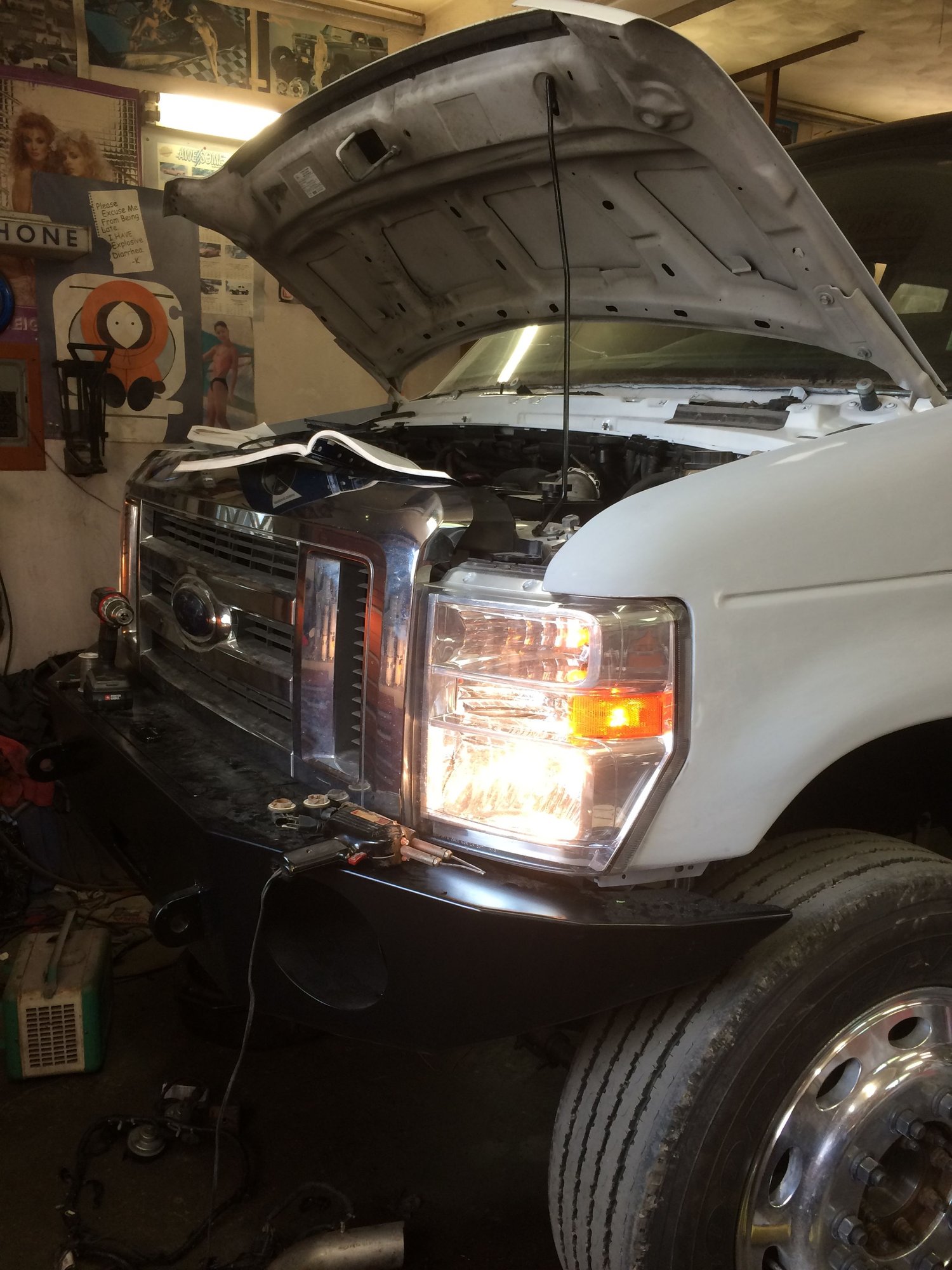

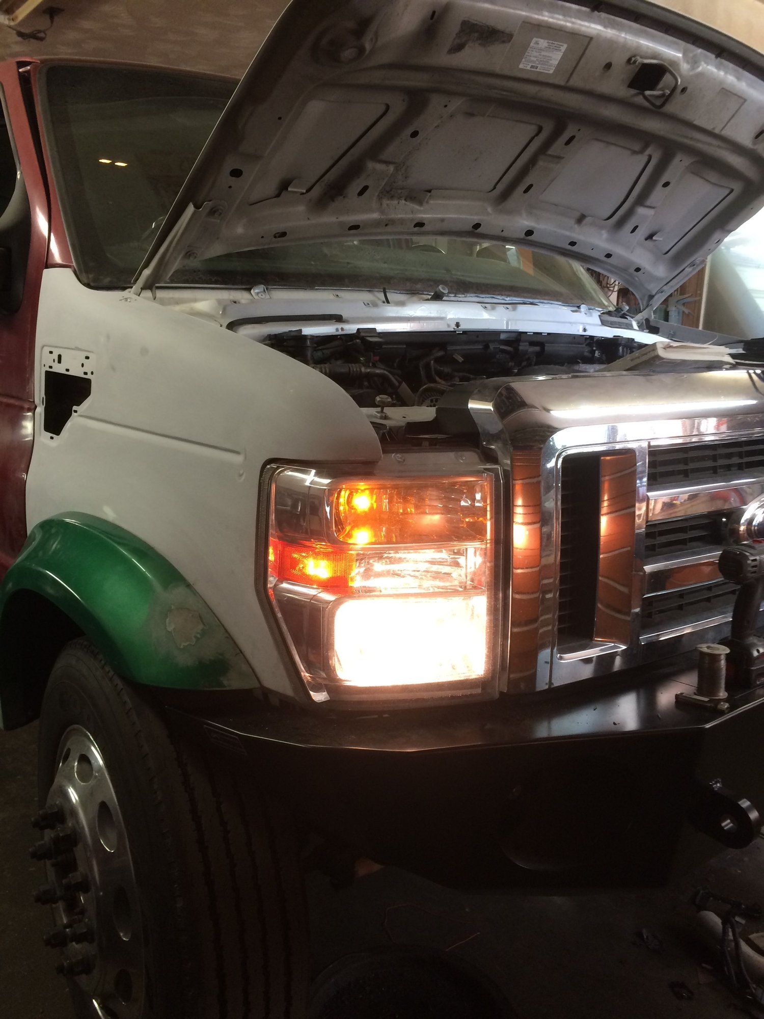

Well, I got a few minutes out in the garage before going to the hockey game last night, so I did a little bit more wiring.
We now have lights!!!
This is using the 1999 harness, with the 2010 dash switch, and the headlight plugs from the 2010. A series of relays were required to use the 2010 switch.

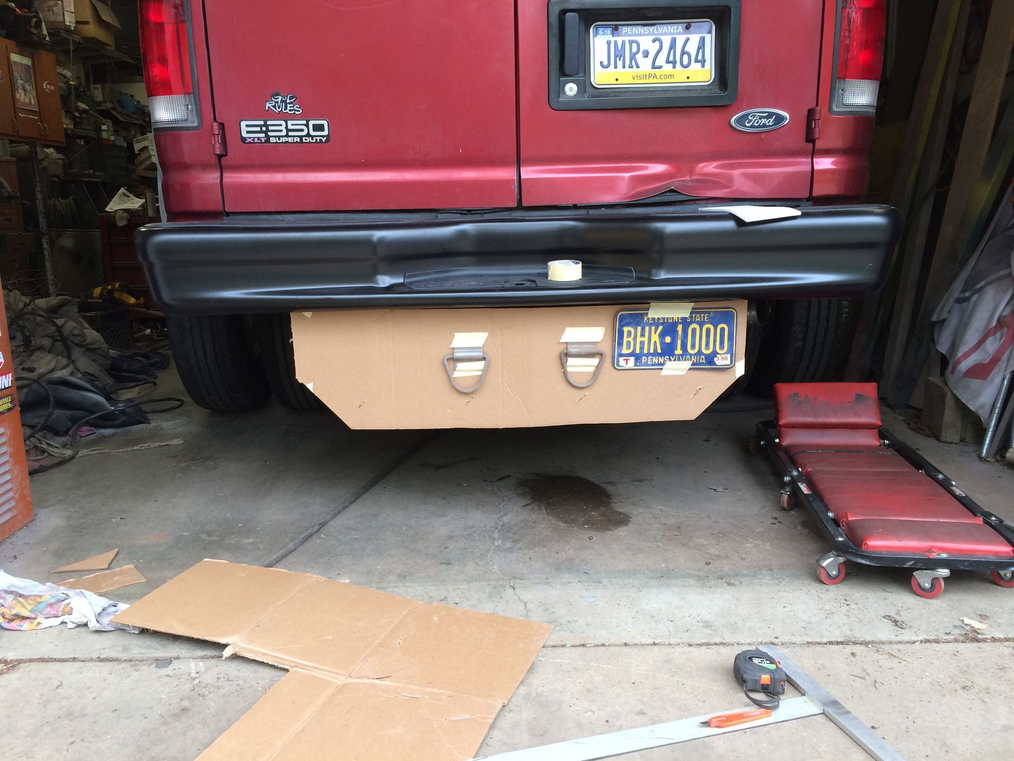

I mocked up the hitch plate and it is currently being cut. The license plate area will be recessed into the plate.

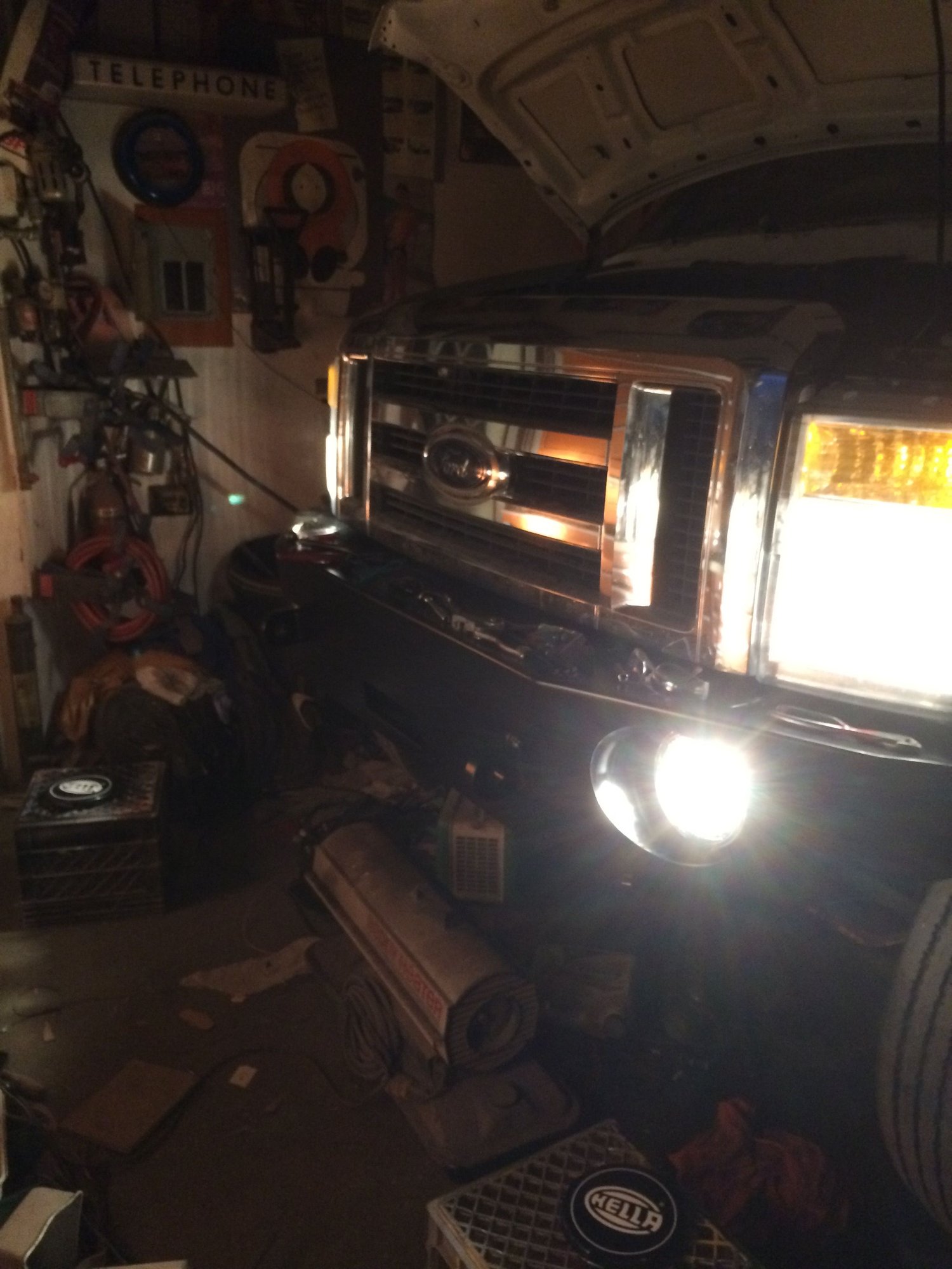

Wired up the front spot lights. 7" LED.

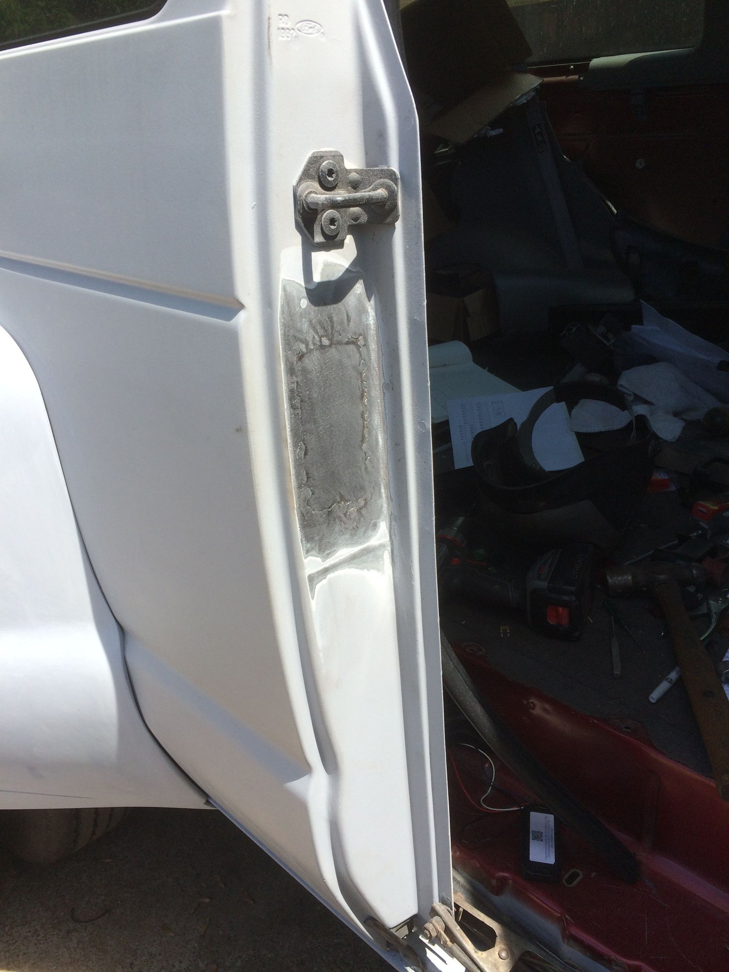

Since the back door on the side of the van has been welded shut, we dont need the handle in the door jam, so that was shaved

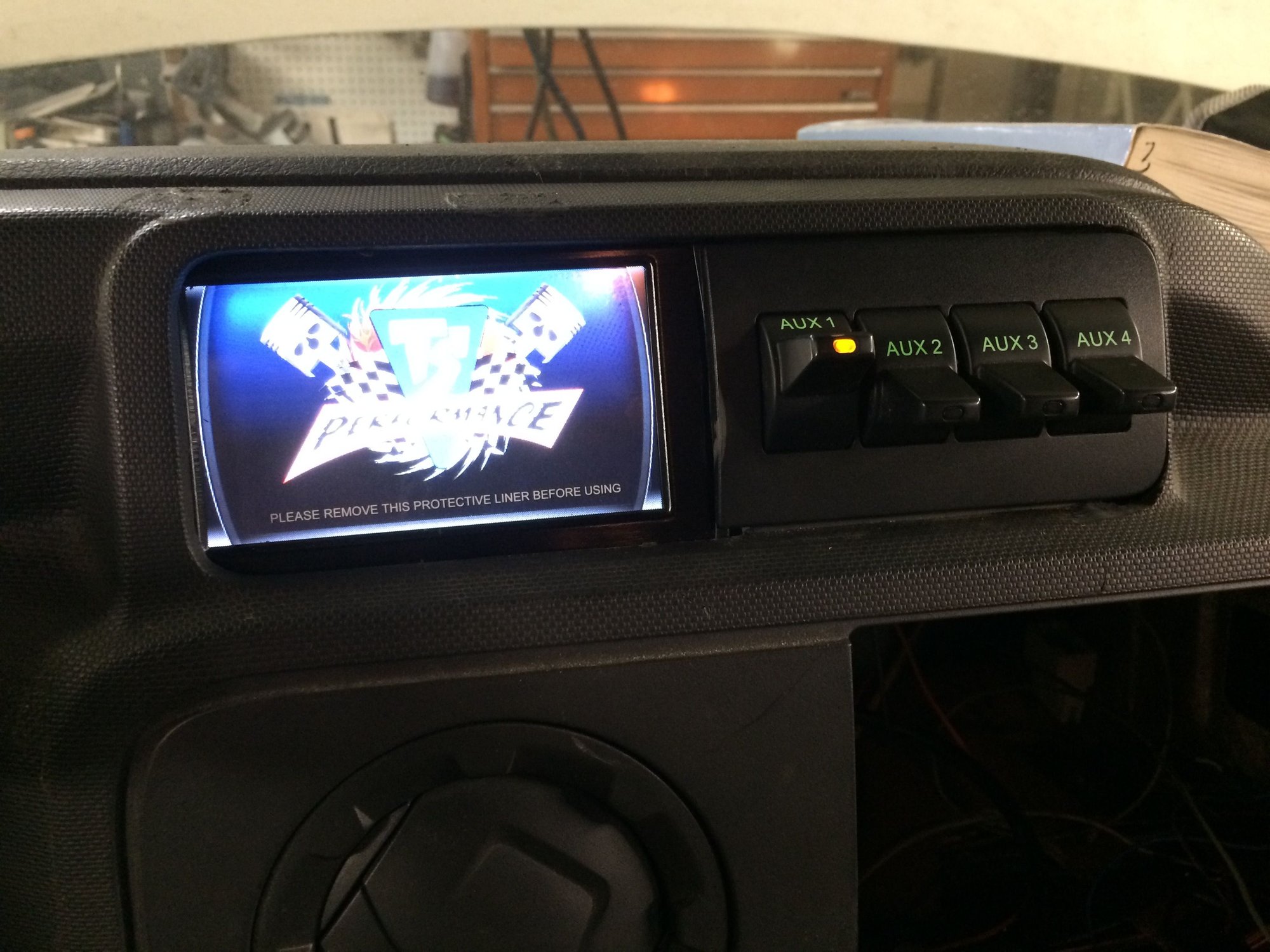

Added Upfitter Switches next to the tuner screen.

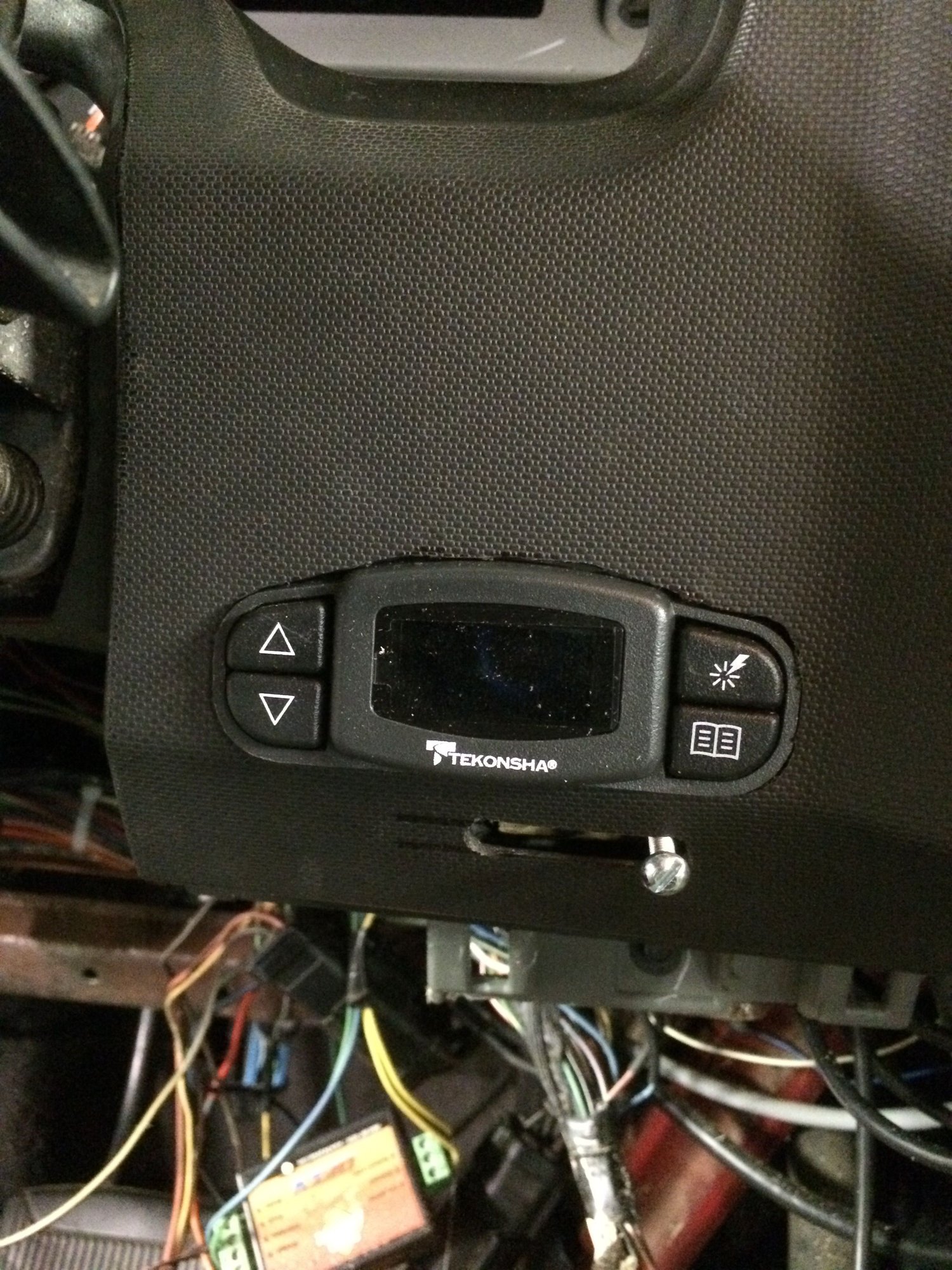

And the owner did not want the brake controller just hanging off the bottom of the dash, I flush mounted it to the right of the steering column.
The silver screw head is to activate the manual brake control. This will be replaced with a nice black thumb pad.

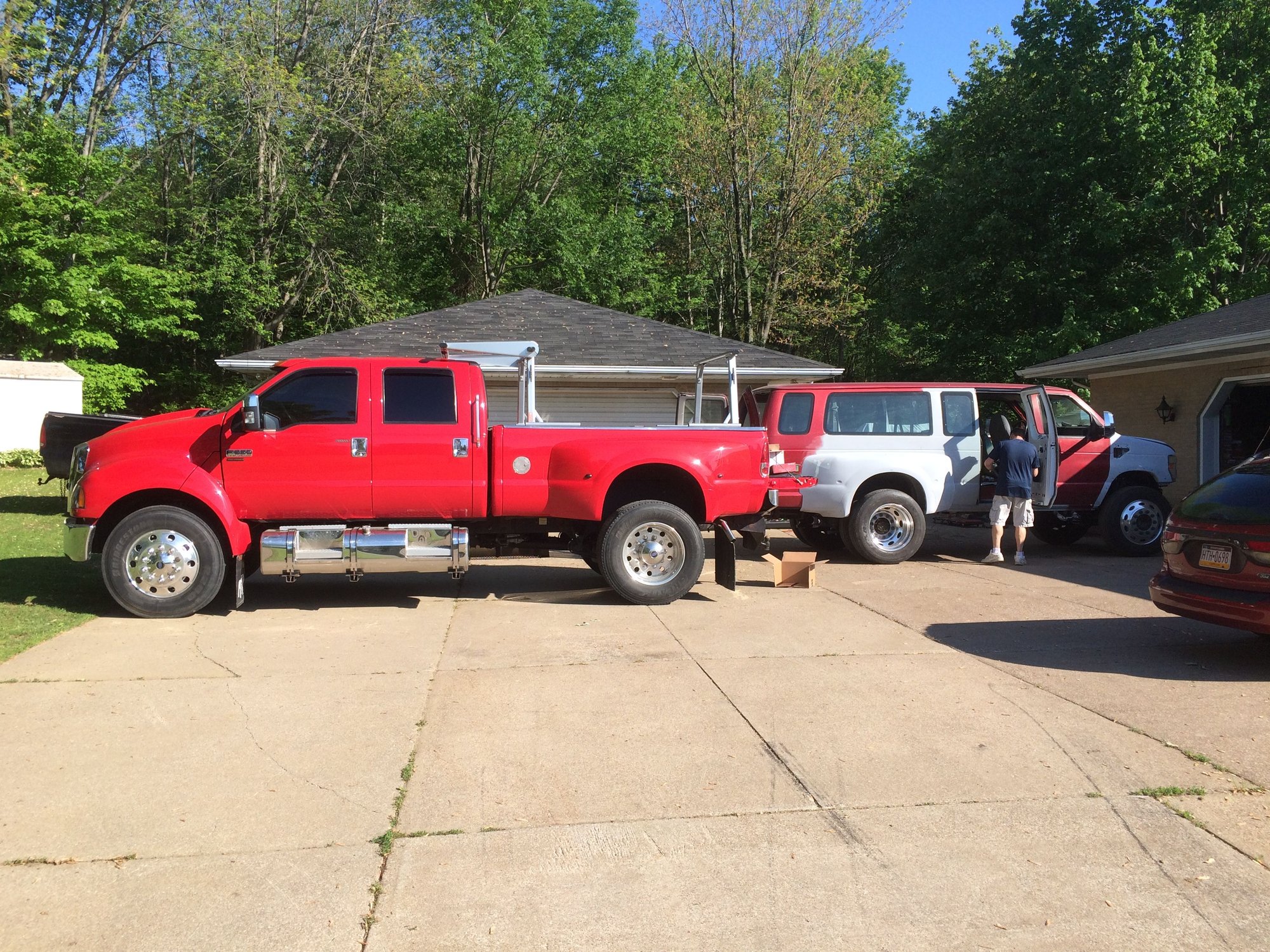

The van and what it will eventually be replacing.

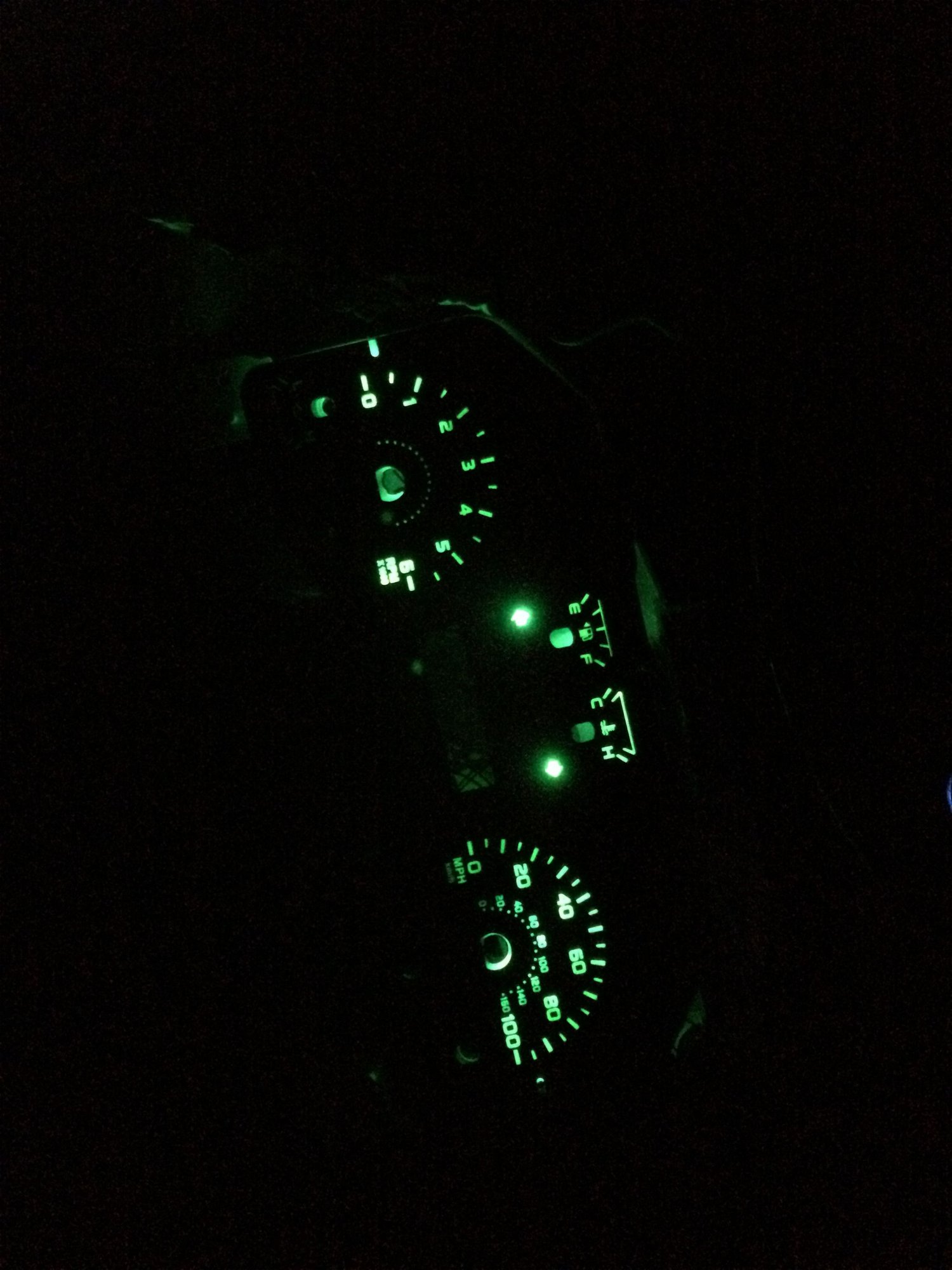

Working on getting the 2010 cluster working.
Checking things as I add them.

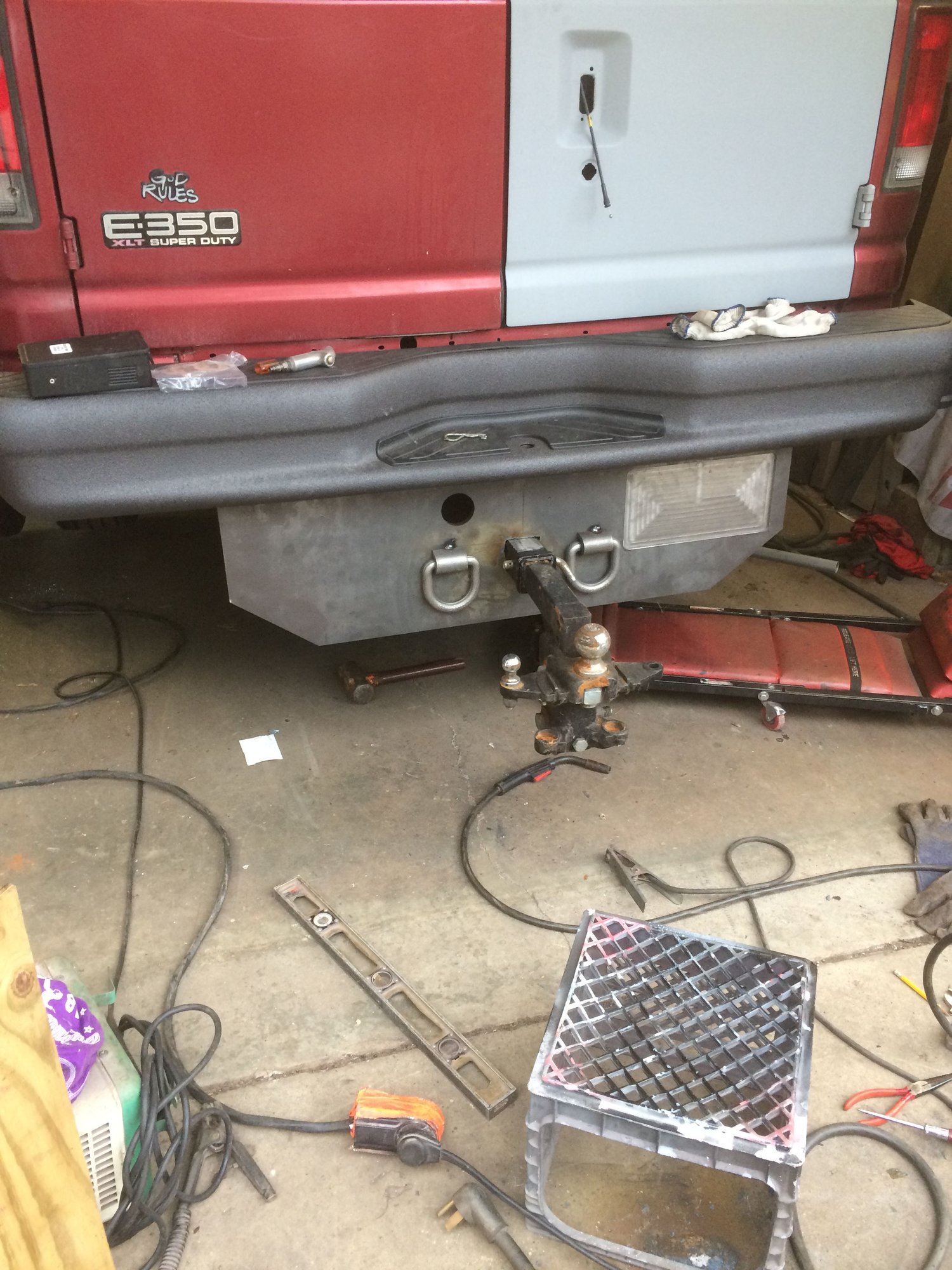

The hitch is made up and is getting welded.
All 1/2" plate. This thing shouldnt go anywhere.

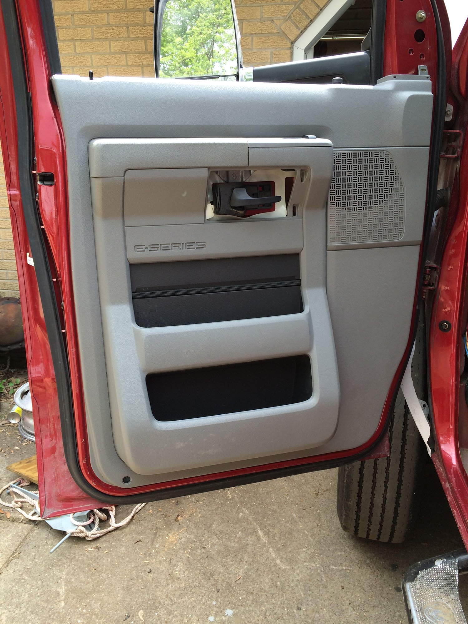

The 2010 door panels slide right on. I have not done the wiring on the switches yet.

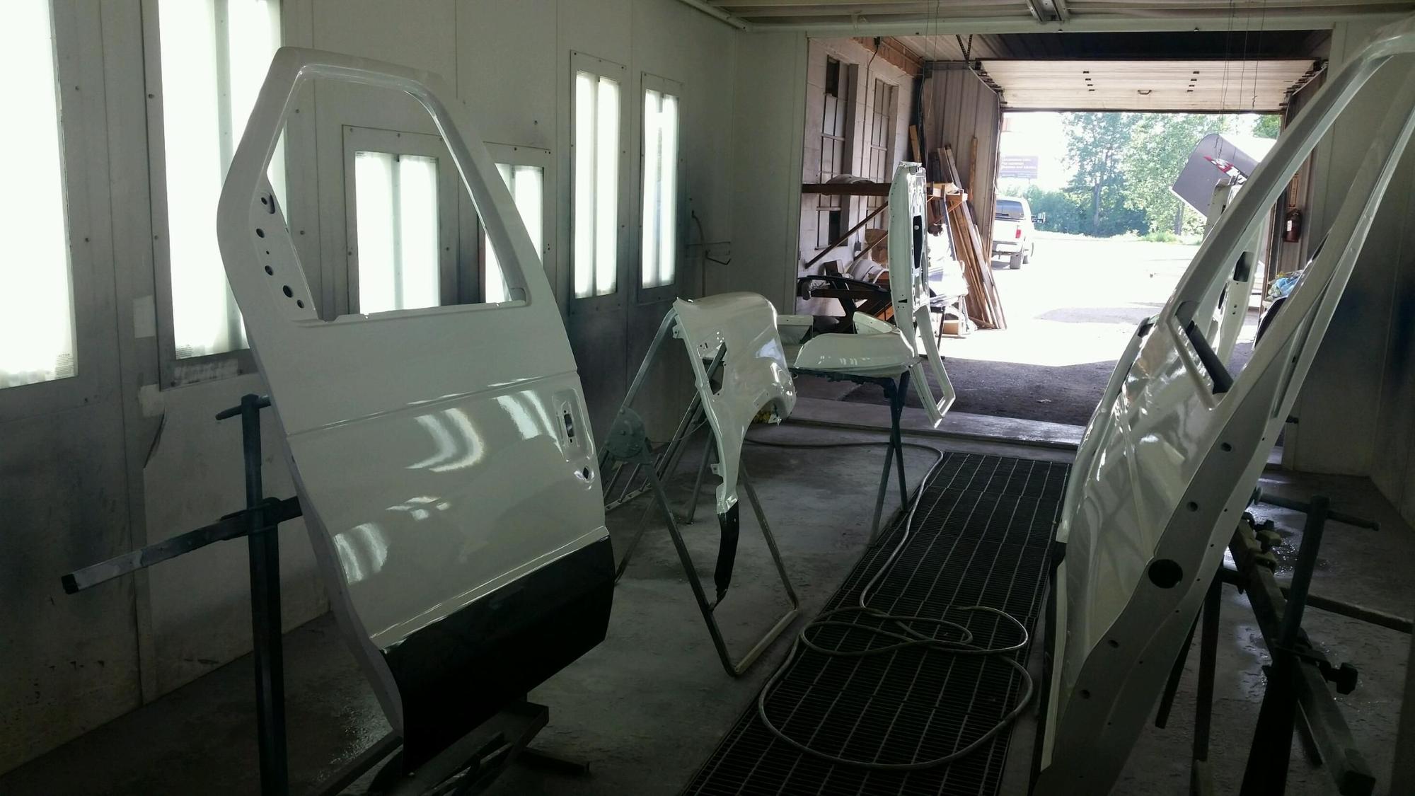

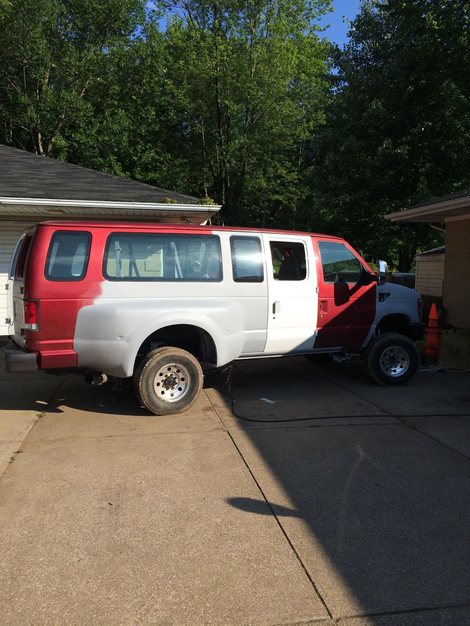

Preparing the van for paint. On the little tires.
And finally, some paint on parts.
