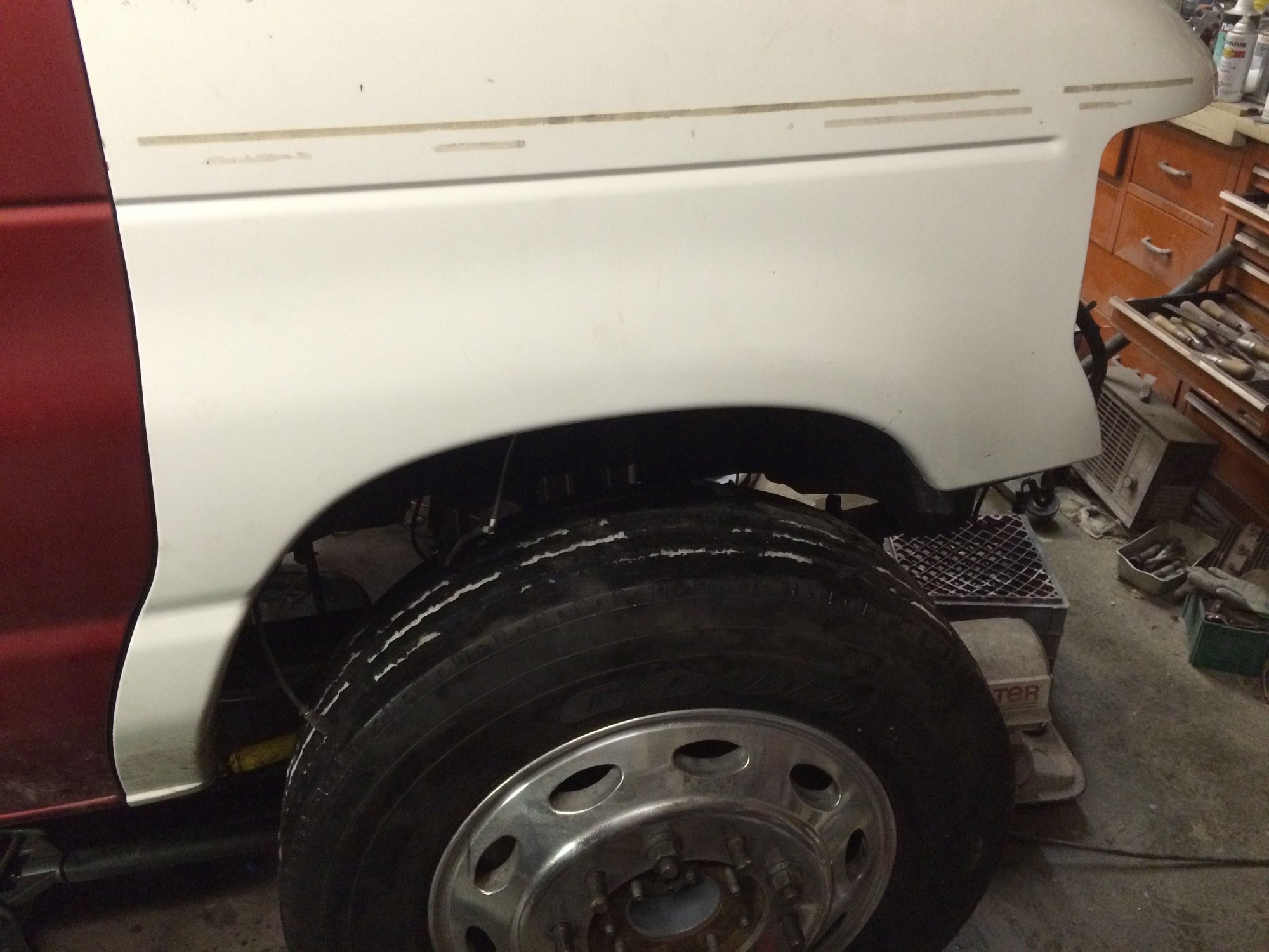

Monday night work update. The wheels and tires are in!!!! I know this look isn't for everyone, but you gotta admit, there isn't another one like it
And yes, I'm running out of room quickly LOL
The plan is to section the wheel opening and move the front of the opening forward 3-4" so the wheel looks centered in the wheel well.

Front well opening won't need much trimming---from where I'm sitting its almost there now. Here's one I thought was just cool as can be:

The trailer truck wheels are your preference, but your plan with the front fender is brilliant. That will make it look much better proportioned.
