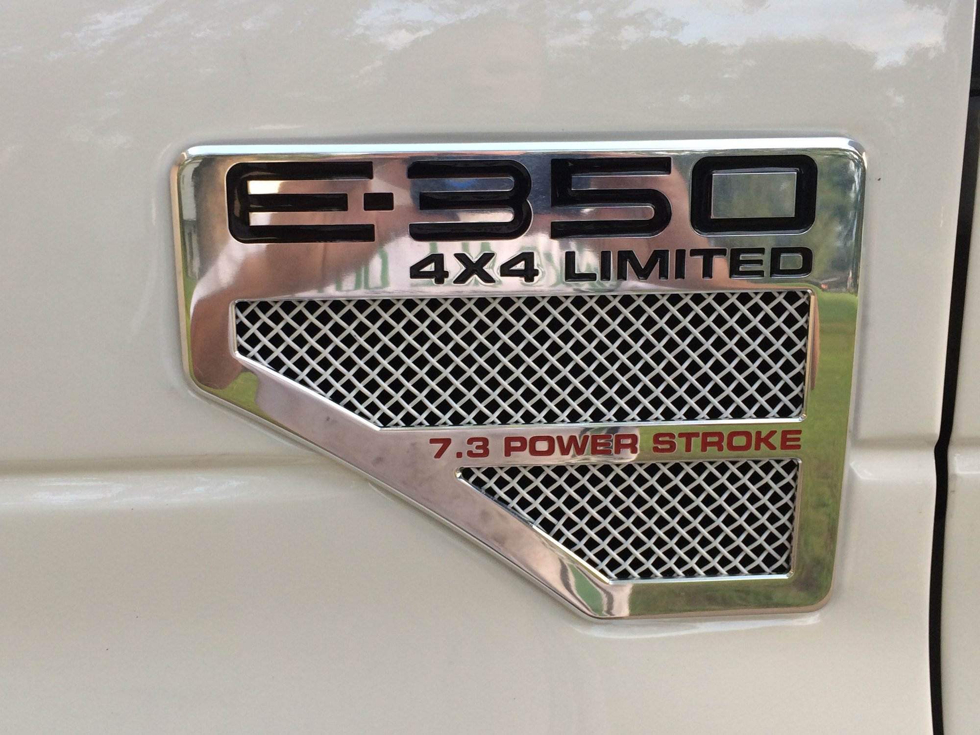

Time for an update, and answer some questions that have come up.
The clearance under the hitch plate is 12" from the ground. This plate is the same height as hitch plate on his current F-650. The rear suspension is auto leveling air ride, so the rear of the van will stay at the same height no matter the load on the hitch.
When adding the fuel tank in the rear, the frame cross members were modified and reinforced in anticipation of the towing this van will do. A plate will also be added inside of the frame rail where the hitch bolts.
The Superduty sway bar was used up front, but there is no sway bar in the rear due to the suspension system used.
There will be a "safari' style rack on the top of the van. The van should be about even with the trailer.
The details are not finalized for the interior yet, but I am sure a camera is in the plans.
Ok, now on to pictures
It is getting closer!!!!
The emblems.
And 1 of the major items on the to do list is checked off!!!! This van is officially 4 wheel drive now. With the turn of a dial on the dash.....
And with the van in neutral and your foot on the brake, turn the dial once more and......
The ESOF functions just as the factory intended (in a Superduty at least).
The light at the end of the tunnel is getting brighter.

Impressive.
Even the logos on the side vents are customized! Ill love to see this thing in real life.
