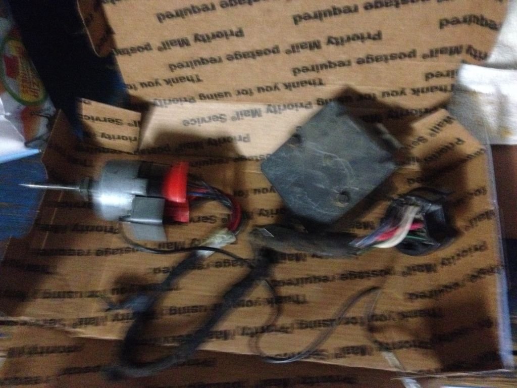

I decided to grab one of these off eBay and it arrived today. Sorry for the terrible pics but I thought I'd share for those interested.
Can someone advise factory location of box mounting?
