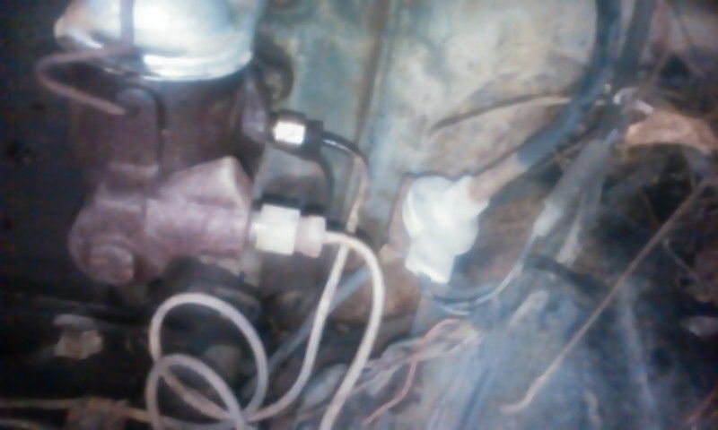

I have a 70/71 half ton short bed six cylinder. in the speedometer cable there is this part the cable screws in both ends and two wires run from it. it carrys a D0OF part number I trace the wires.part way there is a box under the dash about 2x3x1 1/2 black top cream sides in color and then a pad on the driver side door Jan about an.inch in diameter. all three pieces carry the D0OF prefix. any ideas??

I found one of those on a parts truck and after some lengthy discussion on another forum, it was concluded that it was part of an emissions device, can't remember sure what though. I think it's basically just a hall affect device that sends a square wave signal.

It's the same sensor as used later for cruise control, but it is for emissions, same as the silver button thing in the door frame. That's a temp sensor. There is a module on the firewall that takes these inputs and plays with the ignition timing to help with emissions.

It's not for dealer installed Cruise Control, as it wasn't offered for these trucks.
It has something to do with emissions (electronic spark control). There's a parts catalog pic of the whole enchilada, but I haven't been able to find it yet.
D0AZ-9E731-A .. Speed Sensor / Obsolete ~ 1970/71: See parts catalog applications.
