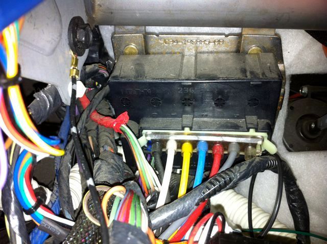

Old Dec 4, 2014 | 11:11 PM
  #49
Yahiko's Avatar
Yahiko
Joined: Apr 2012
Posts: 27,307
Likes: 549
From: Spanaway
Found the photos.
This is looking at the structures with dash and stereo removed.
The stereo sits right in front of the unit and not under the glove box.
This is a 2006 with the EACT system.
That Blue box top left is the steering wheel control
adaptor for my stereo.
Sean

Originally Posted by Yahiko
Found the photos. This is looking at the structures with dash and stereo removed. The stereo sits right in front of the unit and not under the glove box. This is a 2006 with the EACT system. That Blue box top left is the steering wheel control adaptor for my stereo. Sean
The blend door actuator I got is not the one where the 6 lines plug into. Definitely different. It looks like it's mounted closer to the shaft in the back. I think.
