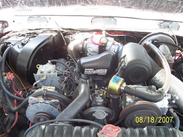

Im sitting on 4" suspension/3" body lift right now but if I go diesel axles/front susp will be swapped. Looks very tight in there. I will be running electric fans but have the desert cooling radiator in my truck and im worried how much room id actually have.
Id love to post pics but im unsure how to do it from my phone..

Old Sep 16, 2014 | 10:31 PM
hairyboxnoogle's Avatar
hairyboxnoogle
Joined: Apr 2008
Posts: 6,942
Likes: 13
Not all have to notch by the starter, i didnt have to. Its damn tight, but you can wiggle out if you hold your tongue just right
Old Sep 16, 2014 | 11:46 PM
ZombiePopper's Avatar
ZombiePopper
Joined: May 2014
Posts: 238
From: Kansas
Originally Posted by sixty7
That's bad @$$, love that truck
