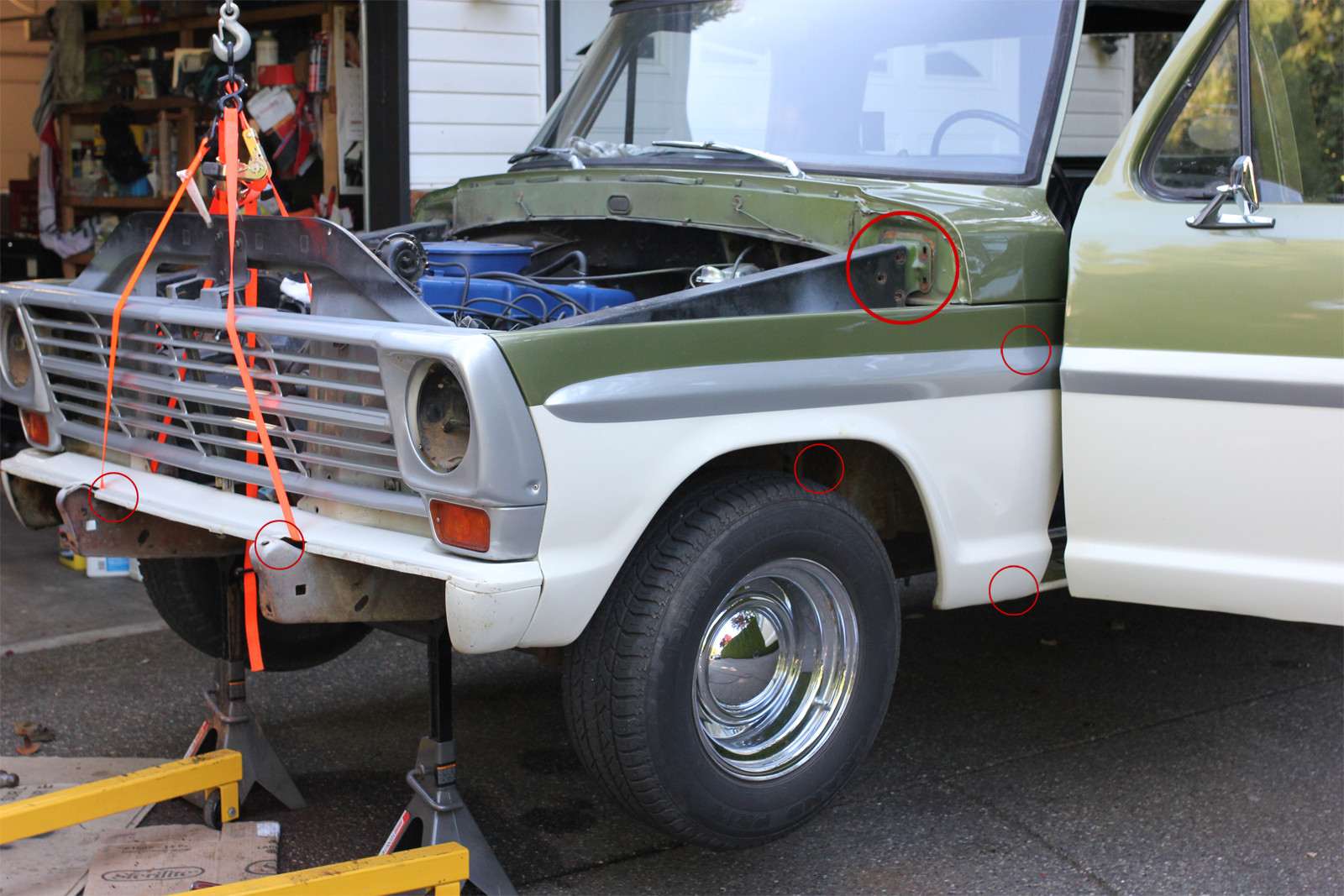

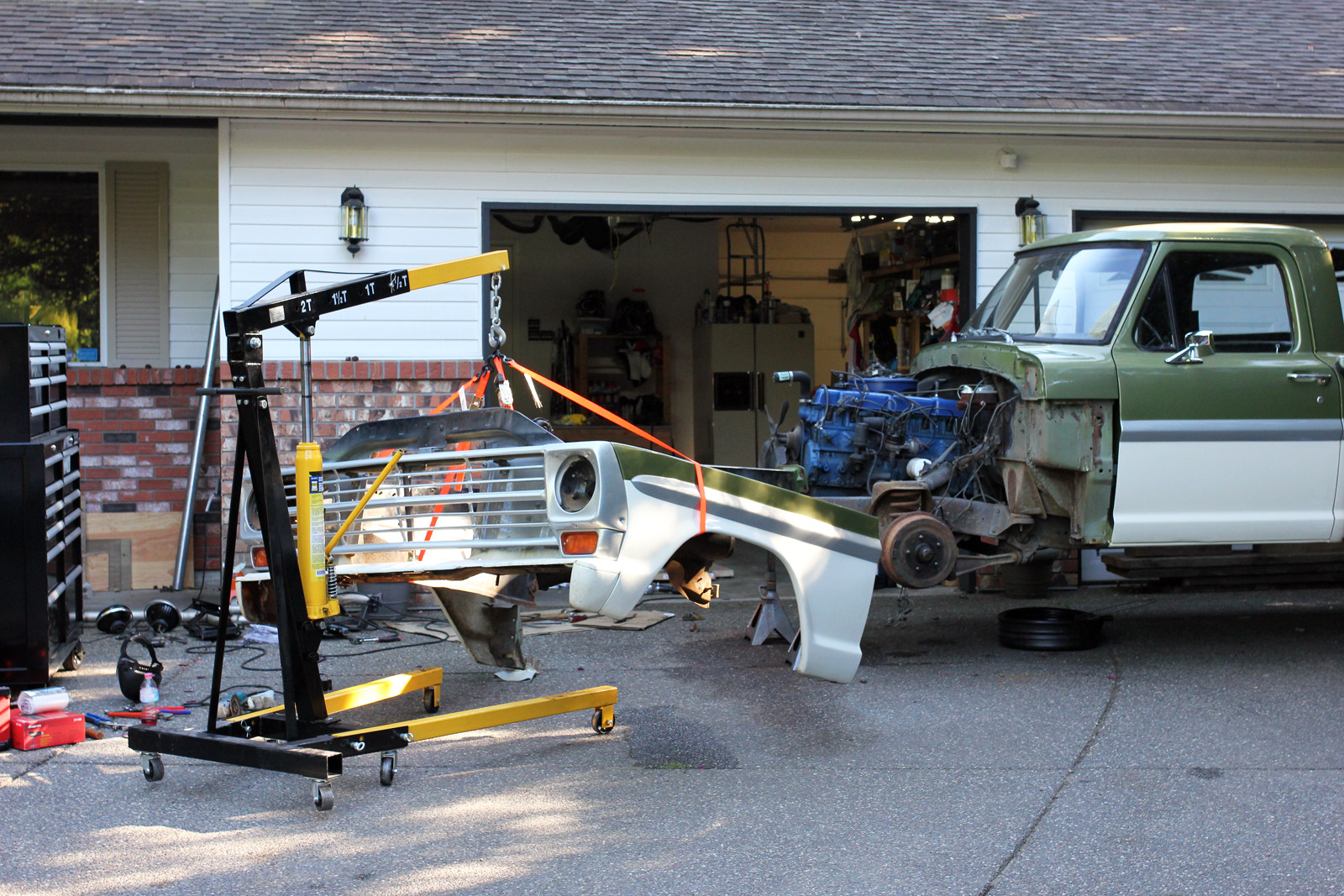

I pulled the whole front end off. Made my life a lot easier, especially if you're pulling the engine and the trans.
Attachment 291305
If you go this route, I suggest you get yourself a helping hand. There will be bolts in these locations. You'll need a sawzall for the radiator support mounts.
This looks great! Plenty of room to work! Thanks.
