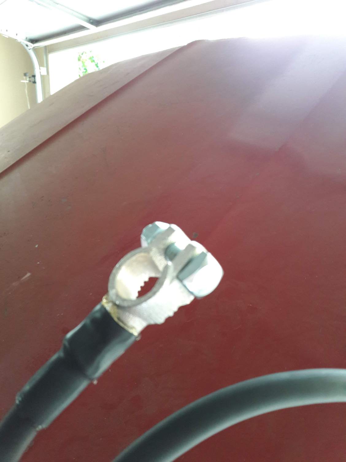

Just joined the forum but have been researching things for a few weeks for a daddy/daughter project - 1973 F100 (390) 'fix'up' for her first vehicle. Thanks to all in this post (and others) for their unknowing assistance. Truck has a lot of little things to remedy - one being the negative battery cable being fastened directly to the alternator bracket.
The photo from mikeoOoOoO was spot on. All the cables in the store have lugs which are too small as noted for the 1/2" bolt. I was able to order one based upon the information contained in this thread from AC/DC Wire and Supply for $15.99 + $3.00 S&H. Took a while to find one that would mimic factory as best as possible.
Plan to install this weekend.
Sharing some pics.
