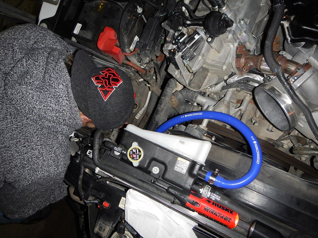

Yeah the Sinister kit has a loopback hose.
Allow me to recycle this image from my install project.

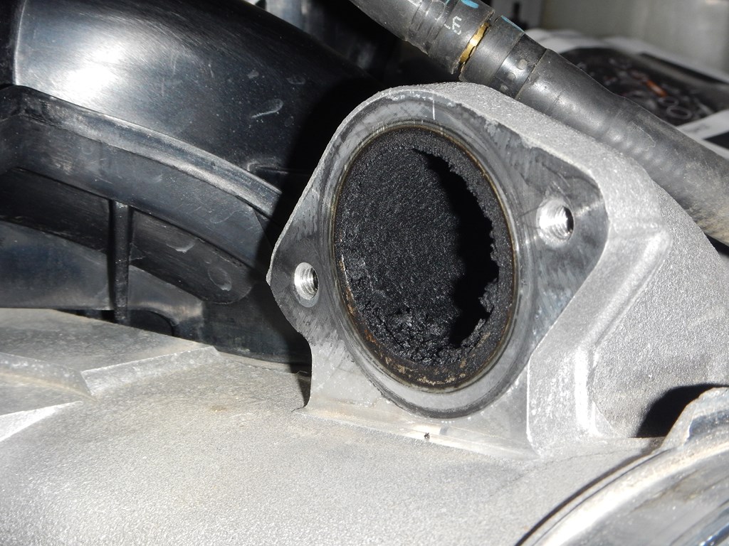

Yeah, this crud making it back into the air intake. Yuck.
Hopefully my truck is breathing a bit easier now. That stuff cakes on like it's cholesterol for your truck...

Thanks for the pics. That's some pretty funky crap in there.
I prefer loops rather than dead ends when it comes to fluids. Where I work, dead legs in piping tend to cause problems eventually. I think you've reinforced my thoughts about the Sinister kit.

Yep, exactly what I was talking about. The purpose of this hose is the coolant system is obviously pressurized and so with the caps, they can blow up like mine, or leak because of the pressure. The hose also circulates the coolant. Anybody sell their EGR Cooler? Also looking at all the EGR deletes out there, I would recommend the Sinister EGR Delete over all the rest, because of the hose. I don't personally like the blue look which is why I went with something different, but I thought the caps would have done a better job.
