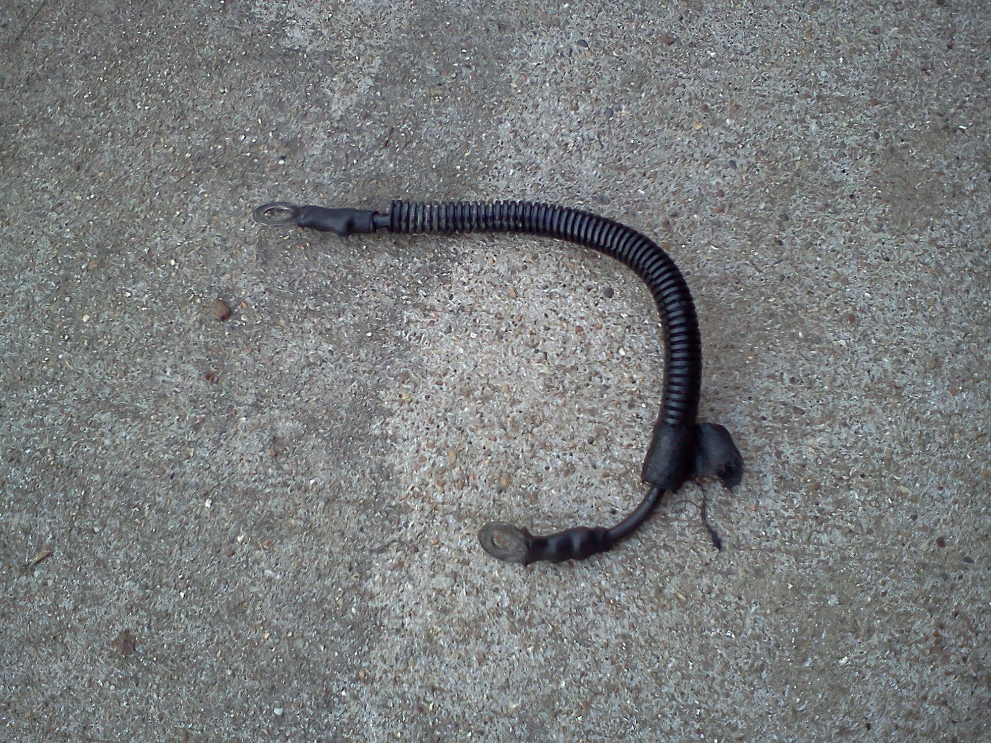

Well, it is done(for now). I have finished the install and started the engine(yea). I have to admit that as nice as it is to access the turbo from the rear I would still rather put this engine in a truck body. I have to aplolgize to everyone up front, I did not get any pics. I have accepted a new job in Nevada and have to report to work July 1st. So this is a rush job.
As time goes on I will be able to answer questions and maybe do a little better write up but for now I need to be breif and work through the issues. First off I have one part left over. I have always had good luck with putting things back together but this one has me stumped.
As you can see it looks like some kind of ground. Can't remember taking it off, can't remember where it goes. If anyone can give me some clue as to where it goes I would be very greatfull.
The next issue is that after I had run it for about 15 minutes off and on I took it for short 1 mile drive. I pushed the engine a little to get it warmed up and very quickly I noticed very large amounts of white smoke billowing out of the exhaust. At first I thought it was just burning off the oil from the build process but it didn't stop until I returned to the driveway and let it idle. The smoke pretty much goes away at idle. I started the truck this morning and there was not even a hint of smoke from the exhaust. Please provide any thoughts on where the smoke is comming from. My thoughts are turbo. I took the turbo apart last year and have a sneaking suspission that I either put it together wrong or the seal is shot. I did not rebuild the turbo at that time. I am going to remove the turbo and inspect to see where there is oil and where there is non. This may tell me where it is comming from.
Lastly does any one have a break in procedure for the 7.3? It has new pistons, rings, bearings, valves and a fresh bore.

This is what it says in my 2002 7.3 Owner's Manual:
"BREAKING-IN YOUR VEHICLE
There are no particular guidelines for breaking-in your vehicle. During
the first 1,600 km (1,000 miles) of driving, vary speeds frequently. This is
recommended to give the moving parts a chance to break in."
When I broke my 7.3L engine in I drove from Sacto. to L.A. on I-5 varying speed from 45 mph to 55 mph. But my guess it would be best to vary that even more, by adding in town stop and go driving.
I will look under and around my van this weekend and snap a picture if I can find where that ground goes. I am sure you have already looked at engine to frame, frame rail battery to frame, starter to frame, body to frame. You know that the body is insulated by rubber mounts from the frame, so that a ground is required there. The engine is also insulated by rubber mounts from the frame, so a ground is also required there.
As to the smoke, what were your symptoms prior to your rebuild? What caused your piston failure do you think? Are the inlet vanes on your turbo "dusted" from a faulty air filter box?
I don't recall, did you ever drop your steel tank to look for delamination?
