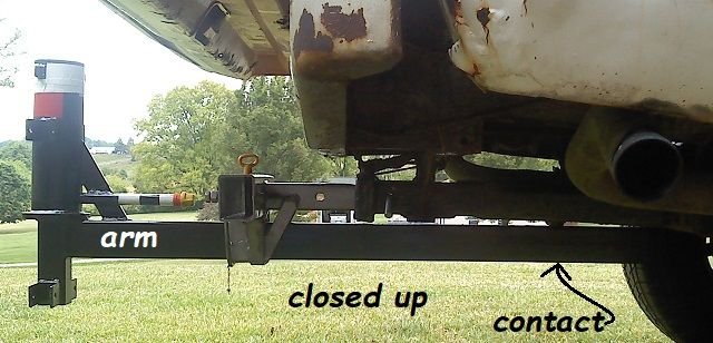

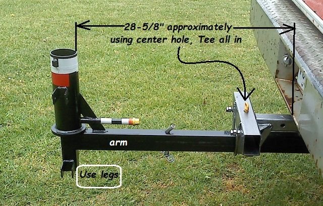

Back in the Fall I bought a MAXXTOW hitch crane, I made a few minor mods, now I can use it with my '07, my '77, or my trailer. It has three positions, the 500, 750, and 1,000 pound holes. I set it up on my '77 and on my trailer. I'll be a back saver I think.
As it comes in the box, it has a TEE adapter with three positions that inserts into a receiver. Then there is the long part I labeled as a TEE that has a 3" diameter tube on the end and ears for attaching the two adjustable legs that are intended to carry the weight. The vehicle supplies a heavy well anchored third leg. The thick walled square and rectangle tubes prevent twisting. The handle and back strap on the upright yellow boom part that goes up are additions I made to add some strength and give me a easy to grab hold. I added provision to fasten the TEE to the tongue of this small but really heavy trailer, it weighs easily 750 pounds empty, frame is 3x1.5 x 1/4" wall channel, has near 1/8" steel diamond plate floor, and besides the ends, has 5 under floor cross members and a 3,500 pound rated axle.. Railing is 2x2x1/8" steel angle. It has two couplers, the second allows me to dump it. You can see the TEE I painted grey metallic after adding extra receiver at 90 degrees to the long one. You see extra lower leg struts that I made longer and are adjustable to allow the legs to spread further if needed for a lower hitch like on my lowered '07. It uses three 5/8" bolts ... at both ends of the jack and at boom "hinge" but I made longer pins as do not really need bolts. Might add a pin for chain/hook moving, but I like the longer reach at 500 pounds. I'm going to add a couple pulleys and a worm drive $30 hand winch to the uprite I think. It sets up and takes down in minutes. In short moves like across the yard, etc, it can be left in place and just pick up the legs. Maybe even a few miles if boom is secured from swinging with ratchet straps. In longer transports, I would dismantle the yellow upper portion and lay the pieces in the truck. I also added a pipe to the lower base arm that you see with the yellow pipe cap for easy carry.
Updated late 01-17-2022:
I outfitted my HF-2500 pound hand winch (has a 25 feet cable) with a removable handle and added a 13/16 hex nut welded to the shaft under the handle, it really works fast and easy with a 13/16 spark plug socket on my DeWalt 20v lithium 1/2" heavy duty cordless drill, so I added a chain loop from side to side of it with a clinch hook so it can be hooked onto a pipe, axle, post, etc ... at will. It's fast and the drill doesn't seem to be working hard at all. Helps to have a helper pull cable hook while unwinding, but being cordless, can just hook to your intended load and walk towards the anchor point as reversing the drill, then hook it to hitch ball, etc.

It breaks down really easy and quick, is adjustable, think I'm gonna add a light easily detachable hand winch to it too. I even set it up in my basement on my Wheel Horse garden tractor. I can think of a hundred times I wished for something like it, but last fall a big pine tree convinced me. I ordered MAXXTOW MT70238 from e-trailer, had the best price on it then, below is a stock pic. I made some longer adjustable lower leg struts to let me use it if lower and I added a piece to the TEE to let me use it straight behind the pickup.
Of course, it would need the legs added. The crane yellow part has a 11-1/4" long large near 2" dia. solid steel shaft with two big bearings and it just drops into the round pipe of the base. In this position, the tailgate will open too. I can close up the mount so the tailgate is just a couple inches from the crane base.

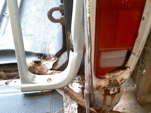

Well first we tried LMC ... it tore getting it on, too short on one side. Next was Precision ,... and a professional glass installer. He got three corners in, but wrestled with this top left corner for hours, finally called to see if he should keep at it or what, I told him I could wrestle with it later. Well I have a couple hours in it andd still no go, and the chrome mylar is already peeled like in places, so I have decided to just let him order a solid, no chrome strip one and try again. He said he liked them better anyway. I had gone with the lock strip kind first because was what was in it OEM, but then when the mylar goes south, turns white, looks like crap, not to mention it shrinks over time.
At least I made it look no worse.
The LMC was as good as the Premier it seems, the Premier might have been softer. Glass guy says there will not be any such issue with the solid Premier that he gets.
07-10-2022: Solid rubber is at the glass shop, Eddie is gonna do it in the morning after I drop the truck off. If I decide later that I want trim, I'll maybe stick a narrow bead of it to the glass next to the rubber. PS: He got it done and it looks nice.

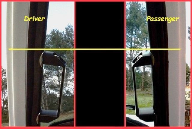

Originally Posted by tbear853

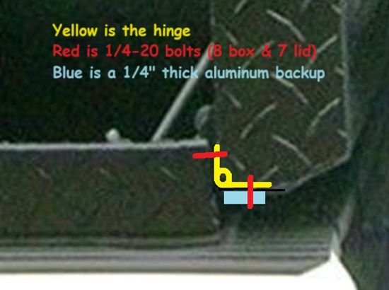

Today, I set out to fix my booboo ... first I tried single piece base plates, but did not like that idea as it presented a hard edge to the back of the hand ... so I took some 1-1/4" stainless washers with 5/16" holes, polished them after I bent the edge to conform to the weatherstripping, redrilled my low holes 1/2" higher ... it's fixed and I like the look with the stainless base washers ... and so does Wife. I have measured several ways from sundown, they are now equal.
Yellow is just a witness line. We had various clouds, the hood looks greyer when I took that picture, it was grey clouds reflecting. The other side, hood looks really white, was sun then.
A closer picture. These handles are on Amazon, are black painted aluminum. I run the top on a belt sander and then polish them. They have several sizes, these are the 120mm ones, middle.Amazon.com: PZRT 2-Pack Black Aluminium Alloy Handle Rectangular Industrial Pull Handle for 30 Series Aluminum Extrusion Profile Accessories 120mm : Industrial & Scientific

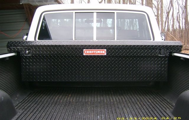

I was seriously thinking of pulling that old one out and refurbishing it, it's plain steel and seals are old, it has some rust in the bottom, and I'm thinking the new offerings, in a black, new seals, etc ... low top might be the way to go now. I can likely get one for what it'll cost to get mine painted anyway, and a good tough black in diamond plate would be OK.
Was just looking, looked several places, was in a Lowe's, looked at the Craftsman tool boxes, with my contractor discount, bought one that's all aluminum, matte black, just over 16" high, with only 4" above the bed rail. I'm not going to be hauling heavy tools and it'll look nice on my truck and give us extra space at times. It's light enough that I carried it into the basement, but it's still wrapped up. I figure I can easily empty / remove it if desired. It run me near $350. It does have linked handles so it can be opened either side, and it locks ... it even has two keys.
I thought hard about a "chest" type, but I do not want to drill my bed liner.
It came with four J bolts, nuts, washers, etc. My bed rails have round based chrome tie downs and 3-1/2" wide plasticized like rubber Rail Guard. I used a 2" hole saw to cut carefully placed holes, one on each side to allow the tool box to sit down and index on the secure tie downs, then the J-bolts (4 supplied) got some rubber added and they hold it down on the rail tops well.
I considered modifying this new box, but didn't. I'm gonna cut a piece of plywood for the floor, to lay over the aluminum ... but I can do it later. Might add organizing low walls, but not planning on tools, etc ... just extra space for like maybe groceries, veggies, my tire plug bag, camera bag ... when we are out so my Wife doesn't feel like she needs to pile stuff in her floor. I'll fabricate a bumper that slides under it and contacts the front bed wall, but keeps items like spare tires from contacting it at stops. There is 6-1/2" free space underneath. I didn't get pictures before dark, but the black diamond plate looks great on the truck.
Lowe's item number # 1053448 / Model # CMXTBAK1055301

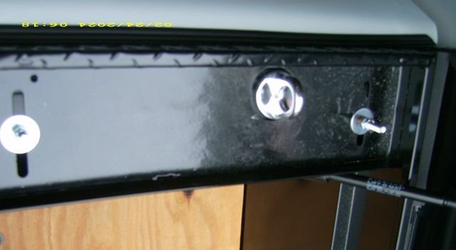

Before it rained today, while dumping the pellet stove ash pan, I took a few "done" pics of that light weight tool box. I figure if I only use it for extra room of temporary use, I can remove the 4 nuts on the J bolts and remove it in total if I need 8 feet of bed space. As it sits, there is 72-1/2" (over 6 feet) from the box to the closed tailgate's inner cover surface Things like old but still good RR crossties, a player piano, etc ... or ... I'll just use my "lower and easier to load" trailer. The '07 truck and '01 Merc pulls it too.
I think it looks just fine as it is. That's how 4" above the bed front lip looks.

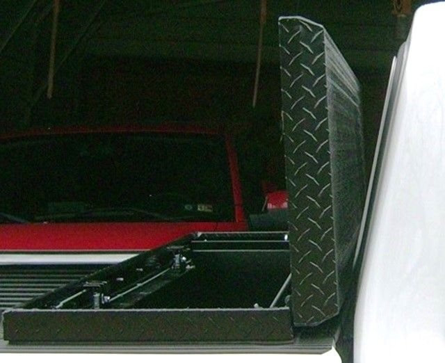

The 2" hole just lets it set down over the nearly 2" base of the chrome tie down. Once the two J-bolts are just snugged, it can't move and the lid if closed, covers it all.
Just pull a latch handle, the lid opens to here. I was worried that it might would contact the raised aluminum slider frame, so I mounted it what would be about 5/16" from the bed's front wall lip. I looks closer because I have a piece of black steel angle and a rubber strip between them, plus at least 1/8" of space. That steel has a "wing" on each end that attaches to the bed side lip too, I did that when anticipating hauling a motor cycle occasionally ... long ago. I just reused it last year.
Zip ties just use existing holes once used for heavy duty tie down loops, they hold the rubber in place. It has a strong high strength adhesive, but I like a well trimmed zip tie as security.
Look close, you can see the piece of split fuel hose between the bed lip and the business end of the J-hook.
This is the view from below of the front J-hook that conveniently hook on to some Eye bolts that were already there.. If look closely, will see a piece of 1/8" steel between the nut of the eye bolt and the truck's bed side top lip, it is welded to an angle that runs across to the other bed side, along the top of the bed front wall lip. The darker (it's not rust, it's a coating ... "something chromate" I think) nylock nut with two washers is what secures the chrome bed rail mounted tie down in place, those studs are lock-tite-ed into the tie down itself, and the tie downs can rotate with very little effort.
A hair over 6-1/2" tall space under it. Red & white "CRAFTSMAN" tag is well color coordinated ... I removed it once ... but then I put it back on.
I have a sheet of 3/8 plywood in the floor of it, 60" x 16-1/2", with a handle ... and I cut some industrial rubber bonded (from a "Georgia Bonded Fibers" local factory) carpet squares to fit in place in there on top of the plywood.
