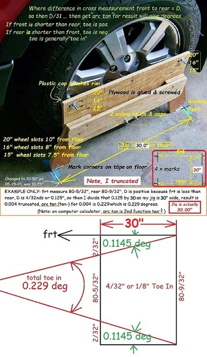

I'll bet so! On a 4wd solid axle with the long parallel tie rod they do work great as long as one doesn't mind some jacking and wheel/tire removing. Not so well with independent suspensions though as the vehicle weight affects the suspension height and tie rod angles. I once had a set of angles like that, but I haven't seen them in years. I may have repurposed them. They do work.
I made a jig to set up against the wheel lips of 15 and 16" and 20" wheels, it has plastic tips so it will not mar the wheel lip. I use it with my cars and my '07 that all have alloy wheels. I have a level area, like my car port or the shop room. Pull in, and set the jig against each side, and place tape on the floor that I mark. Then back away and measure directly on the floor with a 6 foot rule I have, or a tape measure. Then I adjust and try again. I don't use it with the '07 as it has rounded deep dish beauty rings that I'd need to remove and those steel wheels would probably do OK. Very rigid and if by chance there is a twist in it, it self cancels out when used on the other side. The math is not needed unless relating inches to degrees.
On my '77, the tires on it have straight treads and very well defined straight grooves that run true when spun, so they make for reliable locations to measure from / to.
