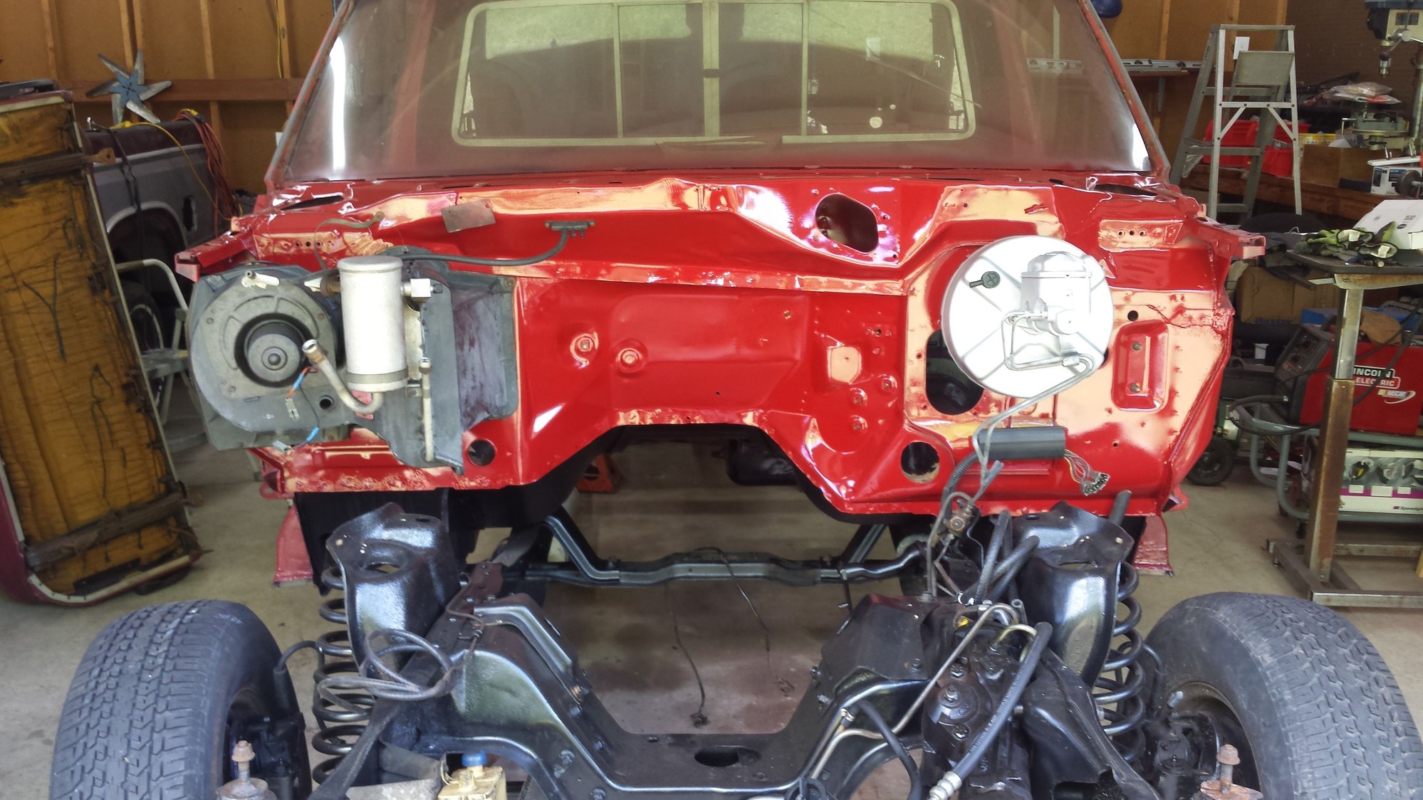

Well, it's a decision that's been pestering me. I did a lot of work between stripping two trucks, a '73 F100 and a '79 F150 Super Crew of their AC parts in two hot, stinky, bug infested junk yards in 1986, one was free, one I paid the man $100 for stripper rights. I took the dash & instrument cluster too.. I only did it because funds were tight and we were wanting to save to build a home and yet, I had bought this '77 F-150 that was a really nice 35K mile 4x4, but it had no AC. Her Dad had a '77 F250 without air, he did OK. Was a day Wife and I took the truck over to my parents, across the Blue Ridge Mts. We darn near melted, it was hot and NO air come through the vents. Few years later I learned it was because of that cool looking red tint bug shield. Her Dad's had no bug shield.
Anyway, I spent a week of spare time after my shifts making the swap after marking the firewall using a piece of cardboard I had made a template from in that '79. I had sat in weeds infested by ticks and spiders, with a .22 loaded with snake "medicine" just in case to make that template from that '79 firewall. I think was July or August by then. I also removed my dash to create those holes for vents exactly where they were in that same '79, but I brung the '79 dash panel home. I did not use it because it was green. I had sorted my pieces, decided on the '73 heater core that did not leak with air on it submerged in a water bucket, and the '73 controls with the AC script, but used the box and exp. valve and evaporator from the '79. I used the '79 hoses too, but bought a new dryer and condenser and I used the '79 compressor and mounts (it had a 400) . I do have the '73 compressor & idler, but not the mounts (it was a FE).
R-12 was cheap then, and after pulling a vacuum, we were charging it and a weld blew out of the dryer, but NAPA had one in stock. I got the condenser in just by removing the hood latch and brace for the grille. Was a plate over the hole I needed in the radiator core support. AC worked great for a few years, was still good when we took it to Vermont to get a old Triumph MC in 1994 still, 760 miles each way. Sometime after that, over time, it lost it's charge and I just was not driving it so much on road trips. I doubt we'll take it on any more long trips now either, maybe 100 miles one way to visit family.
I'm gonna need to replace the front shaft seal at least on the compressor, I need to replace all the O-ring seals with green, I'll need a new drier, I'll need to replace or at least flush the condenser and the hoses and evaporator. I think it OK to go ahead and close off the valves at the compressor and remove the compressor to in my shop, I'll clean it up and replace that seal, put in ester oil. I think I'll secure the hoses all over the brake booster pointing downward, ends covered well, I can flush them and the evap core and exp valve, or replace as needed there / then. I might spring for 3 new barrier hoses. I can pretty easily get the condenser out to flush it, and the drier for replacing. Then, when everything is cleaned up, put all that back together, but retain use of the truck in the mean time. Once it's all back together, I can pull a vacuum on it. If it holds vacuum then,... then I'll get Roy to charge it with the R134A.
Right now, there is no pressure on the system, the belt is off, the compressor clutch is unplugged, but the compressor turns easily by hand and the pulley spins really smooth. I recently rediscovered it can blow cool ambient air through the vents, just by correcting heater valve operation, it's comfortable enough..
I wish was room for an auxiliary electric fan ahead of the condenser ahead of the radiator, maybe two smaller ones ... one each side of center? Maybe something like 10"?
I did wire in a toggle switch to also put power to the compressor clutch without having to use AC, it really made the defrost function work like "right now".
I gotta check for charge quantity too.

My 81 F100 did not have AC but my 81 F100 parts truck did and was bought becasue I wanted to swap it over to my truck.
Like yours the 80 to 86 trucks have different firewalls between non-AC and AC.also.
My fix for that was to replace half the firewall.
Yes it would have been easier to just cut the 3rd hole but what fun is that
The only thing I reused was the evap coil and the high psi hose other hoses & drier was all new when I got my system back together.
I bought a used compressor as I had none so needed something for a core but I used it.
It was a little noisy but worked.
Then had the clutch burn out so replaced it.
Shortly after the used compressor stopped working.
That is when I replaced with a new one and also replaced the evap coil.
Before that I was fighting leaks from being a dumbazz and not going back over my work (loose fittings).
So far from end of last summer it has been working great and cools off the cab in no time.
I would say if you have the tools, vacuum pump (rent?) and gauges, it is not hard to recharge the system.
Good luck on getting the AC going
