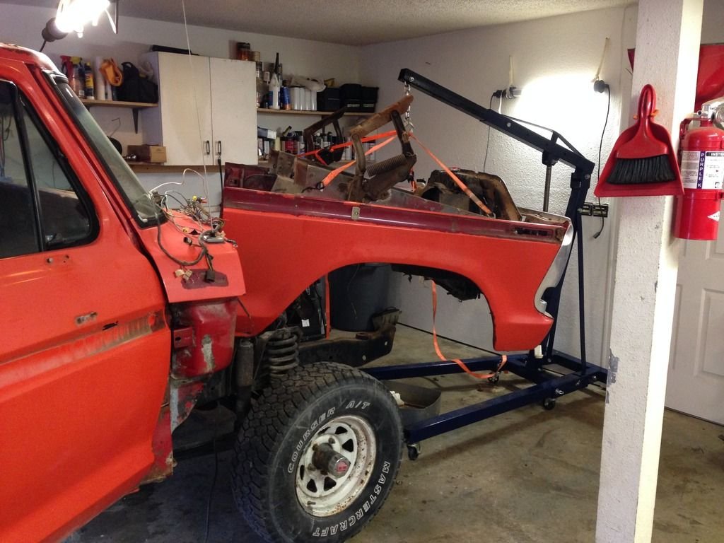

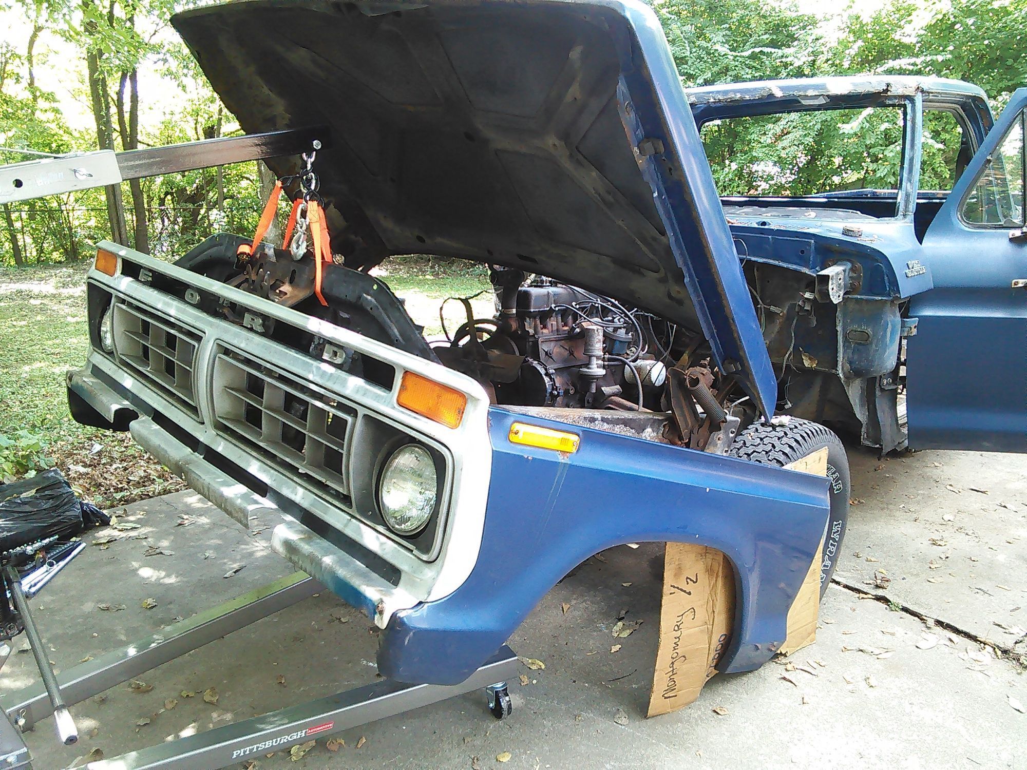

I will never pull a complete motor again WITHOUT pulling the complete front clip. 14 bolts, a little ect...and done.
I'd rather set on a tire than lean over a fender any day.
Old Jun 14, 2022 | 09:34 PM
77&79F250's Avatar
77&79F250
Moderator & parts slinger
Posts: 50,189
Likes: 5,793
And...this may seem out of sequence but before taking your truck apart.... ALIGN THE BODY PANELS! When you're satisfied with gaps and positioning, drill 1/8-inch alignment holes at hood and door hinges, brackets, and at body panel overlaps and flanges. Or sharpie mark them, the door and hood hinges if you are going to pull them.
For example, this is the cowl to inner fender bracket and it is adjustable vertically and horizontally. Therefore two holes are required. The same applies to the hood hinges. Insert the drill bits to index the part and bolt it down... it is EXACTLY where it was before removal.
If you don't like random holes, the hole(s) can be hidden under the washers. I just dab and wipe a lil black RTV to seal it up. Or before pulling the hood or doors, scribe or sharpie the hood hinge position (all the way around) on the underside of the hood. Pulling the doors, scribe or sharpie the hinge placement on the cab, leave the hinges on the doors.
Front clip take off 101 https://www.ford-trucks.com/forums/1...l#post14696880

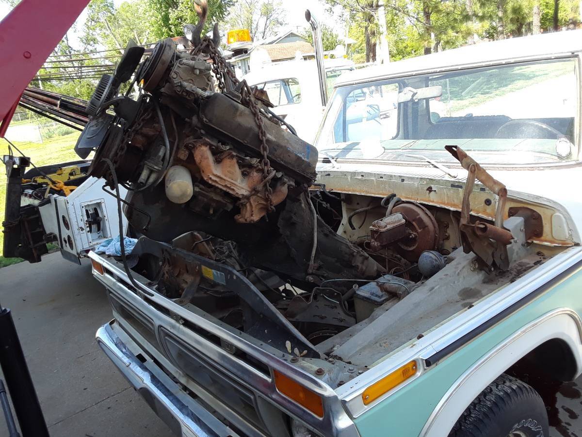

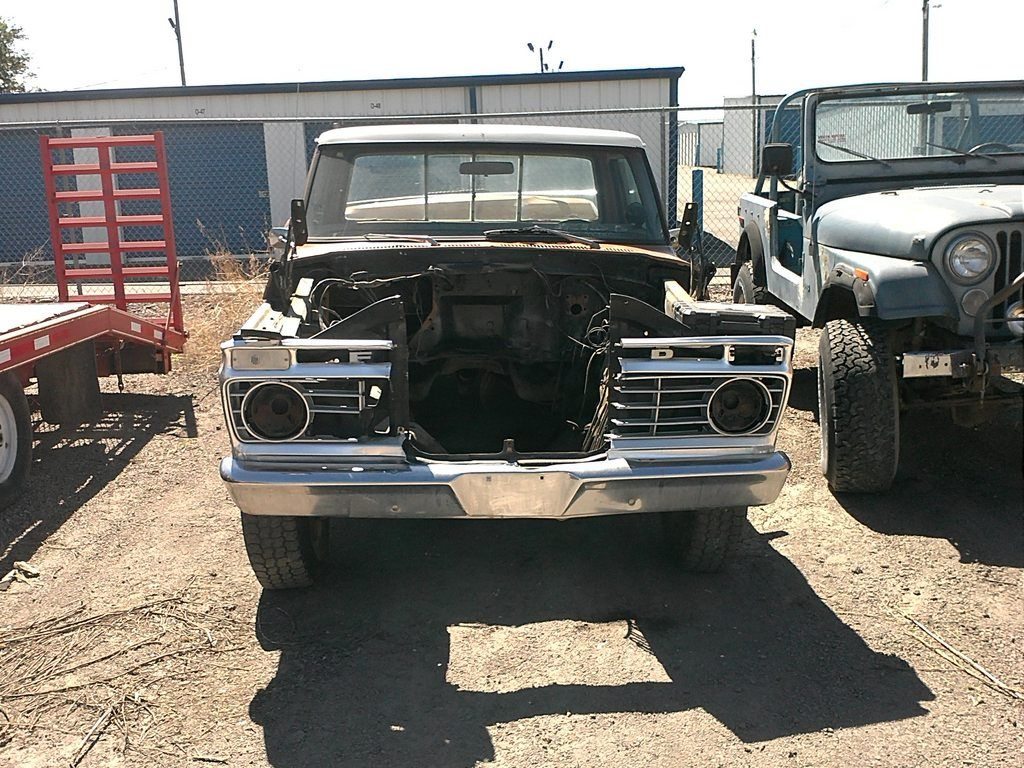

I just had a new idea looking at you pics, besides pulling the radiator, just pull the front bumper and grille and then just fab a removable section across top of radiator support, don't lift it over anything ... bring it straight out through the radiator hole. I don't have many close by that I'd expect to help get a front clip and hood off without damage.
Old Jun 14, 2022 | 09:44 PM
77&79F250's Avatar
77&79F250
Posts: 50,189
Likes: 5,793
Note to self... this is NOT the way to do that. You can do it with a cherry picker all by your self. These FTE folks got it going on! Or more like coming off!
