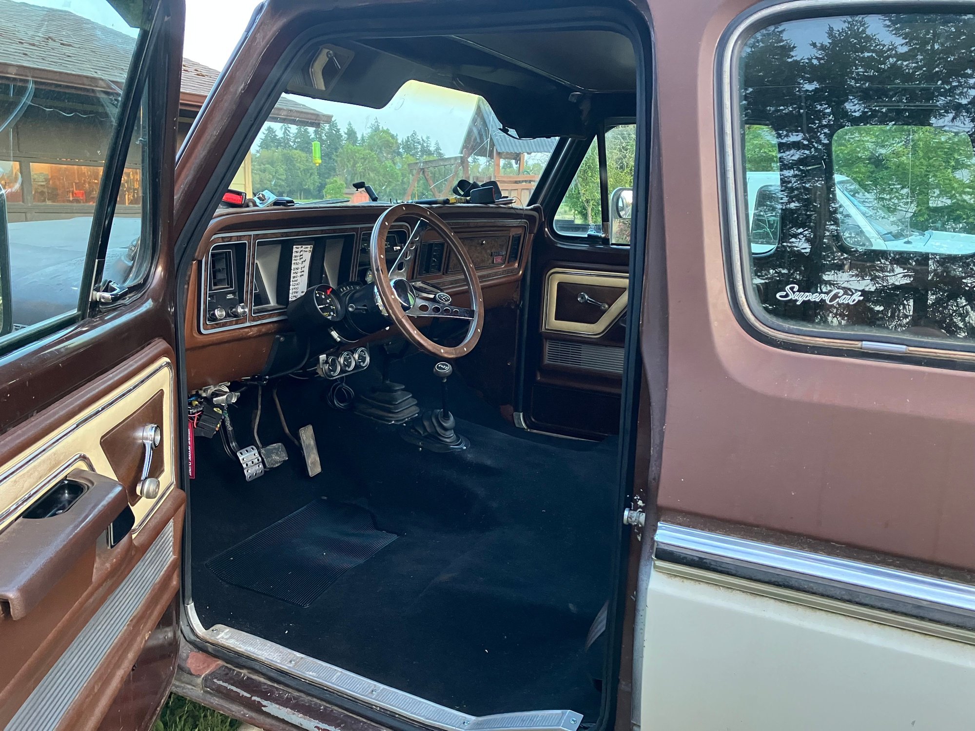

Old Jan 23, 2026 | 06:54 AM
motorsickle1130's Avatar
motorsickle1130
Joined: Dec 2012
Posts: 321
Likes: 177
Bummer. Mines not too bad, but same thing with the cancel.
I even replaced the entire turn switch (twice actually; expensive way to find out I’ve got a tilt column, that doesn’t even tilt) after my youngest was reefing on the turn switch lever.
I ended up having to make a spacer to keep the adapter hub from grinding into the face of the switch, and be able to get the wheel snugged down and not lift.
My right turn dash indicator is still not working, even after a cluster rebuild (circuit board and poor contact I suspect).
Mostly worth it though, and probably the nicest part in the whole truck:

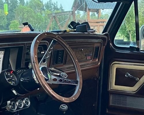

Well, you're right ... and I love the thick rimmed Grant wheel's feel.
I have the one adapter that's on the wheel now as it hangs. I have a new spare alloy adapter that came when I found the smooth chrome horn button with chrome skirt NOS set. Knowing me as I do, is a good chance I'll revisit it, maybe create a steel girdle to keep the adapter from cracking (though the SS screw drive hose clamp seemed to stay tight, I can weld up a fixed press fit one), and I had massaged the "ramps" on the springy arms of the cancel cam to get them to easier engage the roll pins, so that it really worked good,
I noted how the OEM wheel uses a tight fitted ring with smoothly formed ramps, not sudden roll pins to tickle the springy arms to cancel. Maybe some carefully sculptured JBWeld would make smooth ramps?
Latest "downer" was the "iffy" horn operation, even with the extra contact plate needed because my Grant wheel spoke set is painted or powder coated black, not chrome. Maybe a thicker or second plate** (in place of... or ... with ... the metal foil they use) for the horn contact ring to contact before the chrome cap contacts the coated black spokes where they bend as they create dish.
Yeah, I can see me trying it again.
To update, 01-23-2026 ... I put the Grant wheel back on today after working on the horn button area to get a reliable- consistent activation .... was the chrome cap needed a little finessing where the curvature of the spokes caught it before the contact plate could contact the plate on the wheel itself. Also checked and I found that I do have a spare "still new in box" adapter kit. So now, the OEM wheel is hung up there on a nail.
01-24-2026: Pretty cold out, but I did cut and drill a piece of nice stainless steel sheet to get a 3" OD extra plate mentioned above (**), I am sure it will work.

Oh no doubt just shading it was the trick. Just lay a chrome plated Snap-On tool on the inner fender in the hot sun for a spell.
I used this, and it matched my new adapter really well. The stainless sheet I used was some bought 30-40 years ago, is at least as thick as aftermarket body panels, my biggest snips didn't want much of it, so I cut close, then used a disc sander to fine tune my cut for the larger OD. A step drill did the center 3/4" hole, titanium bit did the 17/64" holes where is marked 1/4", and used a 3/8" bit for wire. The stainless will ground through the bolt shanks and center big nut. The 3 bolts need to pull the plate down snug. I also have some longer 1/4-28 bolts with heads cut off to loosely thread into adapter to alighn it all, then replace with the correct kit bolts.
It'll reduce travel the horn button has to go to contact and cause the beep beeps.
Looks like my drawing has the vertical center line a little right, but numbers are right. One can trace it by using the lower beauty skirt flipped over.
Next time I'm there, I'll get a picture.

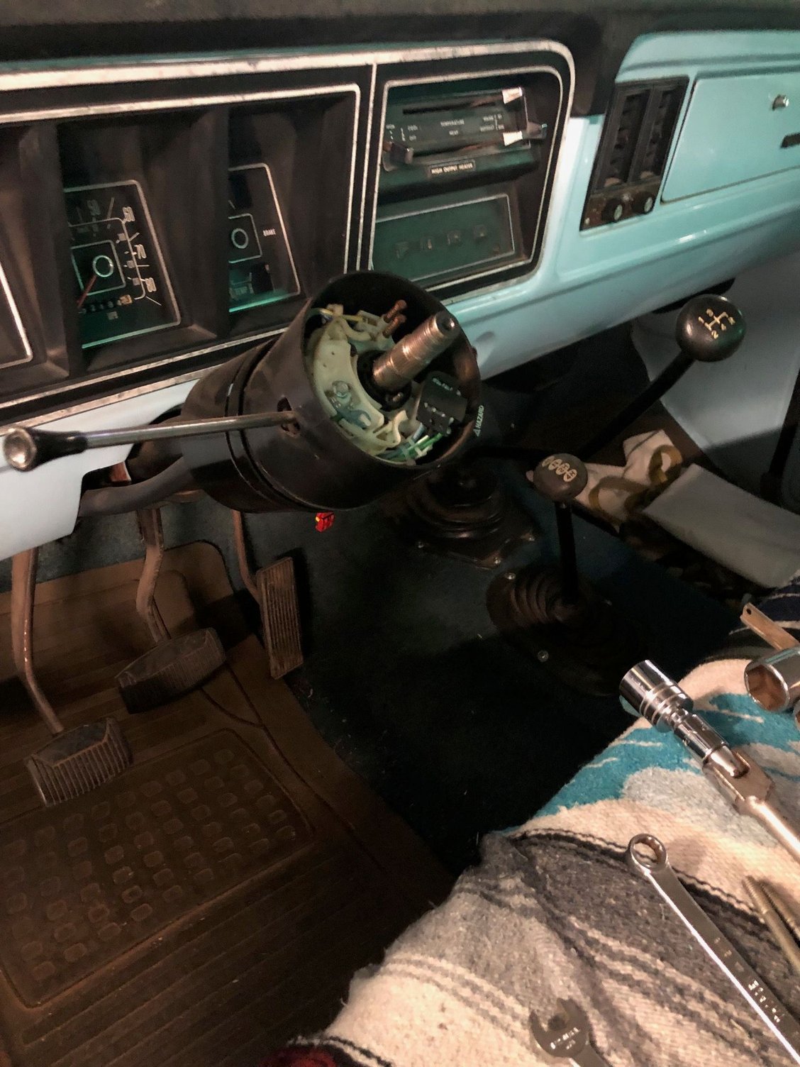

Ok, below shows the Full-Sized Bronco TILT COLUMN and the turn-signal mechanism.
I replaced the broken turn-signal cancellation piece with a Dorman part from Napa.
Above photo - showing the Tilt Column from a Full-Sized BRONCO.
Like mentioned above, the Turn Signal cancellation cam pieces were replaced with a Dorman unit from Napa.
