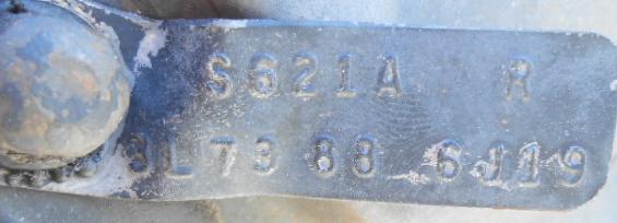

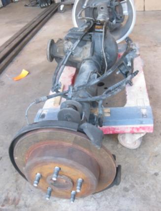

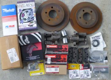

Fire up the Tig. Next project: 8.8 3.73 LS on big tubes, plus rear wheel discs.
This brings the rear brakes up to par with the Exp fronts.
Known mods required:
- Width after combining with 44ET Exp wheels
- Spring perch and links
- Parking brake connection
- Master cylinder swap
This is a 3L73 which can still be driven by the 3L but is perfect for the 4L sohc.

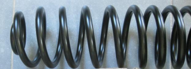

I will finally install the springs that were fabricated to my specs a while ago.
Wish I had these springs while I was doing construction.
They keep the rear end at about stock height while an additional 450lbs is loaded onto to the rear axle.

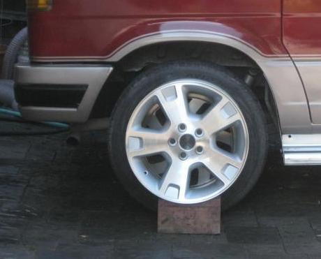

omg those wheels look great on that! can we get a full pic of them? (sorry to be slightly off topic)

* Wheels are std Exp 2002-5. Widely available. Warning: Offset is substantially different from aero & early exp.

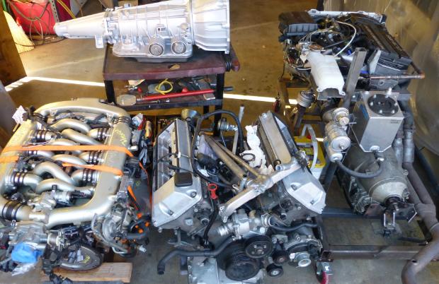

* Still shifting between V6 engine plans. A Vulcan make-over, the SHO, or the SOHC. Fyi, a 3.2 SHO was brought in but might get either torn down for the Vulcan make-over or get tossed in favor of the 4L SOHC. Well, at least I've killed the V12 option. Fall '15 time frame.
* I'm having an ongoing struggles with my A4LD frankentranny, so I'm bringing in a 5R55E for a plan-B path. Regardless, the tranny shifts will need to be adapted to the final engine plan. Likely I will do a custom controller to be shared with a parallel 722.6 tranny project for my MBZ. Summer/Fall time frame.

The decision is to go with the SHO 3.2L DOHC. It's in my garage already and looks pretty, otherwise I would do the 4L SOHC.
In the short term the SHO is a built-to-tour engine. 220 bhp & 215 ft-lbs, 7K redline, forged crank and pistons.
Next year I will investigate transitioning it to built-to-tow.
That requires knocking the compression ratio down a bit and installing twin turbos. Targeting 260 bhp & 280 ft-lbs.
***** Follow-up *****
Originally Posted by RojoStar
Nope, I'm throwing this one back.
After due diligent research with an engine and vehicle at hand, I'm bailing out of SHO. I found about a dozen annoyances with the swap.
None of them are insurmountable, but the top three combined put me beyond my pain threshold.
Life is short and I have other options. On to the SOHC.

- 17" wheels. Couldn't sell the 15's and 16's, so they were tossed (!) during shop clean up.

- Explorer axle swap. Was tossed during shop clean up. Would have been difficult and risky to modify, to length and with Aero mounting points.
- Rear disc brakes. Retained from explorer axle, but probably won't bother.
10" drums are sufficient and a swap would be complicated.
Explorer pieces were salvaged from the axle, and Aero-axle retrofit brackets were developed.
Also collected a master cylinder and bias valve.

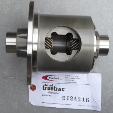

- LSD refresh, with helical technology vs orig clutch pack.

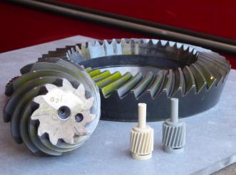

- Gearing swap, from 4.10 to 3.73. Now turning approx 2200rpm @55mph.

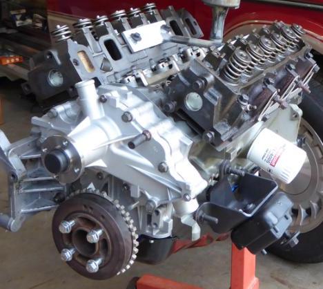

- Vulcanstein engine. A refresh and torque upgrade to the standard Vulcan.

- Rear springs, to boost rate, reduce sag when loaded. Pic is of an attempt, but failed the dimensions of the pigtail ends.

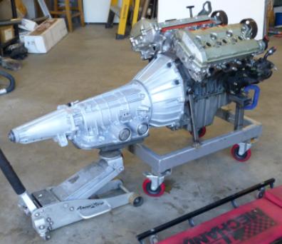

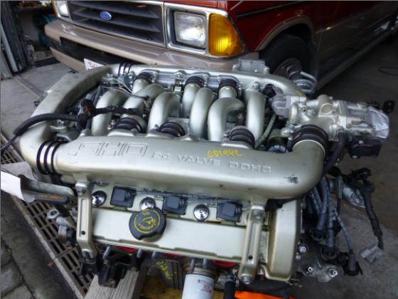

SHO, shown with 5R55E.

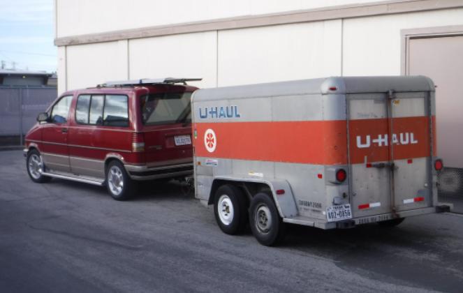

Test rig...

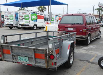

From U-haul @$19/day, a "5x8" (actually 5x9) open. Says their docs: 1000 lbs empty.
900 miles over 2 days on flat interstate and gentle rolling state highway, some casual Los Angeles traffic.
Loading added 250 lbs to trailer, plus 1000 lbs cargo to van, minus all seats except driver (iow's minus 400lbs from std curb).
U-haul Inc has the standard curb at 3400 lbs (I've heard elsewhere 3600).
So with 170 lbs driver, net combined mass is 3400 curb +170 driver + 1000 cargo - 400 + 1000 trailer + 250 cargo = 5420 lbs.
This compares against 8000 lbs limit, for 3L engine & 3.73 diff & (tiny) trailer area, according to owners manual.

Vulcanstein is a fresh build from new or NOS pieces, including the block.
Block is 1992+, with roller lifters.
Crank is 1995+ for diminished NVH.
Pistons are from 2002, giving it slightly higher compression.
Matched injector set.
Fresh plugs, etc.
Noticeably smoother, stronger.
Smooth operation is appreciated because, when towing on grades, it might be necessary to run near redline for extended time.
No ECU mod required.

*** Side SHO ***

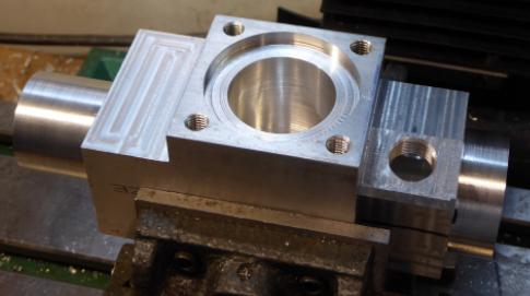

Following the initial reject notice, development continued, prototype pieces were fab'd to solve the half dozen issues.

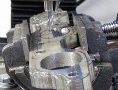

My logistics problem has been that the machined parts are complicated, take several days on my dumb mill.
Had to set the project aside because I could not iterate and precisely converge the design, then fabricate for others.
Am waiting to set up a better machine shop with CNC equipment.

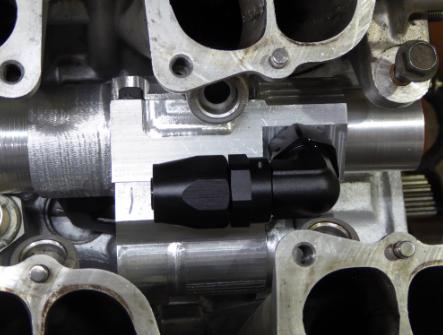

Thermostat manifold, manually machined by me
Test fit into the SHO valley.

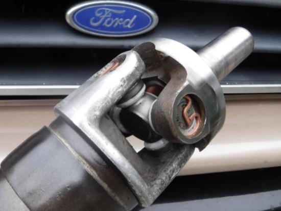

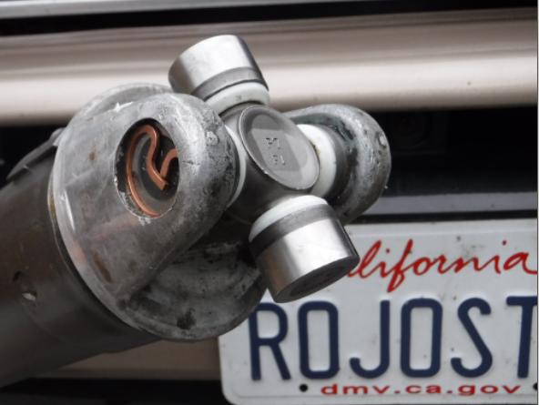

My last towing adventure...
...killed my U-joints.
At the end of the trip, it was like driving on corrugated concrete.
Gave my local shaft shop the shaft.
Spicer joints plus balance, $160.
Best money I've spent in a while.
The van is now much smoother and quiet.
Old Feb 8, 2020 | 12:03 PM
  #44
xlt4wd90's Avatar
xlt4wd90
Joined: Sep 2003
Posts: 7,015
Likes: 208
From: SoCal
Rojo, I was wondering if you ever did anything to enhance the stock transmission crossmember? Even under normal load, the bushings get pretty stressed. So if you're towing, do they get destroyed?
Old Feb 8, 2020 | 10:03 PM
  #45
RojoStar's Avatar
RojoStar
Joined: Aug 2009
Posts: 402
Likes: 16
Nothing to enhance, but I was up to date on bushing freshness.
No troubles to report.
This is also an important point about maintenance.
The towing session did not suddenly kill my U-joints.
First I drove a quarter million miles over 30 years, THEN the towing session killed my U-joints.
Wish I had a camera at the shaft shop.
The tech gave the joint a wiggle, yanked it apart using no tools, dumped onto the counter a pile of black dust and needle bearing fragments.
"There's your problem, dude."
He probably does that same routine to a dozen people a day.
So everyone, get your U-joints refreshed and shaft balanced.
Solved a lot of seemingly unrelated noise issues.
