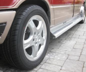

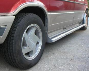

My Aerostar gets 17" inch wheels.
These 17x7.5 with 225/55's are a +3 from the stock 14x6.

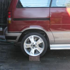

In the rear, a 5mm offset would put the 225's fender flush but this is not recommended because it would not allow much load on the soft stock springs.
Instead, target 10 to 15mm for 225's and this should still allow enough clearance inside for chains.
For 235's, grow inward to the 15 to 20mm range. Maybe still good for chains, maybe not.
The Aerostar was not designed with wide tires in mind.

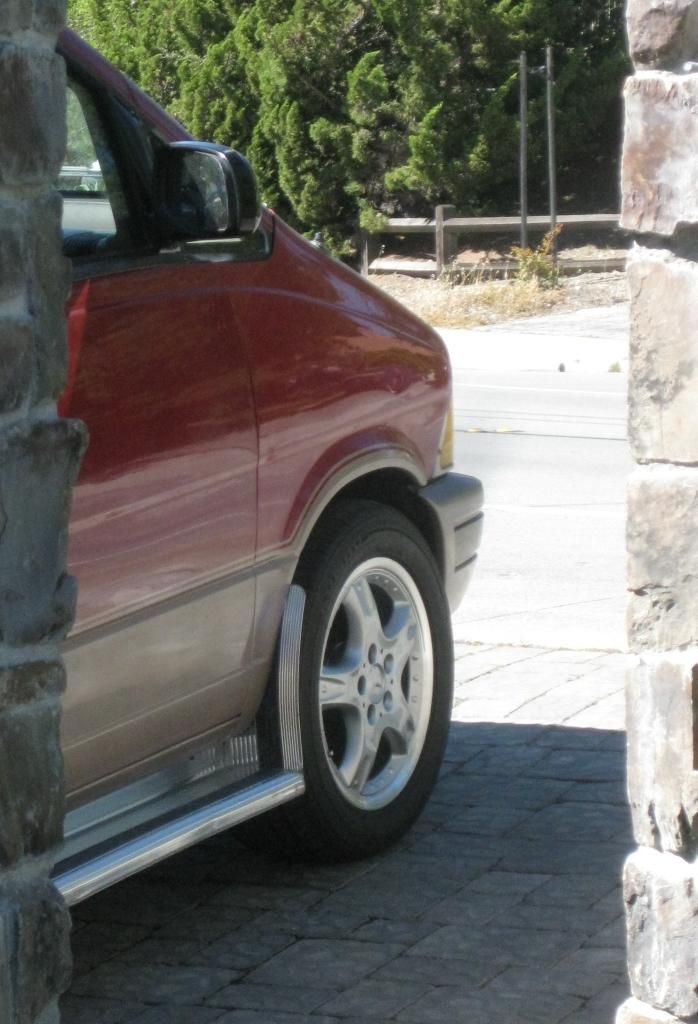

In front, a 15mm offset put the 225's just slightly outside of fender flush, but the running boards make this perfectly acceptable.
This offset leaves 5mm from tire to the ball joint holder, constant thru all steering angles.
Fender clearance was 3/4" at the rear, 1-1/2" on top and plenty up front.

While restoring the van including new paint, I wanted to pull forward the tire/wheel combo into something more contemporary than my current 15x7 Gen2 explorer wheels.

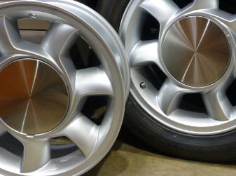

Then while researching spacer/adapters it suddenly it occured to me that I already had four 17" wheels in deep archive that were in a look consistent with Aerostar SportVan.
The big oddity is that these are a rare wheel option from the Mercedes SLK bin and were earmarked for use on my Mercedes 190E-16V.
Doing the math it was more cost effective to adapt these MBZ wheels rather than procure a set of Ford 17's.
Custom engineering by Motorsport Tech (in Sparks,NV) translates between bolt circles (ford 114.3 v mbz 112) while pushing the offset out from 37mm to 12.
For tires I settled on Kumho 225/55-17 Ecsta LX Platinum, front/rear.
These combine All-Season/Touring with at least some snow/ice skills.
They won't win any fashion contest but they do get good reviews from touring types.
These are load rated 101W.
I was borderline 235 for the rears which have a 103 load rating. May go there someday.

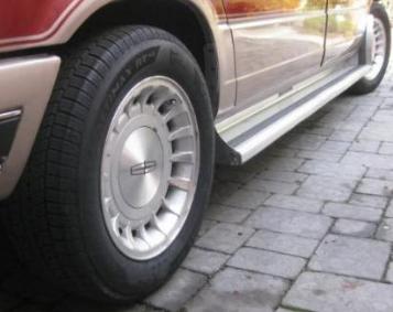

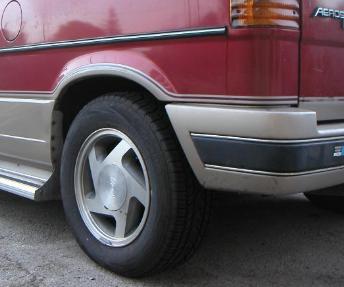

Was 15x7 Explorer Gen2 with 215/65:

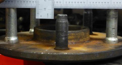

My rear adapters are both hub-centric and wheel-centric.
It was later found that my wheels are so tight around the bolts that the wheel-centric lip was redundant.
This feature also prevented their use on the front axle where the long hub extends all the way thru the adapter and into the wheel.
Fronts are full bore hub-centric only and actually cost less than the full feature rears.
Cavities in the wheel allow use of the original lug nuts. Otherwise, shorter nuts could have been used.

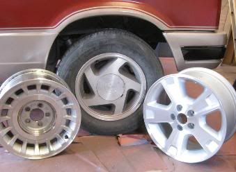

Here are the other candidates.
IIRC, the Lincoln Town Car 16x7 is in the correct offset and needs nothing. Good if you like dish.
The late Explorer 17x7.5 has a high offset (44mm) and that's the reason I had researched adapters. If I didn't have the mbz with its "cute" faux 3-piece bolts, this is where I would have ended up. Compared to the mbz, the Exp Gen3/4 looked a little ordinary but it's personal pref.
17x7.5 Explorer Gen3/4
The 16x7 Ranger Sportrac version of the Explorer style

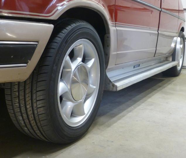

After getting 17's on there I find them not all that radical.
The 17's didn't take me as far into "sport" as I thought they would and instead look typical, normal for a vehicle this size.
Perhaps 18's are required for the sport look I was targeting.
Noteworthy, the Aerostar did start to lose it's identity and so the conclusion was that the identity is somewhat tied to the smallish stock tire/wheels.
After this visual update to this less common older van, most people would not realize what they are looking at.
Out on the road, there really isn't a comtemporary comparison to the Aerostar Sportvan but the current crop of compact/crossover suv's provides an indication of where wheel size/style/marketing is at.
For instance '13 Escape has an (omg) 235/45-19 option for the terminally fashionable. Uh, try that one off-road.

Yesterday I put in about 40 miles on the new setup and have a few things to report.
First no immediate technical difficulties with fit.
Second, responsiveness: there is a much closer coupling between what you want to do and what the van does. If you don't want to go there, don't even think it.
Third, you will get to know and remember your local road surfaces, wondering why the city doesn't fix these roads suddenly gone bad.
The good news is that I nailed the fronts.
The rears, not so. Although fender flush may look cool, its impractical and they need to come inboard a little.
Also, the rears were done in 225's and it should have been 235's for the ultimate bling impact.

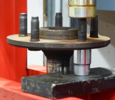

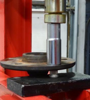

The tire&wheel combo in the pics above traveled only about 40 miles, then the front hubs were modified to Explorer brakes.
A second run of hub compatible wheel adapters failed to meet critical contract specs, then disappeared down an RMA hole at Motorsport.
Speaking diplomatically here, after months of vendor's non-action the loss was finally written off.
I could round up another vendor or do the machining myself but I've got dozens of other projects going on.

**** The wheel adapter supplier used in this project, ****
******** Motorsport Tech of Sparks Nevada, ************
***** is hereby removed from my Approved Vendor List *****
Background: Over a 30 year span I've worked with perhaps 2000 vendors in various nooks of engineering, manufacturing & construction
and this one stands out. If the owner/operator EVER gets around to returning money, I will be shocked and surprised.

Instead I've been running around for all this time on Lincoln Town Car's with 225/60-16's.
Still yearning for a more contemporary look, two and a half years ago I acquired the wheels featured here.
These reps are knock-offs of what you can find on a 1993 Mustang Cobra (fyi, 5.0liter, 235hp), except these are for 5-lug hubs.
The distributor of these reps is out of Katy, TX. Produced in China iirc.
I liked the flush face, hidden bolts, twisted turbine.
Some of the same styling ques as the orignal Aerostar EB's.
These wheels do a one-up on both the Aerostar and my Explorer 15 wheels by giving you a leftie and a rightie.
Explorer, left & right. One of these is backwards.
People roll their eyes, chuckle, walk away.

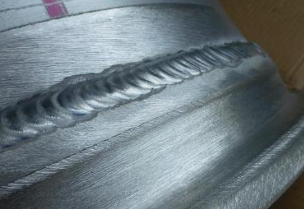

Up front, they are simply too wide.
These reps, with an ET of 29.5mm, are too far inboard, colliding with the upper ball joint holder up front.
Problem 2 is that I wanted to stay with a 225 tire width.
At least in the round-shoulder General RT43, that width worked on the LTC's.
That section width does not encumber turning radius, and had only minor sheetmetal contact, until I gave it more sway bar and damping.
However, 225's on 8-1/2 inch rim width is a bit of a stretch.
The solution was to have some Livonians narrow the front wheels by 1 inch to a net 7-1/2 inch making them the same width as the MBZ's attempted 5 years ago.
Since narrowing takes material off the inboard barrel, the (centerline) offset then moves outward by half that amount.
So now the front offset is 29.5mm minus 1/2 inch equals et 17mm.
They are then wrapped with 225/55's.
Lol, these are the exact ones hauled off the van 5 years ago after putting on 40 miles.

Instead of stretching 225's on 8-1/2 inches making them look stupid and oddly different from the fronts, we went staggered and now have 245/50-17's in back.
The stretch/bulge is therefore the same on the 7-1/2in fronts and 8-1/2in rears and so is the diameter and alignment to the sheetmetal.
They look identical except that the rear width extends inward.
The clearance is not chain friendly, but I was willing to trade this away since I only extremely rarely see snow.

* A little fine tuning with thin shims brought the final ET rear to 26mm, and leaves us with 8 threads left on the studs vs the original 10.
Front also got a 3mm shim.
In other words, the re-engineered wheel dimensions where almost spot on to application requirements.
* With the rears staggered AND with my recent permanent refresh of the limit-slip, the chassis tuning could stand for a beefier rear sway, to get back to shed some more understeer.
Currently on Hellwig 7/8, would have to migrate to the Addco 1-1/8, assuming both are solid, same tempering etc.
*** In summary ***
Style: '93 Mustang Cobra, but in a 5-lug
Front: narrowed to 17x7.5 et17, 225/55, shim 3mm thk 70.5mm bore
Rear: 17x8.5 et29.5, 245/50, shim 3mm thk 64.1mm bore
Tires: Kumho Ecsta LX Platinum, grand touring.
Very little clearance, might not be chain friendly.

Unfortunately that blows my drop-dead budget for threads, forcing me to haul the axles out and migrate to longer studs.
2 tons going out.
6-1/2 tons going in.
Another 10mm of thread, against 10 millimeters of shim equals no change in the thread count.
The new studs have a shoulder section about 0.010" larger diameter than stock, so I run a file briefly before installing.
And the shoulder section now extends into the drums, requiring that the drum be drilled slightly to accommodate.
