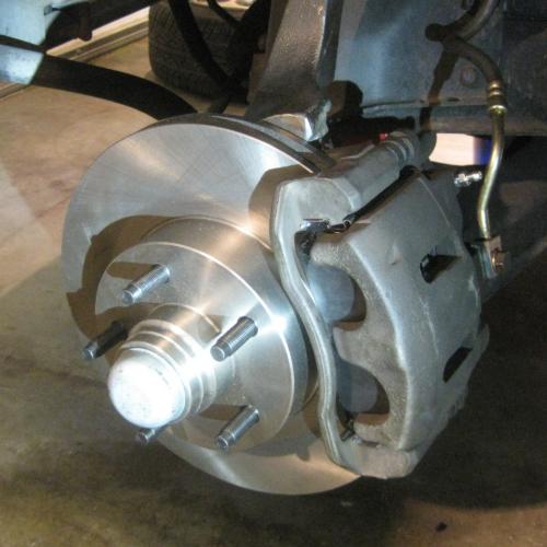

News from the front
Originally Posted by RojoStar
...Exp2 11.28" rotor/hub, on the stock Aero spindle sleeved out to 1.375 to match the Exp2 inner bearing...
Sleeve done. That's the larger Explorer inner bearing on the modified Aero spindle.
...Caliper mounting ears on the Aero spindle get chopped/welded/drilled to bolt up the Exp2 calipers. Seems quite doable...
Here's the larger Explorer hub/rotor mounted on an Aero spindle.
See the separate thread for project details. Explorer brakes on Aerostar.
