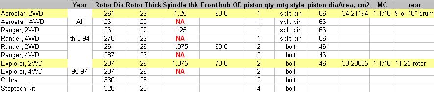

I've got a spreadsheet going on spindles and brakes.

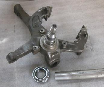

We are looking for 1.375" front spindles from the Ranger2 '95-'97 or any Explorer2. Aerostar and earlier Ranger2's had 1.250" front spindles.
However, the style of the Ranger2 knuckle is vastly different from the Aerostar and the brakes are same diameter as the Aero, only thicker.
The Explorer2 knuckle is similar to that of the Aero, but key a few key dimensions are different. It looks like its the best starting point for doing welding mods.

Exp2 11.28" rotor/hub, on the stock Aero spindle sleeved out to 1.375 to match the Exp2 inner bearing.
Outer bearings are shared/unchanged.
Caliper mounting ears on the Aero spindle get chopped/welded/drilled to bolt up the Exp2 calipers.
Seems quite doable and a pair of Aero spindles are now inbound.

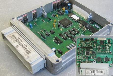

So my EEC-IV pluggable is good for the A4LD but not the later trannys. Fyi, I do have a later electronic case and its possible to migrate Frankentranny forward.
This all means would have to do an EEC-V + throttle, which was not planned, but I suppose it would make '94+ owners happy.

Factory EEC-IV versus my pluggable retrofit.

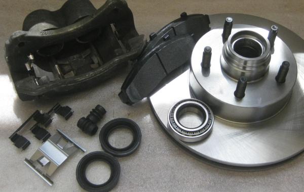

Explorer brakes. Rebuild kit, fresh rotor, fresh inner bearing. Hawk LTS pads.
Edit: Not in the pic, the new outer bearing. And oops, forgot to procure the inner seal.

The Aero knuckles came in and the spindle sleave and bracket steel are inbound.
