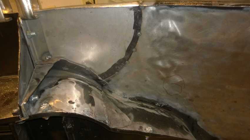

Fatfenders, Sorry the small spools of 0.023 Easy Grind wire is no longer available, you'll have to buy an 11# (8") spool. Yes you will save on grinding consumables and over heating warpage, as well as inadvertent thinning the surrounding softer parent metal, and bondo. The EG can be metal finished to invisible if you are so inclined. I first learned of the EG wire from Ron Covel, it is what he uses.

Patch welding with 0.023 EG wire using tack method, second pass. Note low profile of tacks:
Rear of same patch. Note full penetration of each tack:
