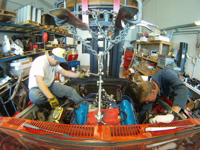

Last Sunday we got the new engine installed. There where some snags with the clutch and flywheel. Turns out the flywheel I found is for a 11" and my truck and new clutch kit is a 12", bolt patterns are different. To make a long story short we "Franken-Clutch" with the parts from the Craigs List flywheel and clutch and my new replacement clutch kit from Napa.
The engine is in and bolted to the bell housing and the perches but I still have to put everything else together before I can start it up.
A very special thanks go to HIO Silver and Old Style who stopped by and helped muscle the motor in place on a picture perfect Sunday. Thanks guys! You totally rock!
I had my GoPro camera taped to the windsheild so I may render a time laps video but I'm still working on that.

It was a good way to spend a Sunday! All in all I'd say it went pretty smoothly. Kinda tight between the pilot alignment and the mount studs to the perches; as per normal. But friends and a little force was all it took!!!
Glad I was underneath and safe from the camera.... Well at least till the video comes out.

We appreciate the recognition Mike! That's what FTE is all about... Steve even wore his FTE duds under this coveralls.
Originally Posted by OldStyle
It was a good way to spend a Sunday! All in all I'd say it went pretty smoothly. Kinda tight between the pilot alignment and the mount studs to the perches; as per normal. But friends and a little force was all it took!!! Glad I was underneath and safe from the camera.... Well at least till the video comes out.
Yep, that little bugger was snapping away in time lapse mode. It'll be interesting for sure.
We had some head scratching moments (clutch!) but all it all it went relatively smooth. Though it looks like I'm sitting there, my leg and foot is keeping the engine aligned. We dang near all had a truckgasm when the engine mounts slid home! Wooohoooo!

It might look like HIO's just sitting there but he's a damm good wrench who was never idle....
