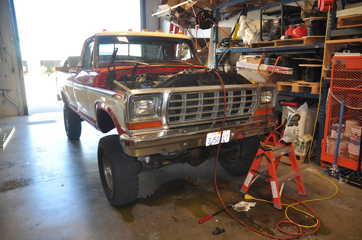

As promised guys and gals, Pictures!
The start of the day.
Power steering, AC, Alternator, Waster Pump and some other stuff removed.
This is where I was at lunchtime.
This was my only problem today. I could not get the vibration damper off. I used a big breaker bar with a jack handle and still no luck just to find out later that I didn't see the washer (As Old Style pointed out) because of all the gunk I couldn't see it. Once removed it was easy.
It wasn't easy to get that washer off my puller. Looks like I'll need a new washer.
Progress.
Cleaned up for the evening. Tomorrow I will need to drain the oil and then unbolt the motor mounts and bell housing. Which one do I unbolt first?
