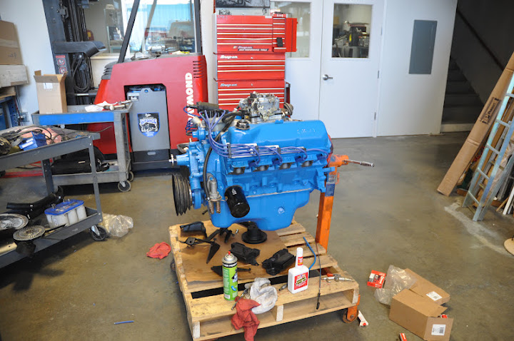

Lots of more detail work was accomplished today. I painted all the brackets and accessories and cleaned more parts. I dumped 4 quarts of oil to prime the engine before I install the distributor.

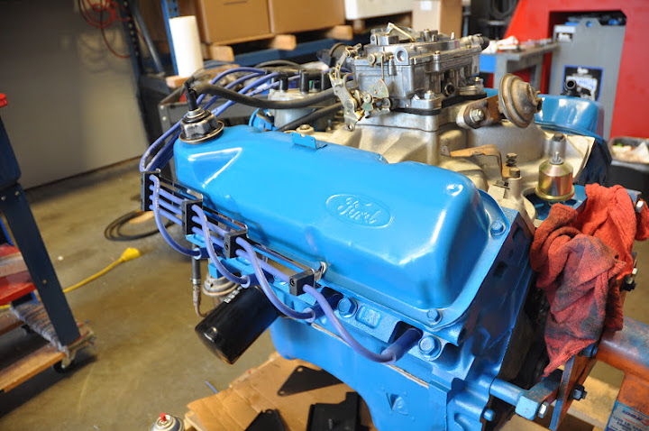

I started to install the distributor but I wasn't happy with the old spark plug wires and the layout so I at the last minute I ran over to the pats store and purchased new wires and a wire management system.
Its all eye candy baby!
I made my own cable manager.
Here is the hole that I plugged with a 1/2 freeze plug. It wasn't a tight fit, it just dropped into place without a lot of resistance so I sealed it up with lots of gasket sealer. Looking at the old block it looks like the same procedure was done by the factory. We'll see if this works.
Does anyone know which motor mount goes on what side?
Looks like a go for a Sunday installation! I have just a few things to do in the engine compartment so I will get an early start.

Who made the spark wire routing system? I like the way it looks too. Where'd ya get it?

Love that wire management system. Who makes it?
