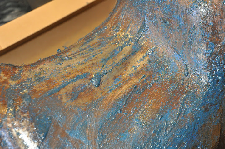

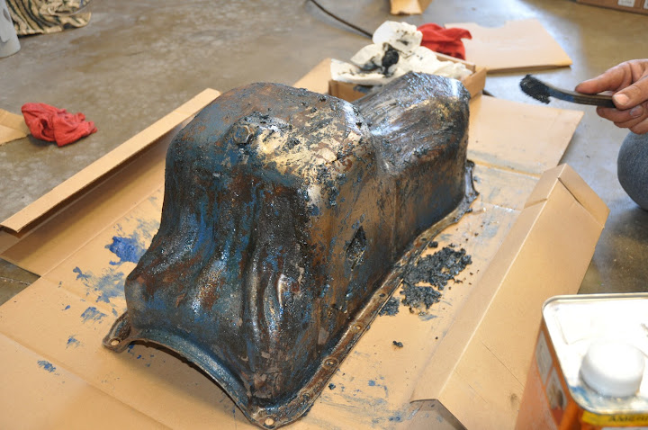

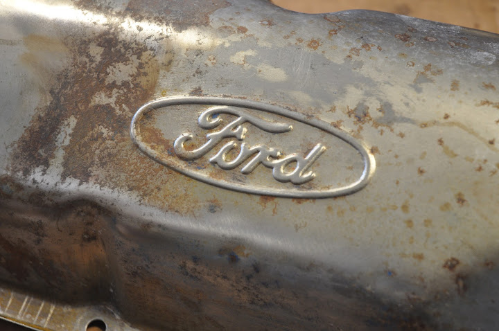

A productive weekend and a very special thanks to HIO Silver (to the rescue) for stopping by and helping with some of the detail work. Saturday we cleaned parts and HIO Silver stripped the paint off the valve covers and oil pan. Also we cleaned all the brackets and other accessories to ready them for paint. I started installing some of the engine components such as timing chain cover, water pump, oil pump, etc... During the week I'll start the painting of the engine and it's accessories.

Looking good! What did you use, I mean HIO use to strip the paint off of your valve covers and oil pan?
We used a paint remover made by Kleenstrip. Get it at your local Home Depot. It's real nasty stuff ....get it on your skin and it'll start stinging in no time flat. After wiping off most of the bubbled paint with paper towels, a quick rinse and any remnant paint removed with Roloc discs on die grinder.

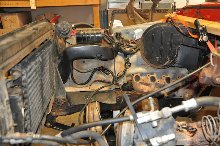

Today I'm at the shop most of the day. Here's my view from my window.
