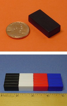

You can alawys remove the cover and drop a few metal shavings to see if they do indeed stick to the wall where the magnets are. I was thinking about the long style magnets more like a rectangle so they would cover more area on the cover. You could have one on each side of the cover. something like this one.
