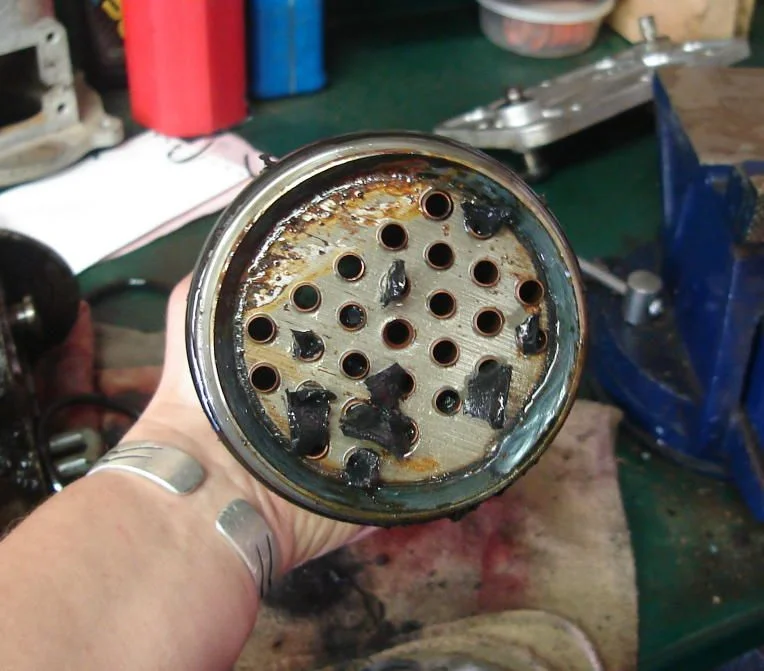

Never mind about the other comments I just saw the inside of one of these coolers and if its a tube leak I think its pretty much trashed.
That said it may very well be a oil cooler head gasket leak by.
pic
This head could leak across from the two ports shown. Or its internal.
