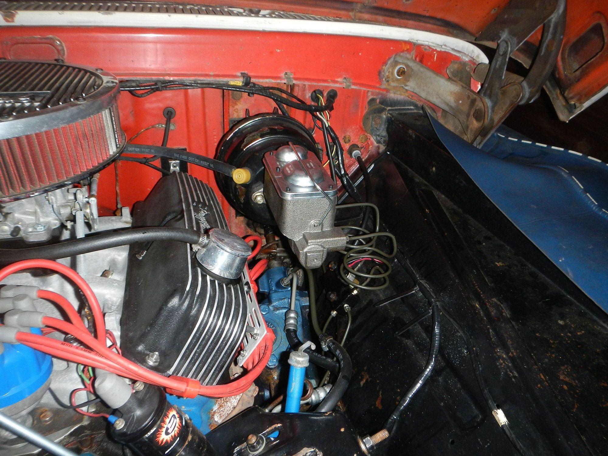

Also have a 68 f250
I also have a 68 f250. I have these same valve covers (Edelbrock 4162) that just arrived in the mail but wondering if they’ll actually clear the brake booster?

The standard height covers will fit all the heads that use the shaft rocker assy. The tall ones are for the mid/tall heads with adjustable rockers on individual studs. For the tall ones clearing the booster. I have a 8" dual diaphragm booster, it's close but does work. Not sure about the factory booster.
