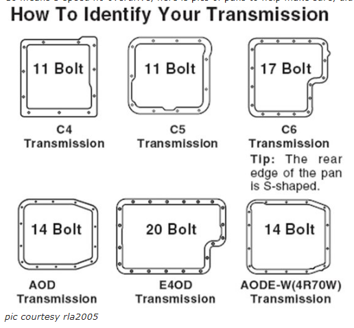

Originally Posted by IDIDieselJohn
Look at your gear selector.
P R N (D) 2 1 - E4OD (1992+ will have OD cancel switch on column shifter) (1989-1991, OD cancel switch on dash, right side of steering column)
P R N (D) D 1 - AOD
P R N D 2 1 - C6
Or you can count the pan bolts.
17 pan bolts - C6
14 pan bolts - AOD
20 pan bolts - E4OD
Forewarning, this is my first post on here so I apologize for bad formatting or other culture informalities. My truck is a 1995 F-150 XLT 2wd with the 5.0L Windsor motor. Now, my instrument cluster says PRND21 but my pan has 14 bolts and an arm for a tv cable to attach on the driver’s side of the transmission, and I thought mine was an AOD.

Originally Posted by tjc transport
your truck is also 30+ years old now.
unless you bought it new, the trans or shift indicator in the dash very well could have been changed.
I found out the trans is an AOD swapped from an older ford. I’m looking for a TV cable for it now but am coming up short. Trying in the Lokar area. Do you know of any cable that works for this swap?
