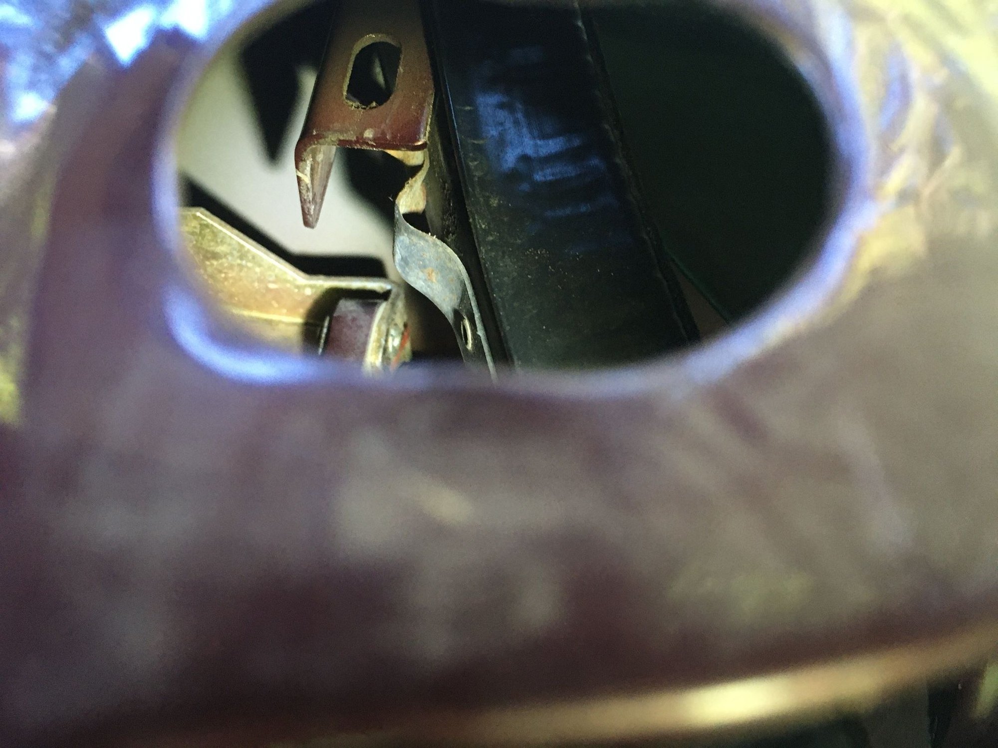

This reply refers to post Originally Posted by alwayschooseford
Much thanks for posting this. I was about ready to give up and take the truck to a shop. This problem started after replacing the door lock actuator. I followed some instructions about removing the bolt that holds the window guide and moving it out of the way with a bungee cord. Your solution was the only one I could find that made sense, most others recommended replacing the whole window mechanism.
I used a screwdriver to help open the clip and get it back in place where it belongs. When I replaced the passenger side door lock actuator, I was careful to not pull on the window guide so much. The clip stayed in place and the passenger door job went a heck-ov-a-lot easier.
View of driver side window guide and notorious "clip"
Closeup of clip and you can see that it is out of place. Needs to be behind that right-angle bracket.
