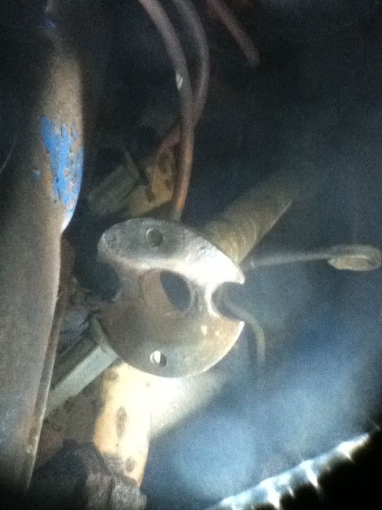

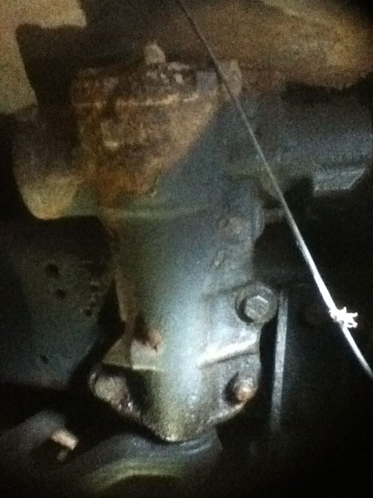

I know you say no rag joint used in 1966 4wd but the power steering someone added looks like the rag joint pictures I've seen. Here is a pic of the steering box and shaft couldn't get a good one (not enough light) of the other end

1976 was the first year that F100/250 4WD's used a rag joint.
1976/79 F100/250 4WD & 1979 F350 4WD: The lower steering shaft and coupler is a one piece assembly, the rag joint bolts to its flange, then connects to the input shaft of the steering gearbox.
1966 F100 4WD, 1967/75 F100/250 4WD: The lower steering shaft and coupler is composed of myriad parts including a u-joint.
The lower steering shaft and coupler connects to the input shaft of the steering gearbox with a clamp and thru bolt.
Here's a pic for 1976/77 F100/250 4WD with A/T. The rag joint is 3A525 .. The one piece lower steering shaft and coupler is 3B676.
There are other pics with M/T and for 1978/79 with A/T & M/T .. but will be similar to this pic.
