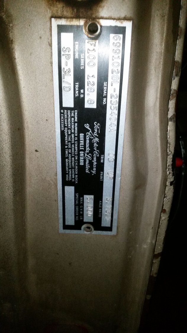

I need to decode my Canadian Vin Thank you

1965 F100 2WD
This Canadian plate does not decode to a 1966 F100 4WD .. It decodes to a 1965 F100 2WD
1966 F100 4WD uses the same cab, styleside beds and wheelbases as 1965/66 F100/250 2WD
Plus, the 1966 Canadian VIN; Warranty Plate and codes stamped thereon are the same as US trucks.
1965: See pic of parts catalog example of 1965 Canadian Warranty/Rating Plate (below).
6 = 6 Cylinder Engine.
99 = Styleside Pickup.
10 = 100 Series.
28 = 128.8" wheelbase (commonly referred to as 129").
L = Left Hand Drive.
235,004 = 1965 Numerical Sequence of Assembly, the trucks specific serial number.
A = 3,600-5,600 lbs. Gross Vehicle Weight Rating.
03 = Medium Green Crush Vinyl & Medium Green Wicker Pattern Vinyl; 81A Standard Cab.
UP: U = Honey Gold / P = Champagne Beige.
F100 2WD with 128.8" wheelbase. 5,000 lbs. Gross Vehicle Weight Rating.
Ford 9" rear axle / 3.73-1 / 3,300 lbs. rear axle capacity.
SP = 240 1V I-6.
3L/D = 3 Speed Manual Transmission.
Plus, the 1966 Canadian VIN; Warranty Plate and codes stamped thereon are the same as US trucks. 1965: See pic of Canadian parts catalog example (below).
10 = 100 Series.
SP = 240 1V I-6.
Here's some.pics
It has a 4 speed what looks to be a 300 and a dana 24 transfer case as well as what I think is a dana 44

Whatever it has...does not match the 1965 Canadian only VIN and codes on the plate.
1965/74 F100/350: There's no way to tell a 240 from a 300 by looking at it, as the block, bore and casting numbers are the same.
The only way to determine the engine size is to measure the stroke.
1965/74 F100/350: There's no way to tell a 240 from a 300 as the blocks and casting numbers are the same. The only way to determine the engine size is to measure the stroke.
Lucky enough I have the paper's and all numbers everywhere else match there is some pretty bad metal work done on it to incorporate 4x4 like this
as you can see someone likely cut out this hole with a saw of some sorts and left a weird hole that does not match the rubber cover as well as the blur cover there doesn't actually have holes to bolt it down to anything. It was vi'ed in 2014 and passed so everything is legit
