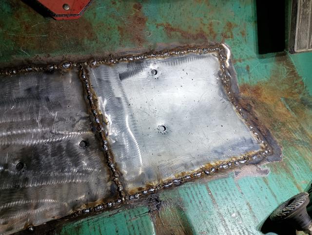

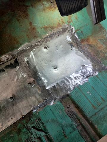

So I did have some time to work on the floor patch on the 66. Its actually going ok only slow and its no where going to be perfect. The smaller wire (.025 inch dia) seems to be working well. The new welding hood: I can see out of! In fact I had to take the cheaters out of the hood and it was clear!
So I did get this tacked in place:

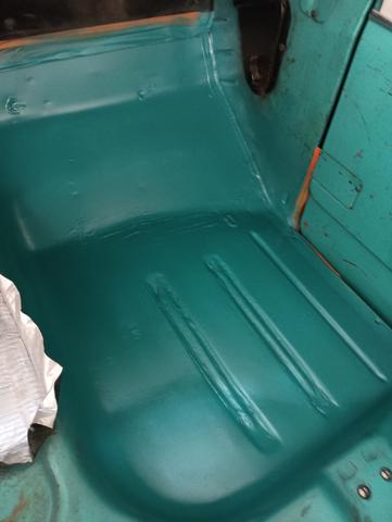

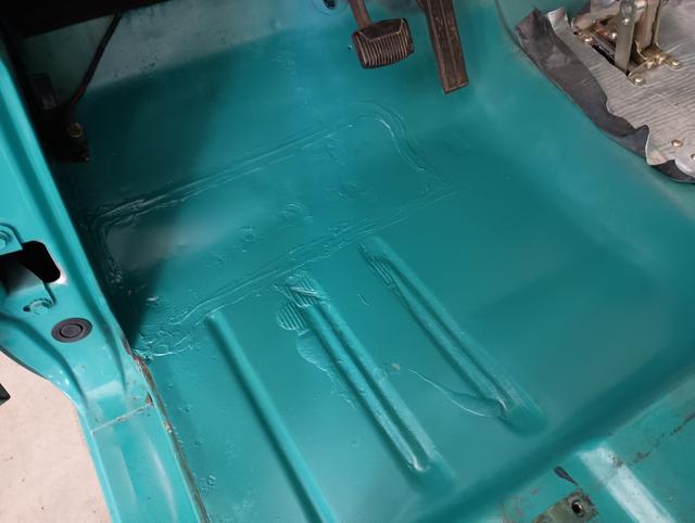

So I had some time this afternoon to look at the 66 floor patch again. Sorry I have drug this out some. I have spot welded about 75% of it. I did not get any grinding done.
Its going to be ok. Yes a little rougher than I would like but it is testing the old man and his skills! Using the cut and butt method for the seam.

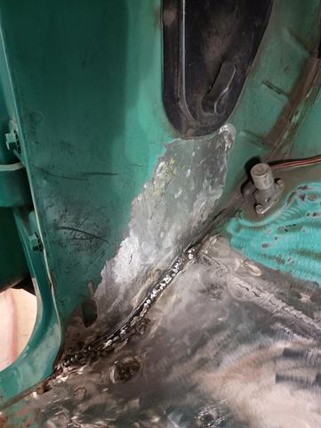

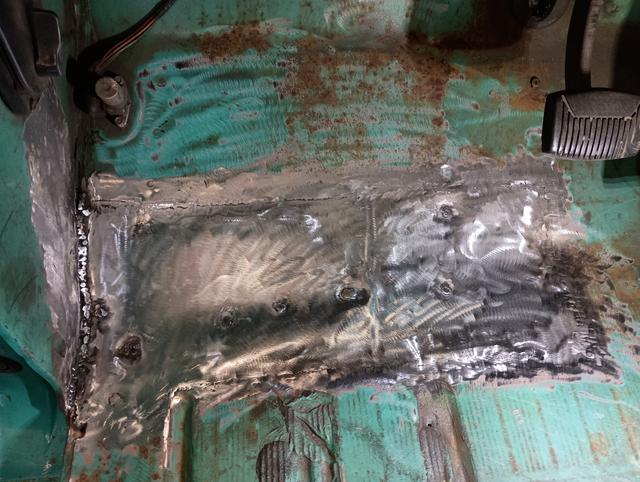

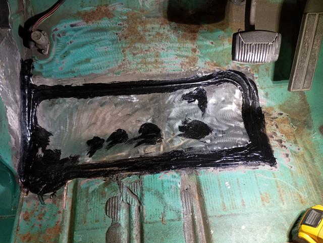

I did get a chance to do a little on the floor repair.
After grinding the welds fairly smooth I added seam sealer in and under cab repair areas.

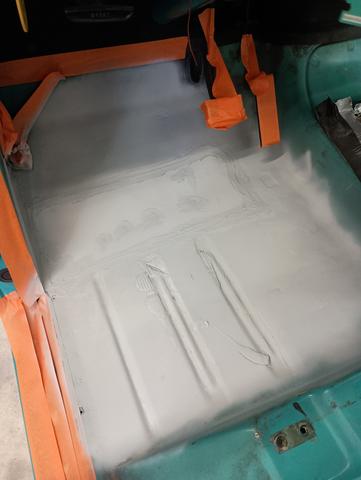

Then some primer

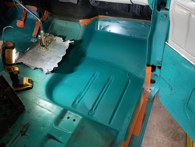

Rattle can top coat
Cleaned up the passengers side and added seam sealer as needed

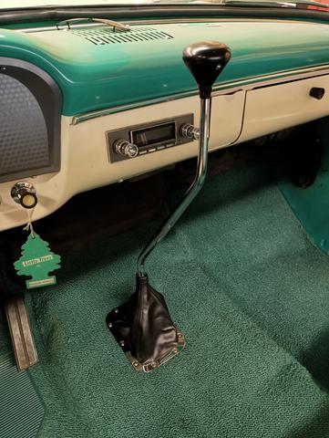

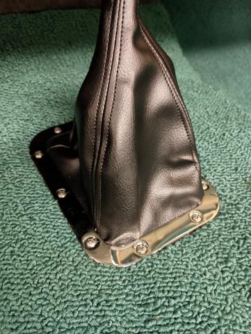

Installed the original rubber mat and the carpet and the shifter boot.
The Lokar shifter will be fine. and a safety improvement for sure! Thanks guys for alerting me to the original dangers.

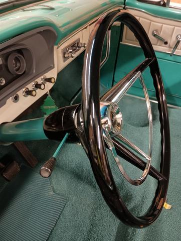

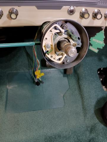

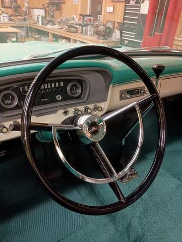

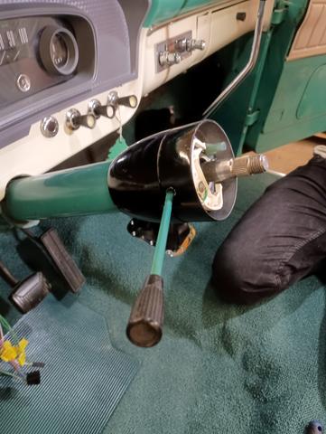

Next was the steering column improvements. I tried to wire the new turn signal to same wire locations. But have something messed up. So have to start re checking that.
Lost the horn spring contact. Ordered two from Carpenter. This is what it should look like when done. That should be ok for an old shop truck?
