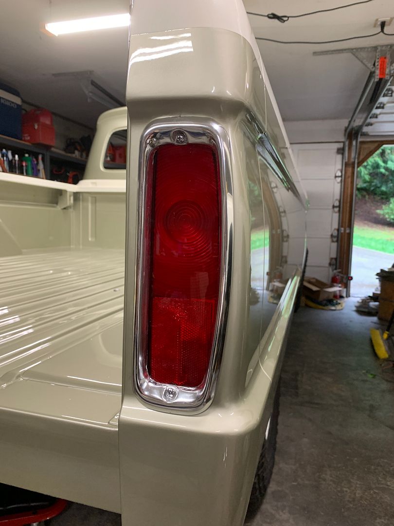

WOW!! thats a straight side panel. you do the paint work there Chad?

Thanks Rusty. I can't take credit for the paint. I did do some of the bodywork ahead of time but much of the work was done by my buddy of about 57-58 years named Jon Byers. Some people misspell his first name as John. Here's an example. I have an older t-shirt with this 1941 car on it. It was Jon's shop car for several years, but he eventually sold it. Jon closed his shop after about 35 years and now works at Griots headquarters.
