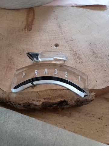

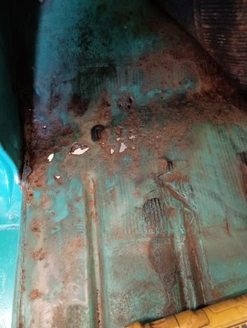

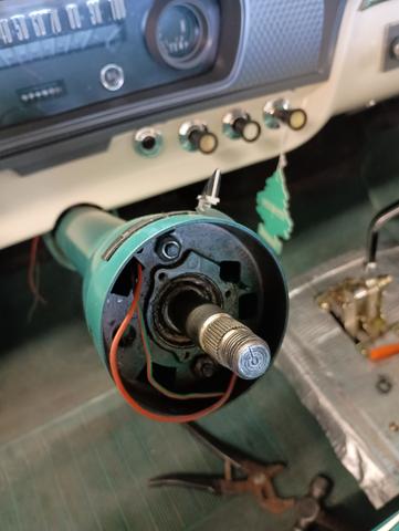

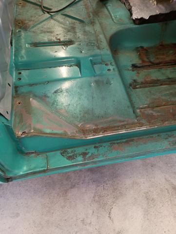

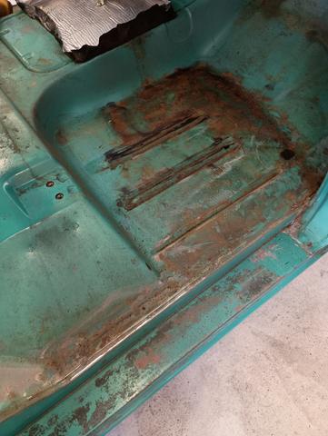

Cheryl and I took the 66 for 20 mile trip for ice cream last night. The shifter worked fine. A very good upgrade. Thanks Chad and others. I feel better about that. So in the mean time I pulled up the old vinyl floor mat and found some rust that I new was there. The plan on that is to get it repaired now while the cab is open. I think I have the items to complete that patch. The passengers side just needed wire brushed and it will be able to be coated. May use some rust inhibitor on those surface rust areas too.
Did this surprise me? Not really. I have seen much worse. I am not a metal man but I will attempt this rust repair.
Passenger side should clean up just fine for a shop truck. Should I be thinking of sound deadening material on the floor?

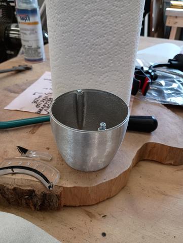

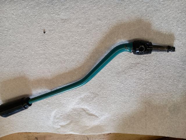

The old shift lever removed
And the indicators
New smooth collar needs sanding and finish work. # 6 screws

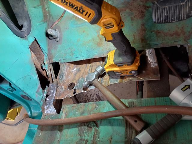

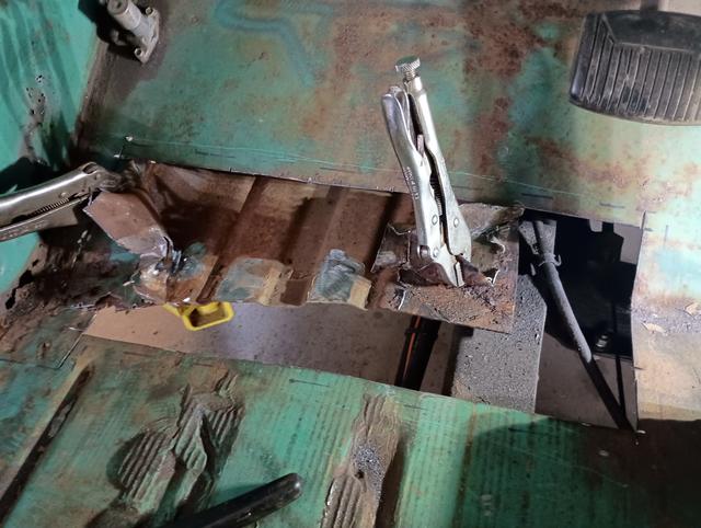

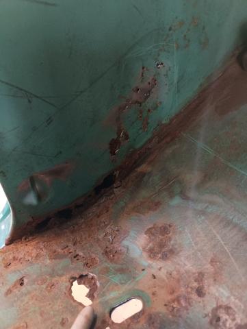

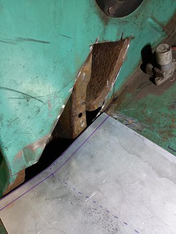

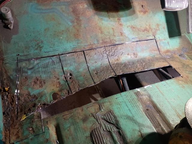

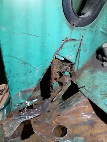

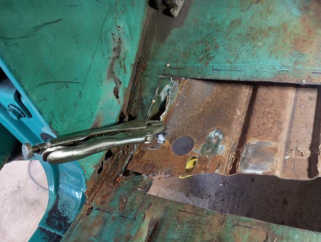

So the following is pretty ugly! But it is the reality on some of these trucks. I cut out some areas that had thin spots that were not completely thru but were not good.
On the 66 cab rust in the drivers floor. Once you start its always worse than it looks. So I cut most of the bad out. I found that the area in the fender had been full of grass and dirt. That's why the side panel had rusted out also.

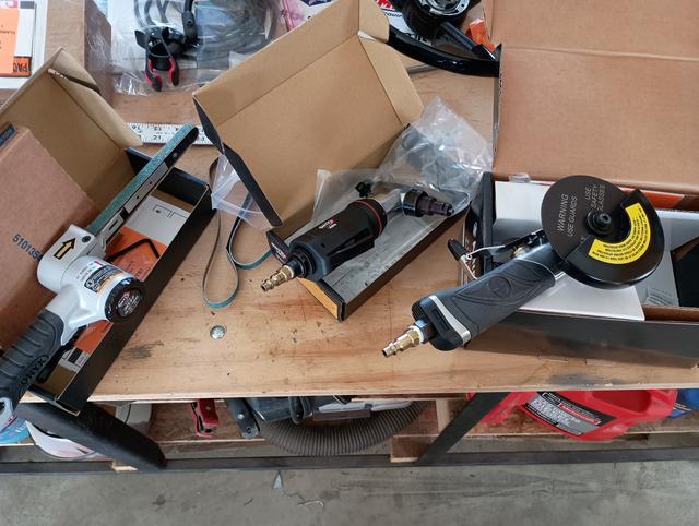

Picked up some tools to help with the metal work
Getting tools into these areas not easy
Whittled at this on and off today
So we will attempt to put in some good solid patches.

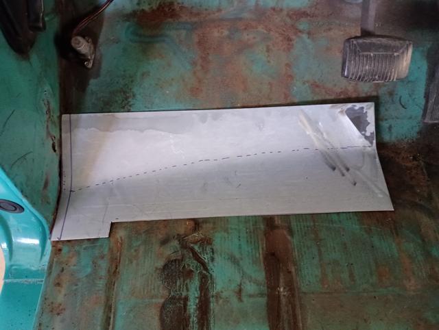

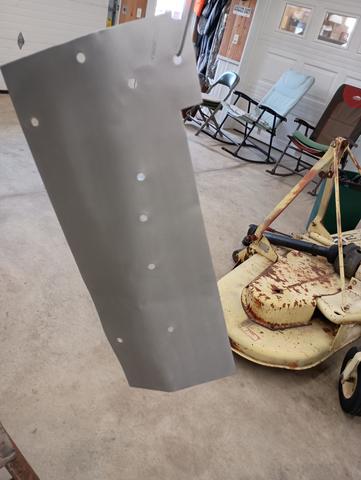

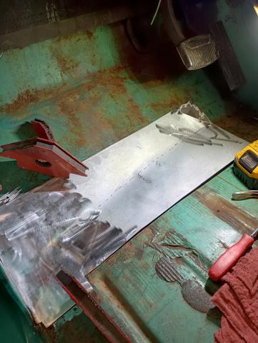

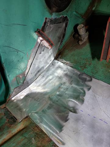

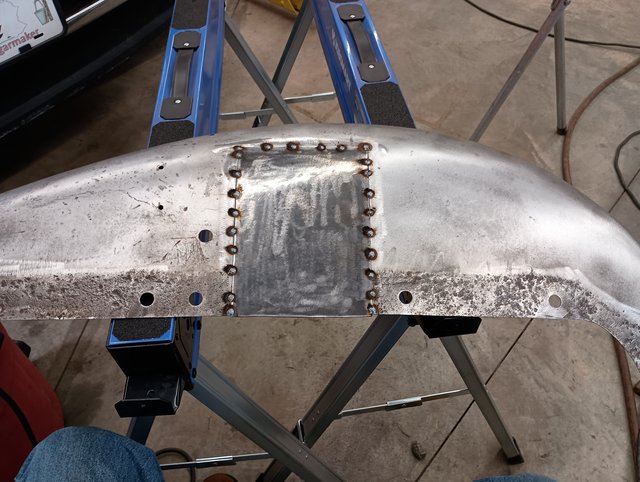

Thanks for the continued support on the 66. So I had a couple hours to play with sheet metal this afternoon. Getting a little closer to filling the gaping holes in the drivers floor and up into the air vent area too. I do plan to drill holes to spot weld these patches to the structure also.
The compound curve in the floor is going to require some thinking. I don't have a lot of metal shaping tools.

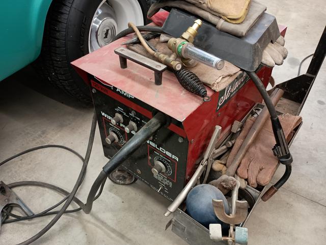

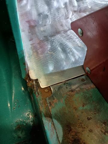

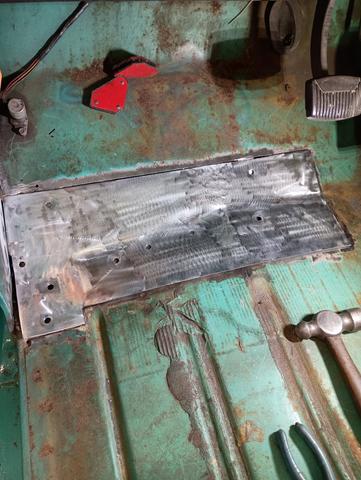

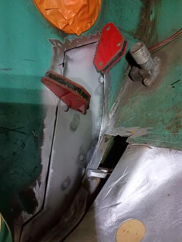

The body work on the 66 cab floor did not go well today. Not surprising. Old man. old welder, old hood, old truck.......

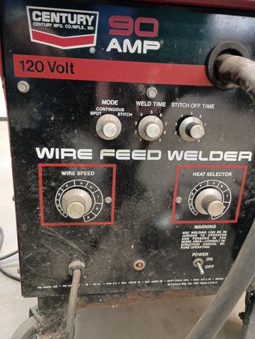

So I am going to get some more air for the MIG that could have been part of the issue. It doesn't make good welds if the air supply is out or low! Maybe look at a new Mig? This old used one has issues with the wire feed control?? New hood, the auto darkening is just not working. Maybe drop down to .024 wire? Using the .034 or .036 dia?? That may or may not help as I have used this wire size on a lot of other repairs in similar material,
The new panel fit up is going ok. I have welded a bunch of sheet metal together with this welder. Just a perfect storm today I think. This side panel is not very easy to get at and to get in position to weld easily. I knew that would be a tough area for sure.
I applied some weld through high zinc paint to the underside of the panels.

What kind of welder?
I would for sure drop down in wire size for sheet metal
Gotta have gas, co2/argon mix
Most helmets have a small battery that need replaced after a few years....jeez, those things are terrific!
Looks like you are making nice panels, just need to get the welder on the same team.

The welder is a antique that was a off brand purchased by Lincoln, maybe 30 years old. It has lots of settings and features but has always seemed sensitive. Yea the gas was low, or out? Tank is in the other truck ready to go for exchange tomorrow. This helmet is a solar unit and doesn't owe me anything. So a new one may be in order. I have cheaters in it to be able to see better. When welding it just stayed dark for like 15 seconds very annoying. I don't think it has batteries? Will take it for review or new?
Thanks on the panels. Yes its not like I haven't welded things together. Of course when trying to do a better than average job the systems malfunction. Will get back on this tomorrow. I have tried 024 wire but its been a long time. I will keep you guys up to date on the rust repair on the 66.

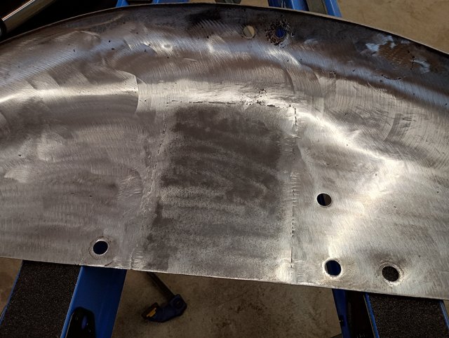

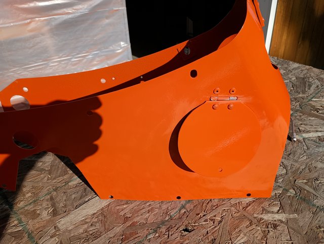

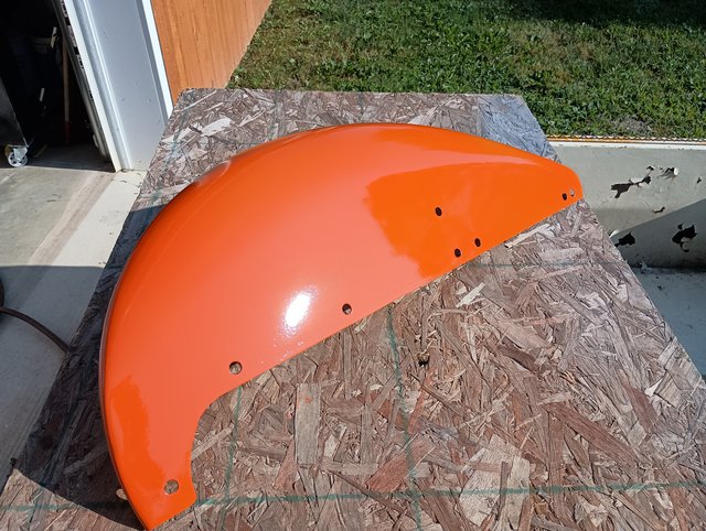

Off in the weeds! Here are some other projects I have put together (Allis Chalmers 1951 CA tractor):

I am going to get some .024 ish wire, tank of gas, check hood function and or new. Will look gently at the old Century welder in the area of wire feed controller. But I don't plan to be able to actually fix that issue with the wire speed. Cleaning with compressed air and or maybe a visual inspection inside that area is about my limits.

I am going to take the old Century welder in for service. I did not buy a new one yet. Just like our trucks we try to improve and keep this old stuff working!
