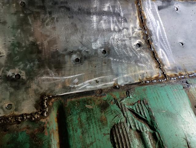

So I did have some time to work on the floor patch on the 66. Its actually going ok only slow and its no where going to be perfect. The smaller wire (.025 inch dia) seems to be working well. The new welding hood: I can see out of! In fact I had to take the cheaters out of the hood and it was clear!
So I did get this tacked in place:

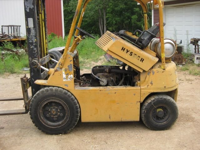

Good to hear its going well! I see you have an old forklift on the job site, every growing boy should have a forklift! I'm a Hyster man

I saved the old Allis fork lift from the scrap pile. It runs but smokes bad. I converted from Propane to pump gas.

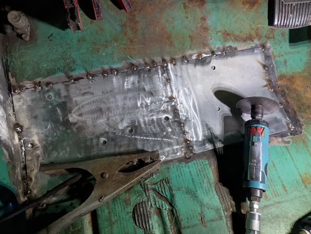

So I had some time this afternoon to look at the 66 floor patch again. Sorry I have drug this out some. I have spot welded about 75% of it. I did not get any grinding done.
Its going to be ok. Yes a little rougher than I would like but it is testing the old man and his skills! Using the cut and butt method for the seam.

I did get a chance to do a little on the floor repair.
After grinding the welds fairly smooth I added seam sealer in and under cab repair areas.
Then some primer
Rattle can top coat
Cleaned up the passengers side and added seam sealer as needed
Installed the original rubber mat and the carpet and the shifter boot.
