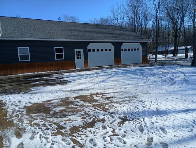

Oh yeah picture of the shop:

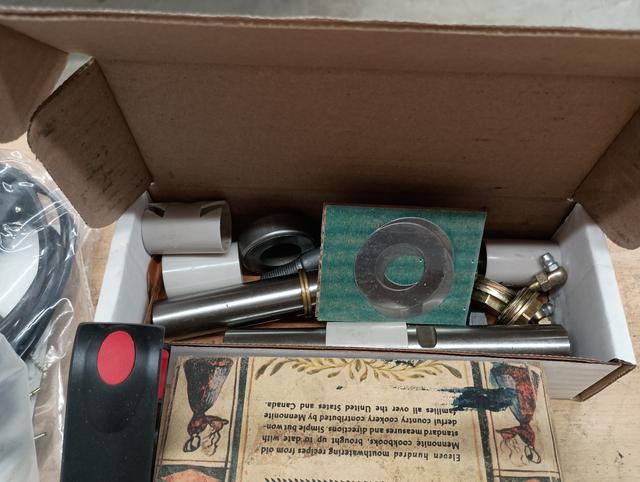

The king pin kit Moog parts:

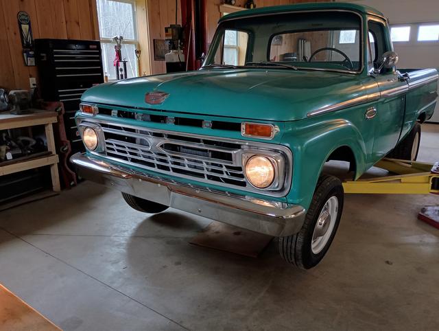

I kind of like the baseball cap white cab look. Could be a option if I ever get started on the drip rail clean up.

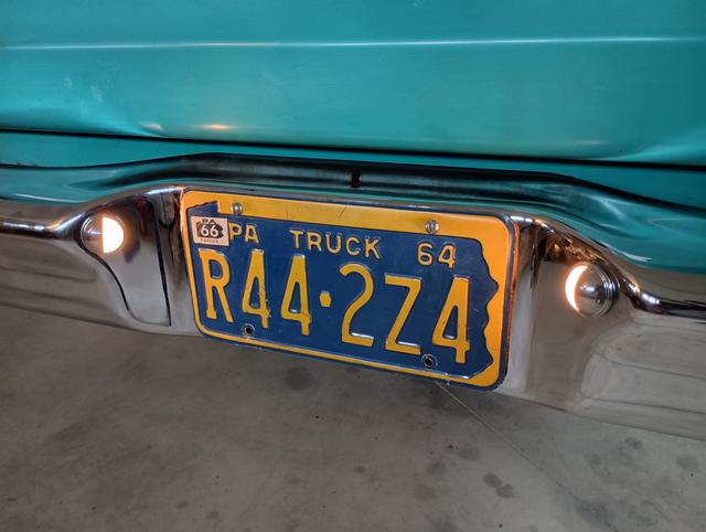

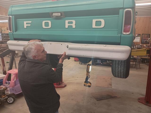

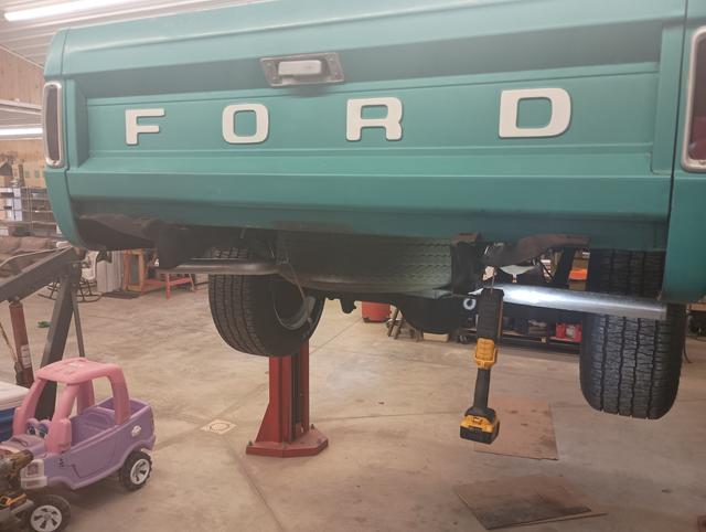

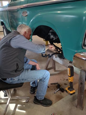

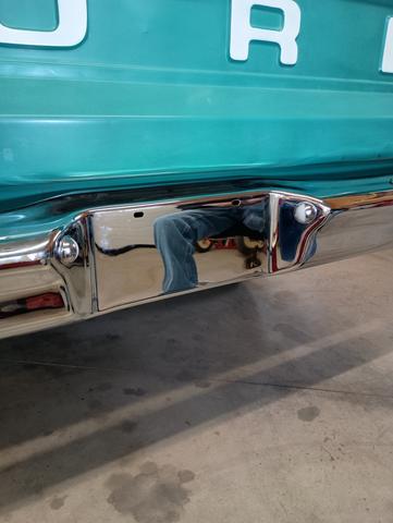

John and I tag teamed the rear bumper. The bolts were snug for sure.
Sorry phone lens was dirty. The pink and purple short bed is the oldest great grand daughters truck.
John Kelley and the 66

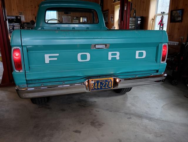

Lights in place
vintage plate and light check all around: Everything functions as it should.
Old wiring was fine with some clean up. Some new ends for the lights from NAPA and some stainless bolts for the plate. Maybe they were gold plated. Yikes stuff is pricey!
Me and the crusty old Ford:

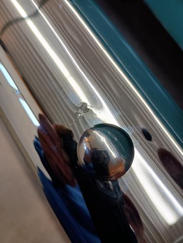

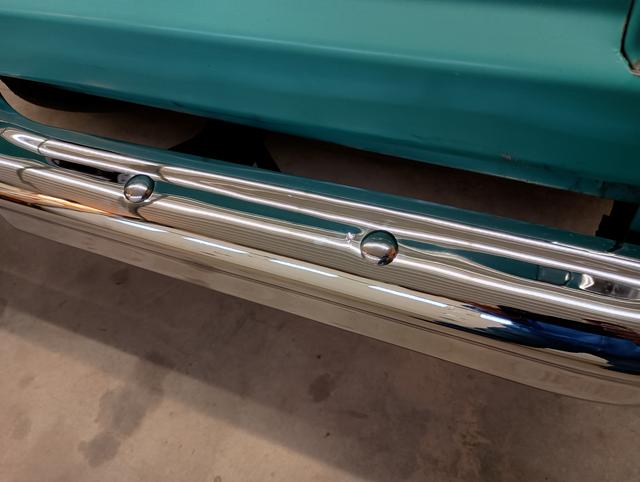

Last thing was to just wipe the fingerprints off. I found a spot near a bumper bolt where the chrome was popped up and pealing. I called Summit, they have another bumper on the way today. So nice to get good customer service! Awesome! It wont take as long to exchange the new one.

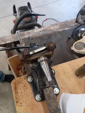

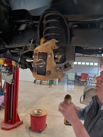

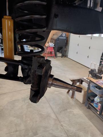

Day one with the kingpin project on the 66. John was getting right after it!
Found it was going to be better to remove the caliper disc assembly and the plate.

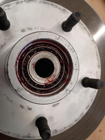

The right pin was stuck, rusted into the axle. So we applied some heat and placed a support under the axle. Several Sharp hammer blows and the pin began to move.

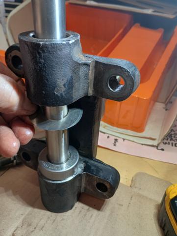

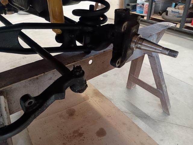

The new bearing was about a .001 press fit on the axle. Used a Dremel to clean up the bore. Fits nice on the spindle now.
Spindle clean up, installed new bushings,
Questions: The shims would they go on the bottom or the top?
Also there is a tiny seal (have 2) in the kit, Where do they go?

Guys,
So I did not get any instructions with the kingpin kit. So I called Summit for info but no help on the installation. They tried. They even called Moog tech support. Moog was on holiday, good for them.
Happy Easter!

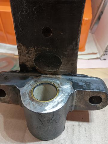

So I am going to take a run at how to place the ring seal and the new bearing.
Ring seal set into lower spindle area. My thoughts here would be it might keep moisture or dirt from entering the lower bearing area??

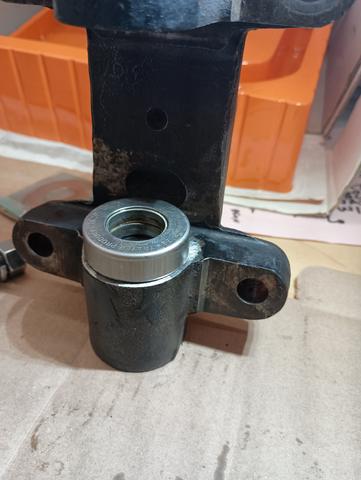

Then the new bearing would set on the spindle surface
Then the two shims would go on top of the spindle when assembled??
Going to try to get the passengers side assembled today.

I believe shims go below the bearing and are 'as required'.

If the seal is placed there will grease push up and into the bearing?

The seals Moog provides are interesting. They were not part of the originals as far as I've seen. Here's a NOS kit although I stole the shims out of this for another project there are not the 2 seals Moog provides. There are 4 O-rings but those go on the threaded side of each of the spindle plugs.
I'm wondering how your kingpin won't knock the seal out like you have it. Maybe you have the bushings installed already? If those are the nylons bushings I get it, I think. Still not sure how they go since ford didn't use those - like I say as far as I've seen so far.

Well I probably wont tear it apart but they are on the top. Maybe could have used maybe another 1/2 thickness shim to remove all the vertical slop These were about .008 thick.
Old Apr 3, 2026 | 08:09 PM
  #75
Effies 56's Avatar
Effies 56
Joined: Nov 2016
Posts: 887
Likes: 237
From: NWPA
Great observation now that it is assembled maybe wrong?? I do appreciate the response and support.. So if its in the wrong place where is the right place?? Maybe in the upper under side to keep grease from leaking out??
These new bearings are not like to old ones. They are very flat grease would go up through the center along the kingpin . Make more sense after thinking about it. Humm maybe these will have to come apart and change that seal to the upper portion of the spindle pivot.
By the way we usually have to do things a couple times to get projects correct. Not unusual at all for a couple old men.
Yes this kit has the nylon bushings.
