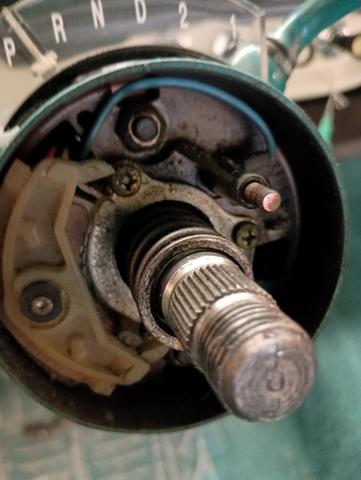

On the steering wheel fine threads. I need to check and find bolts to fit. I did use the bolts supplied in the JEGS kit to get the old steering wheel off. Yikes could have messed something up.

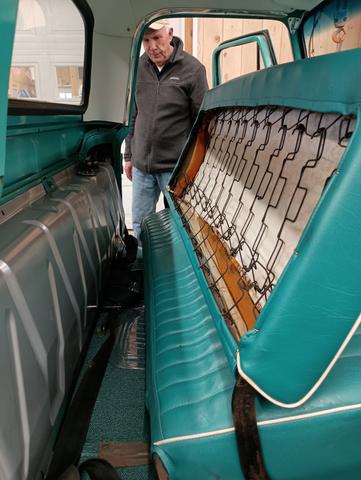

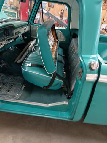

I got the Comet (lil red) started finally, seems to be carb and or gas, Maybe old gas? Drove it down to local upholstery shop and brought owner back to look at the 66 seat and options for improvements. Dave of Daves upholstery noted that the seat was very soft and not providing support and height. He felt an improvement in the seat base foam may help me feel more comfortable. So John came up and we took the seat assembly out and dropped it off at the upholstery shop.
I did get the Ford center plastic piece moved over the the repro wheel horn ring.

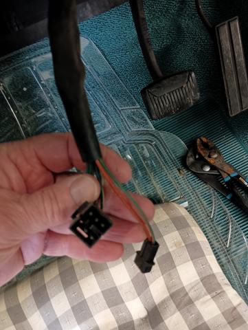

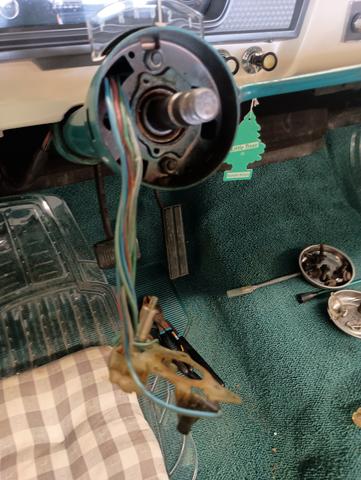

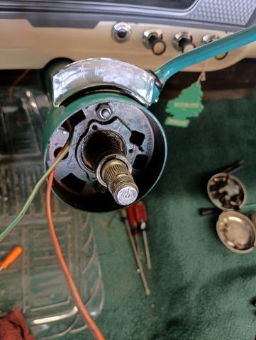

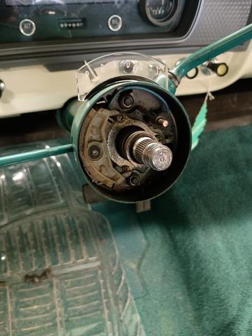

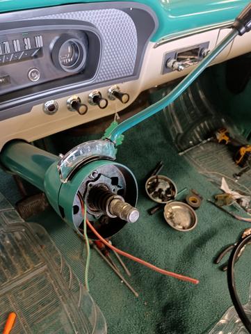

Steering pictures: The horn switch is broken. The wire is broken.

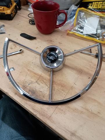

The original steering wheel would have been turquoise, are you planning on trying to do a color match or will you leave the new wheel black?

I am thinking of spending another hundred and getting adhesive promotor, correct primer and spray can with hardener in a color match for the wheel. At least that's the plan today.

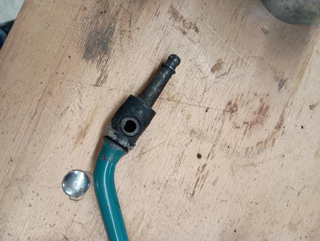

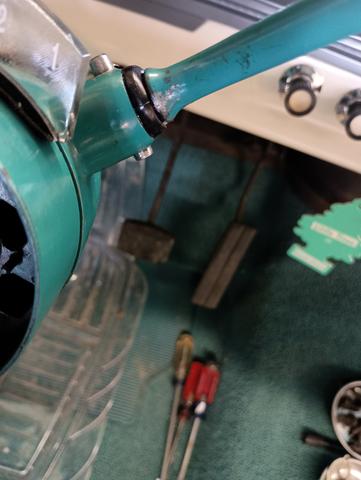

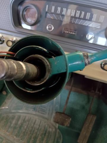

Found out the steering shifter housing was not the correct one. So I just rebuilt the old one. Strange bolts that grip the turn signal portion the the cone. Like blind headed square bolts??

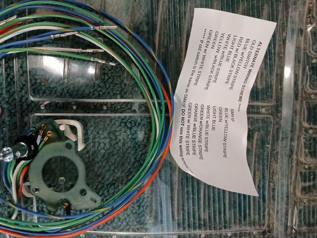

Any way back together up to that point. I have to pull the wires for the turn signal. Which they are mostly different color wires going to different places. Have to look at that some more too.
So I repaired the shifter with a new rubber bushing then drilled out the column cone to accept the spring pin. It went together ok added some fresh grease to the upper bearing.
Next to review the wire colors and positions. Maybe the positions don't matter but my guess is that they could turn the wrong signal on??

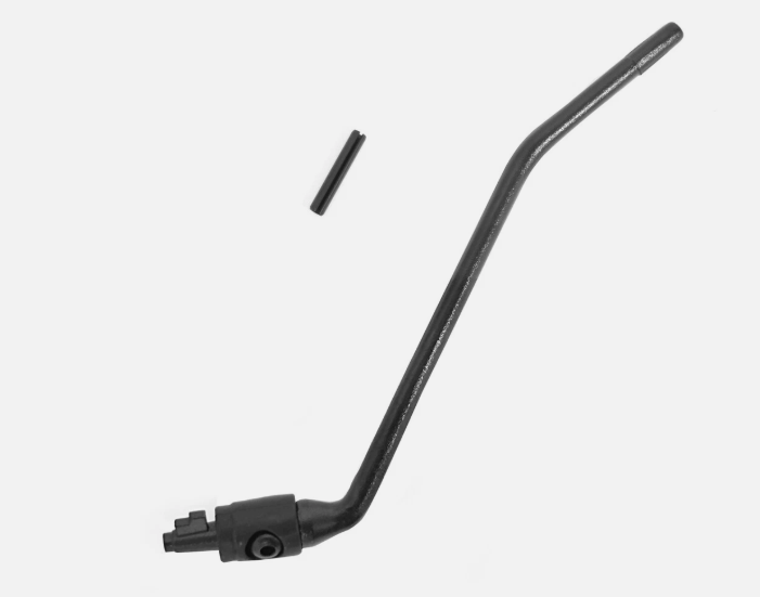

Chris, your shift arm is for a 3 on the tree manual column not an automatic column - same with that housing. The lever interacts with the detent which keeps the transmission in Park. Your setup isn't designed to be used with the detent and no way it would stay in Park that I can see. The stair step on the lower end of the arm goes into the slots in the detent. That's part of what holds it in Park and the various positions.

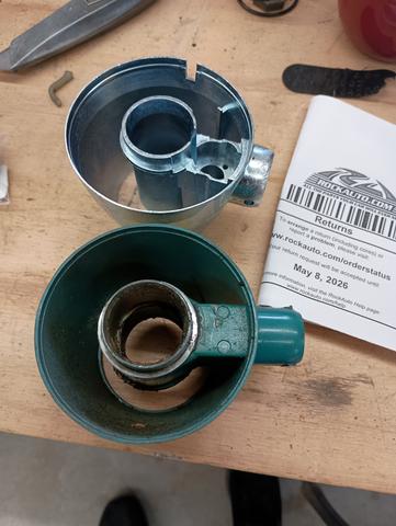

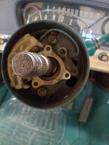

I might be confused, (happens often and usually I embrace it), but...it looks like the new collar you bought is for an automatic, but maybe it doesn't work with your steering column, and then maybe you don't have the correct shift arm either.
All that said, I know I have seen a lot of good folks change out the whole column for a retro style that also tilts. I have seen it done nicely when the column and wheel match the original color, so maybe that might be an option worth looking into before you paint the steering wheel and then later need to paint the column too. If I am following what Chad wrote, that too would solve the problems of not having a proper "lock into park" automatic column.

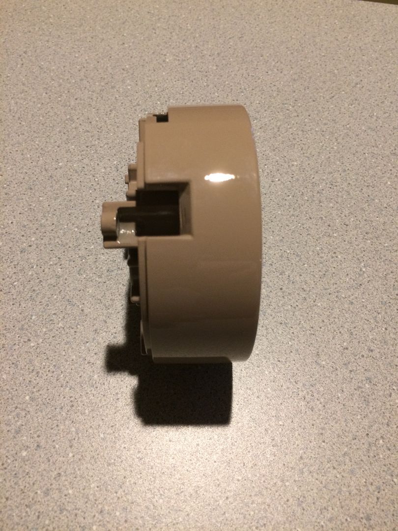

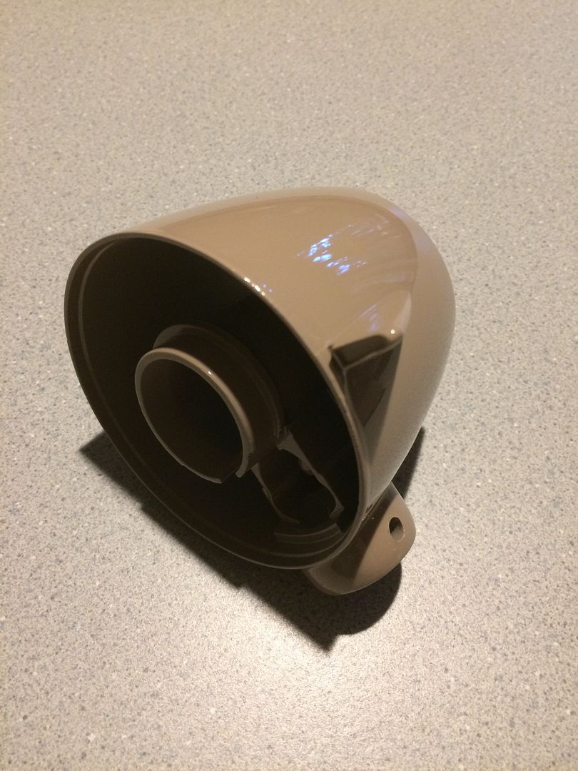

I agree the new collar is for an automatic. Smaller detail but it's from a newer 70's truck design and not the original 'shark-fin' socket - but instead uses the removeable pointer.
2MonkeyBoys has a reproduction of the original style - probably a non-issue for Chris but if anyone is doing a close to original project maybe it matters.
1964-1966 64-66 F-100 F-250 shift collar Automatic Shift Sleeve Auto | eBay

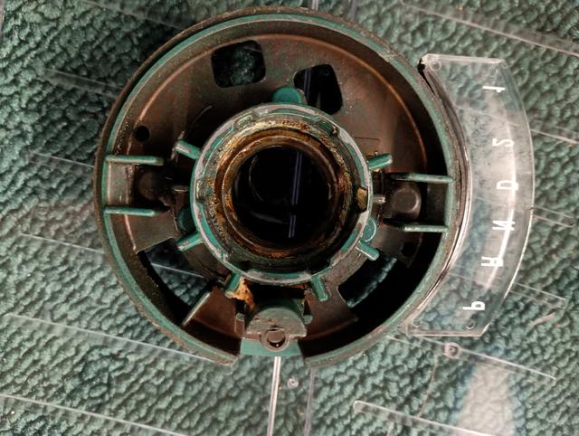

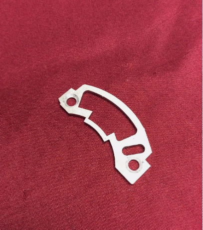

The flange on the automatic trucks is also different. Not the best picture as this is looking at the turn signal lever area but up on top there are 2 holes for the selector dial legs to fit into. One of those holes is visible on the top edge.

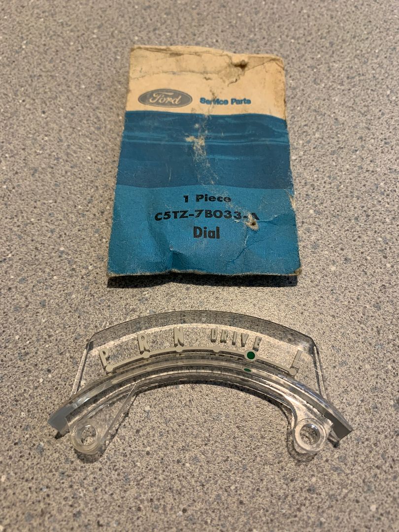

This is the correct green dot dial. Chris's is an example of a newer style also. I suspect it is glued to the outside of the flange collar.
