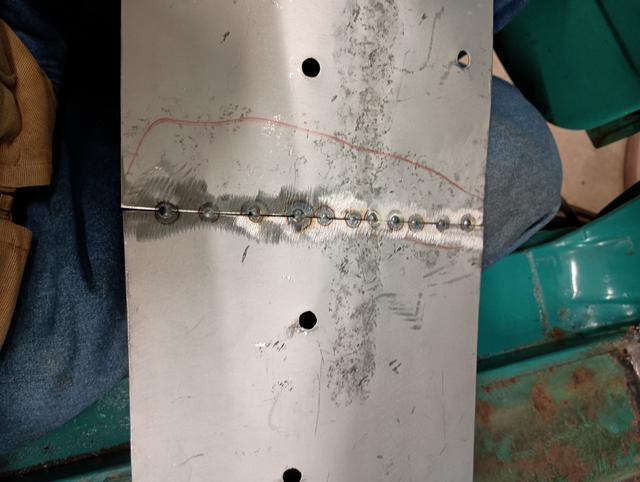

Thanks for the inputs on the welding. I just did not have good position on this vertical interior vent side panel. On the bottom floor repair I finally just cut it in half and ground the cut seam to fit back and lay in the truck better.

Looks good. Now you will move around to spread the heat in fill it all in?

Yes that's the plan. Get this seam completed then fit the panel and tack it in place for cutting around it and then butt welding it into the floor pan. I thought it had pretty good penetration.

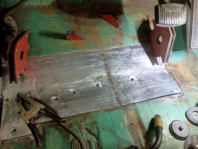

My welding leaves a whole lot to be disired. Kept burning holes in the joint. What a mess. Not sure if I am going to use that splice patch or not? Will keep trying to improve. Going to try to turn the heat down. This welder only has 4 or 5 heat settings. Have not had this much trouble and have welded a lot of old stuff together. with the old Century unit. Could be the operator? Cheryl was fussing at me the whole time. That did not help

If you can access the backside of your welds, try using copper spoons made from flattened copper plumbing pipe as a heat sink. I find it helps immensely. You can also bend to fit the shape you need. Additionally, stick a wooden dowel in one end before flattening, for a handle. I have a small collection of various pieces of copper of different thicknesses and shapes.

This backing plate is a good idea. I am going to try to make some copper backers with handles. also gave me an idea to put a steel backing strip in the upper portion of this floor repair. Might help a lot? Thanks for the ideas and support. Cheryl is not good and it's taking two of us to care for her at times. So the 66 waits.

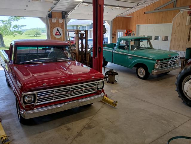

Also had a friend stop in with his 69 F100 shorty. Took it for a ride. The 400 is fresh and very strong. Its a good driver. Like our 66 needs a little love. I would drive it and was thinking of buying it before the 66. I would let it set in the shop too!

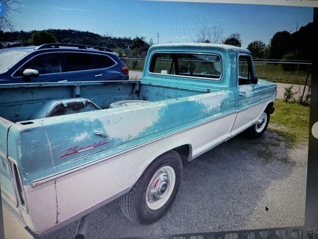

Also seen this pretty nice original 67 on line. I would drive it too. Too many trucks not enough time!

A thin, like 1/8 piece of brass will also work for a backer, and a good magnet will hold it thru the brass.

Did a little bit of welding on the patch panel seam. I was nowhere near happy, So just cut it apart and will make a new patch and try it again. I did tack in a support inside the cab mount area.
I made a call to the welder repair guy. The old Century is ready to come home but no real issues were found. So will pick that up and some .023,4 or 5 wire. Then try to go slow and get this floor repaired!
