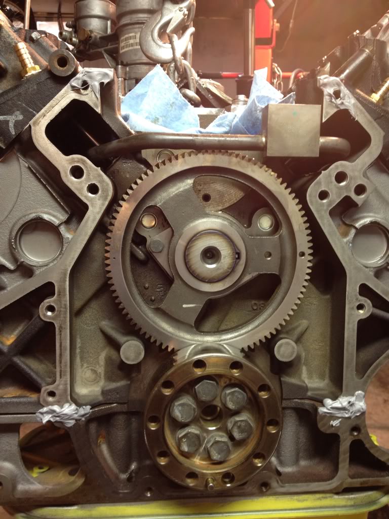

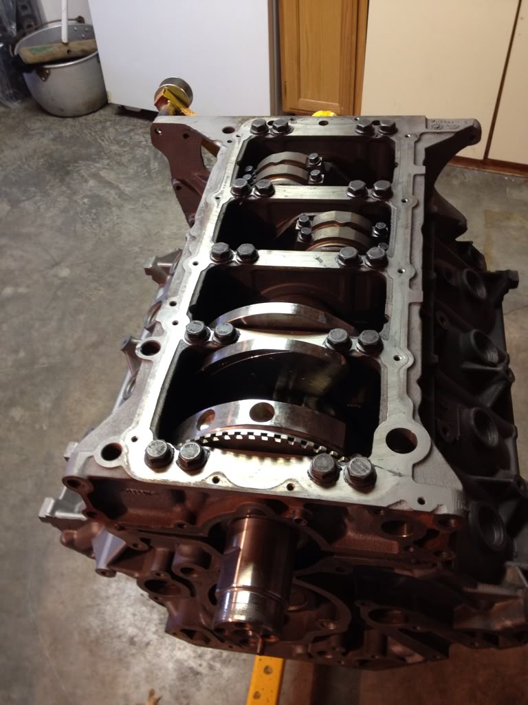

Are you sure the bolt fell BEHIND the last part of the block?? I say this because if it fell in one of the holes that are in front of the gears,,, then removing the rear cover will not give access to the rotating assembly.

Here's a pic
Yes, because the pump was in place keeping the bolt from going that way and it was the bolt for the stc fitting.

Here is with the upper oil pan removed
