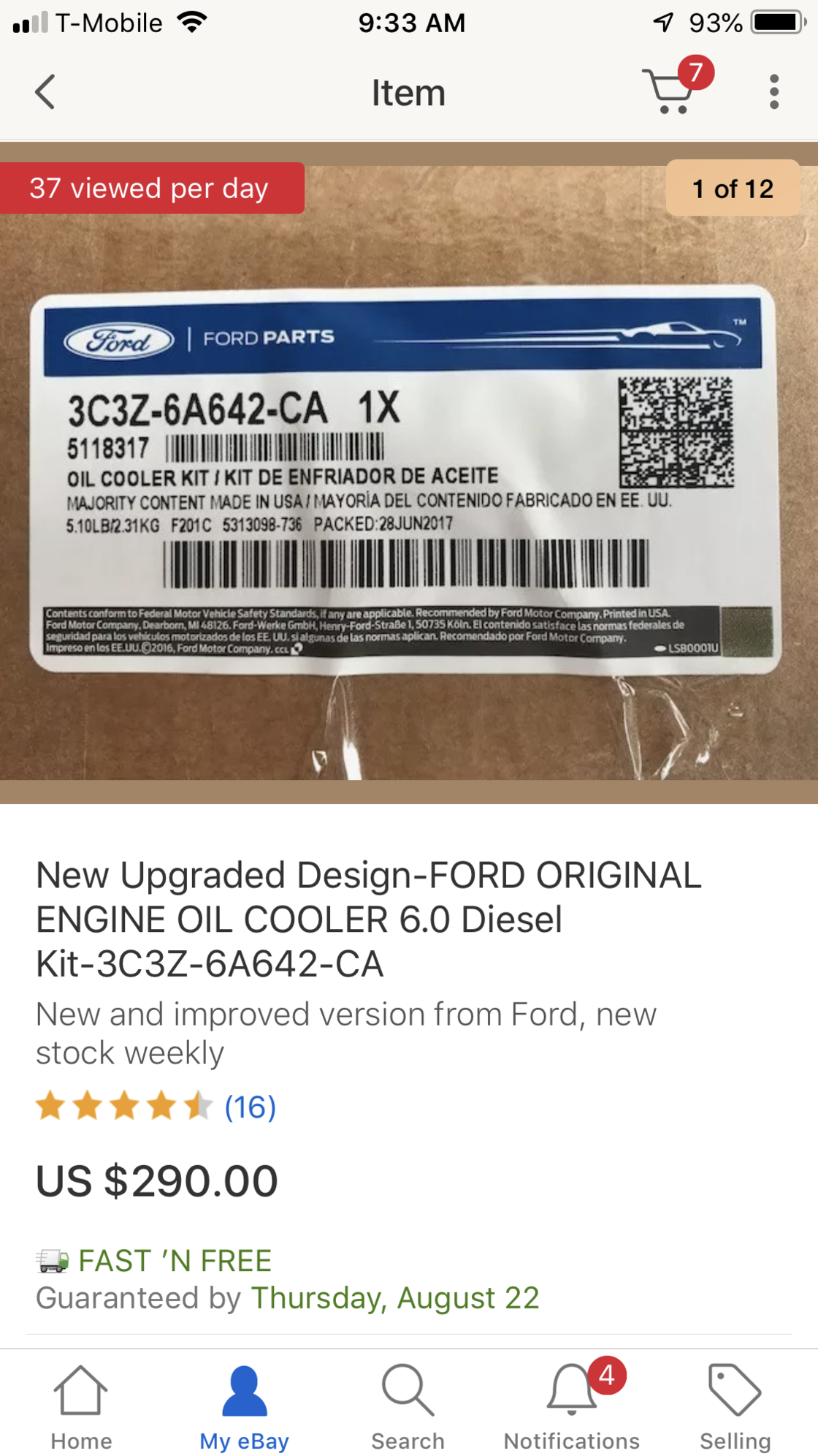

Yeah sorry I didn’t bid on it I bought it. Here is a screen shot of the cooler on eBay.

Not picture, the seller.

Here is one (of three) w/ essentially the same picture. One out of 16 feedback comments indicates the same issue.
https://www.ebay.com/itm/New-Design-FORD-ORIGINAL-ENGINE-OIL-COOLER-6-0-Diesel-Service-Kit-3C3Z-6A642-CA/202698595117?epid=1911116172&hash=item2f31c71b2d:g tcAAOSwoMlcX1YP#rwid
"Had it on my truck for a week on old oil cooler hottest EOT got was 230F after one week of having it on my truck my EOT got all the way up to 260F oil got so hot it ended up burning out a bearing in my motor complete junk do not recommend."
That is why we are being so careful!!!

Come on, every friggin picture of a Motorcraft oil cooler box is going to look the same.
But you can still have an issue with new dealer stock getting caught with debris. The very best example is when I worked with Karl long ago, but we've seen it with pre-flushing as well. I can't make that review a 100% issue pinpointing it as a bogus cooler.
The other guy has tons of Ford parts on eBay. Yep, he, like the first, can be shipping in offshore. However, I used to buy a lot of Motorcraft parts from a guy in CT who worked in the parts dept at a Ford dealership. I talked to him a lot, he was legit. Until his manager said no more. It may be real, it maybe not.
But agreed, without having detailed knowledge of the seller, I go to the Ford sources.
Yeah, I'm in a mood again today......
The point was really that ANY seller is FULLY capable of making the product look like a real OEM part. Many people are fooled by the "presentation" and the claims made in advertising. Nothing more than that. Without the 6.0L forums, who would know how bad a knock-off cooler might perform!
No doubt a clean system is critical, but so is buying the proper part. You stated that you need to know the seller. That is my simple point as well ....................... Even if you think that you know the seller, an individual (IMO anyway) is much more likely to be selling a knock-off under the guise of an OEM (knowingly or unknowingly) than a dealership or a well-known seller (like XDP).
No where did I say to avoid all Ebay purchases. That is a big stretch (IMO anyway) to infer that from my posts. I suppose others may think that that is what I was saying, but it wasn't. I also think that saying "I bid on something" is QUITE different from bidding on it - but as you said - "That is just me". Communication isn't always clear on the internet.
btw - My caution to "be careful" includes installation methods, as well as ensuring that the system is clean, as you have so appropriately mentioned!
