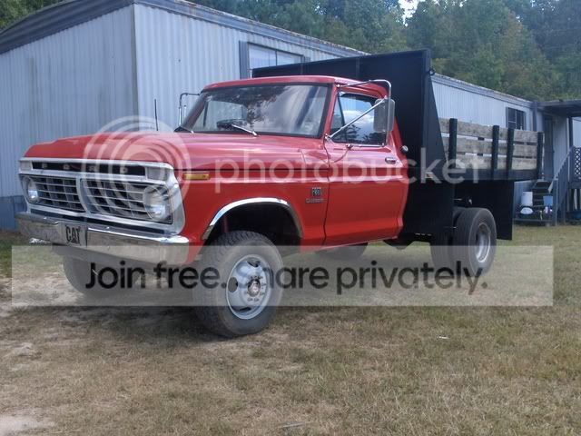

There is such a thing here is a picture of one:
This is an F-350, unsure of the front axle but its a 4x4 dually.

These are conversions, no Factory dentside dually 4x4.

There is no listing for a dually 4wd in my 79 Light Truck Facts book that Ford put out. I don't think there ever was a dually 4x4 prior to 79 built, only a 2wd version as far as I know.
The F-350 wasn't introduced till 79, this has a 77-earlier grill shell. Can you get the VIN# for this or the other truck? That would definetly clear things up. I'm guessing that both of these are home brewed.

There were no dually dentside 4x4 cab and chassis built by the factory. There were some aftermarket companys that did conversions but they were very expensive. Napco built a few and Marmon-Harrigton built several. There was a company that built add-on dually fenders for dentside styleside beds for a short time. They looked simular to early Dodge dually fenders. You see a pair for sale once and a while on Evil-bay.

Anybody know what that first picture reads under the F-250 emblem?

Looks like "Custom" to me

Yep it says Custom. I'm pretty sure the owner of that truck put that on there because I have never seen one like that before. I wonder if these trucks came from the factory with the in-cab gas tanks?
