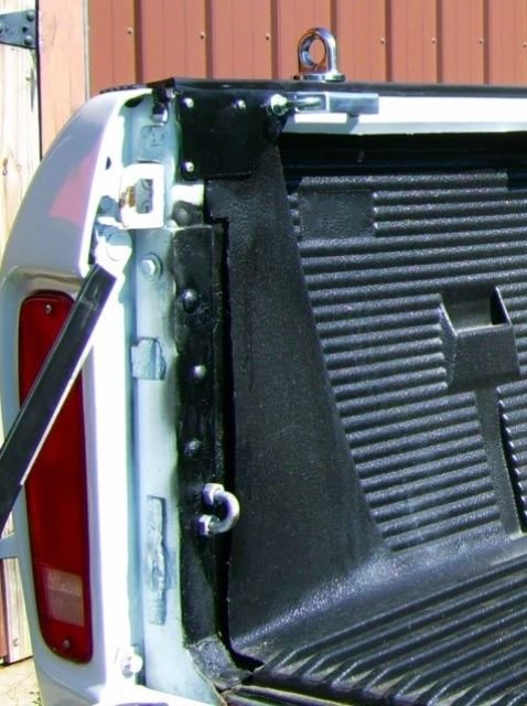

The aftermarket has tons of tie downs that can be mounted flush with the floor, or even off to the side. I went to the salvage yard and got some from an f150. These were small sheet metal cleats similar to what is used on a boat and bolt right to the corners of the bed. These provide a decent anchor point for reasonable loads, and because of where they are located stay out of the way, so things dont get hung up on them.
Notice we have a large square section on the rear of the bed where the tailgate hardware gets bolted to This is fairly thick material and provide a decent anchor point.
For the front, its pretty easy to find a reasonable location.
These anchor points just require a slightly longer rope or tie down. Keeps things clean too.
