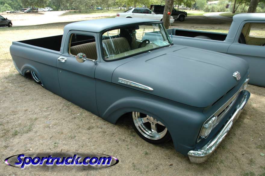

I think chop tops look good when the truck is lowered a lot. It stays proportional.
For example, check out this '61. It's chopped, but not by too much. The truck just looks sick.
I know this isn't everyone's cup of tea (slamming trucks isn't against my morals...), but I think this truck is pretty "slick!"

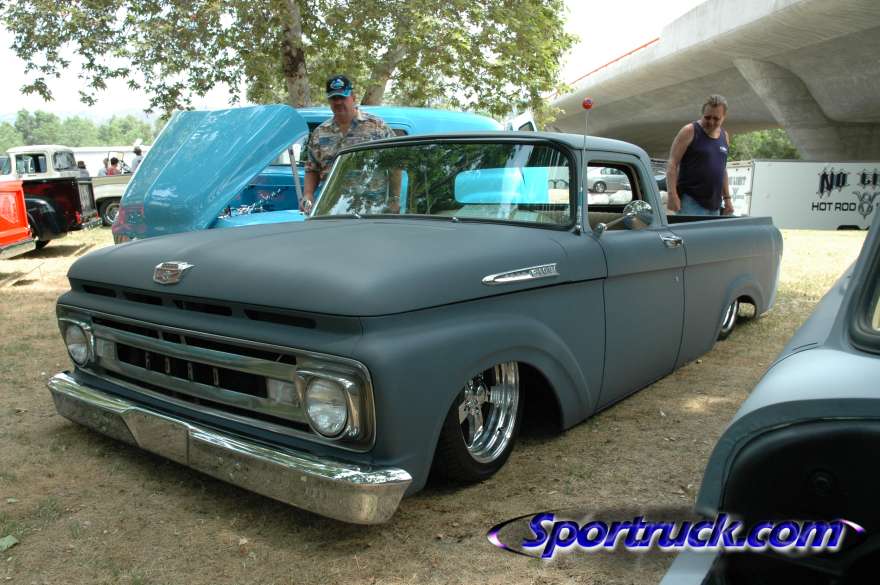

That roof is chopped enough to see that the side mirror is half the window opening. While it looks good from that angle, I'd be surprised to see what it looks like painted. Between the chop and drop it looks like the Uni's lost 12-14 inches.
Did anyone notice the wipers aren't installed and the antenna is on the wrong side? I now the other Uni has shaved door handles and the mirrors are not installed yet. Anyone know who built them?

The above trucks o/s mirrors.
The same type Ford used from 1953 thru 1966, reproduced by DC.
Fits into the slot in the door.
There were originally two versions of the mirrors, with different part numbers for each. My guess is that DC only sells the early version.
1) B5CZ-17696-A .. Early
2) C1TZ-17696-E .. Late
The antenna is on the wrong side, and it's a gypo (aftermarket replacement). It's not genuine Ford.
The original antenna mounts on the right side of the cowl panel (original: the base is all chrome, not black plastic-gypo like this one).
1961/66: It's the same one as the 1961/64 Galaxies used-reproduced by Dennis Carpenter: C3AZ-18813-C (C3AZ-C replaced C1AZ-A).
