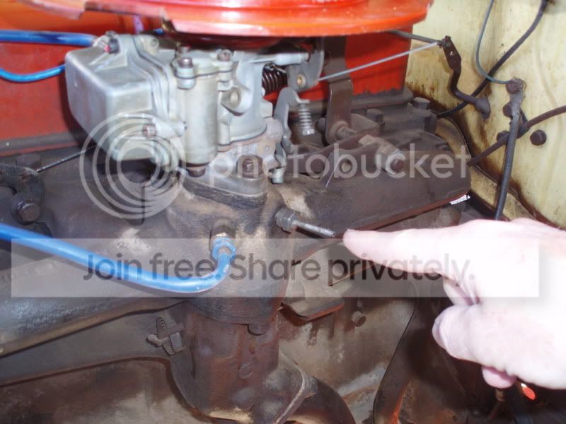

I have a 1960 F350 with a 223 and I'm working on getting it started. So I need help on identifying this little nipple that is right below the carb. I can get a vacuum reading from it when I crank the engine. But what's it to? My shop manual doesnt say anything about it.
Here is a picture of it:

Does your truck have, or did it every have, vacuum wipers? It looks like a vacuum port for the wipers.

yeah it has vaccum wipers, where would the port lead to? Would leaving a hose off that port cause any problems trying to start the engine?

I already have a line that goes from my fuel pump to the wipers though so I'm not sure what this port would be for.

It attaches to one side of the fuel pump at the top. The other side goes to the wipers. At least that's how mine was set up. I am switching to 12v wipers and capped it off.

That looks like direct manifold vacume,it's below the throttle plate.if your not using it for anything, by all means..cap it off. It would be a major vucume leak otherwise and make your engine run ,leaner, because it's sucking air. You need a richer mixture when cold, this open line will not help..I hope that helps.

thanks guys, yeah it seems to work better now that I've capped it.

My wipers run off that port, but my truck was converted to electic fuel pump by the po

Do you have a Vaccume Gauge in the Dash Panel?
If so, that what's supposed to be hooked up to it, as far as my book states.

I think it used to have a vacuum gauge, that would make sense i think. There is a random hose that leads into the cab that could maybe fit on that both.

That'll be it then.
