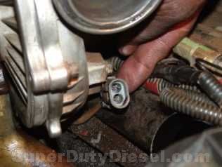

New to the PSD scene but I purchased a 97 F250 PSD and when i start it up it sounds like a wastegate is dumping. I cant take off driving it until it stops which is usually about 10 to 15 secs. but the issue I am haveing is that sometimes it doesnt make the noise and when i take off driving it will act like it is dumping the whole time. I was told that it was the turbo mount. I unplugged the exhaust back pressure sensor and the problem went away. is the sensor bad or is the turbo mount bad? And just curious will a 1999 and up turbo fit on my truck with my mount or do i have to use a different one?

Your turbo is fine. It was just the ebpv acting up. Most guys here unplug them for the same reason.

Same problems here, I can see the valve, but how and where do I disconnect it? is it an electrical, phnuematic, or mechanical disconnect I need to do?

Read this link: https://www.ford-trucks.com/forums/6...rbo-sound.html
